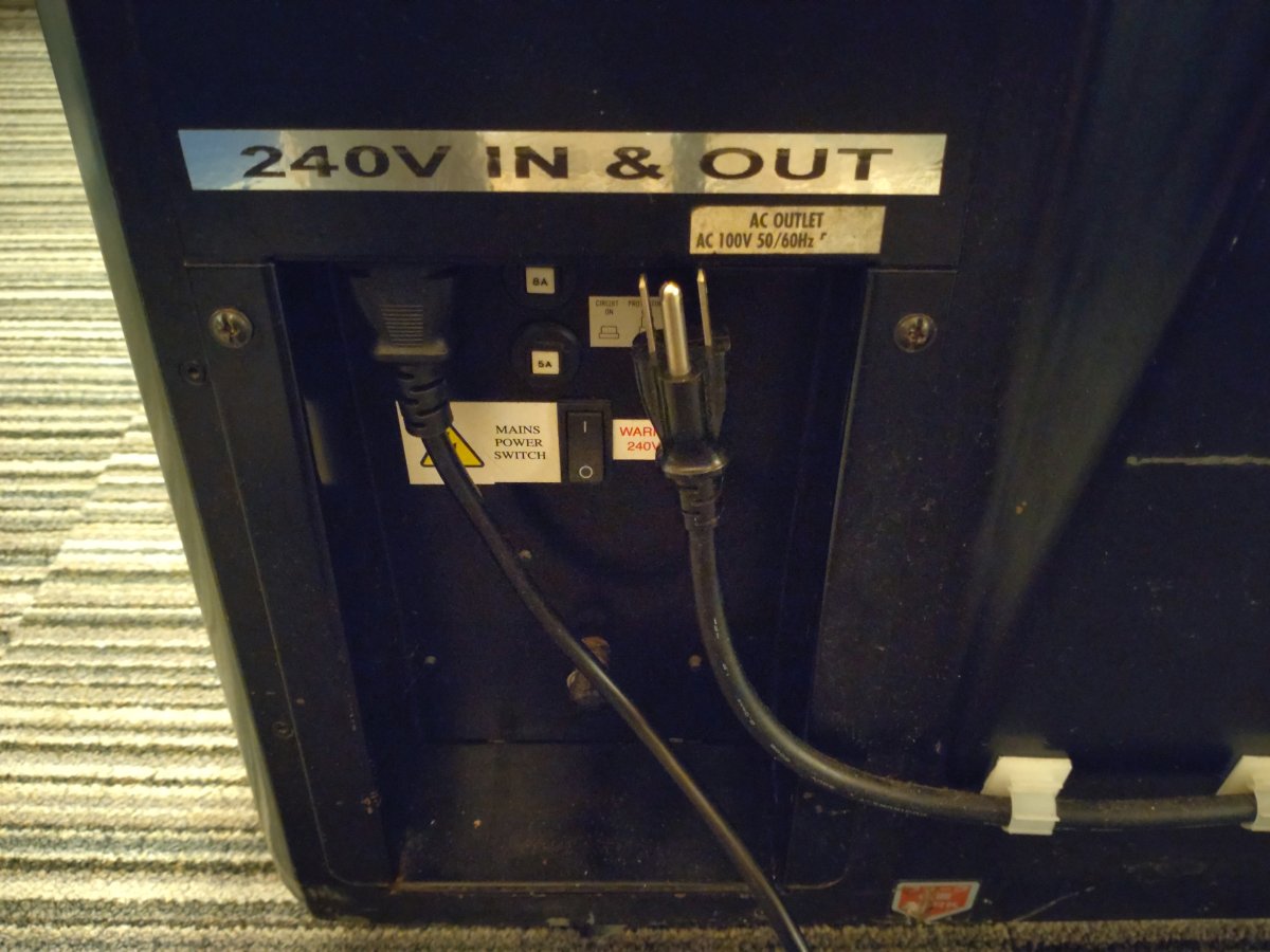

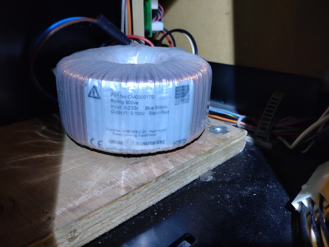

So you have two plugs to the wall? one for the 4 way extension and one from the cab for lights etc?
or did you wire that into the line filter, either way it looks pretty tidy inside.
I really want to find someone of those 1P 2P stickers :D

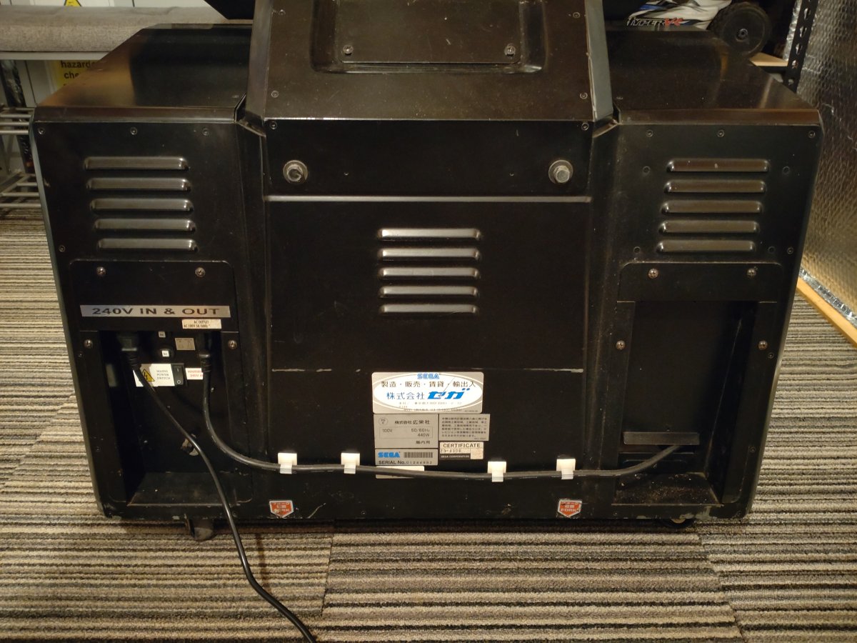

To make it easier for you I've taken a few pictures tonight the cab was chassis mount stepdown converted by the previous owner, the line filter had screw terminals so no wiring was cut.
Also as I don't like marquee holders I've added a cover made from a sheet of magnetic plastic to cover the hole at the back & keep out dirt ect I'm also missing a monitor cover cap.

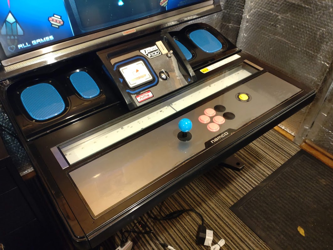

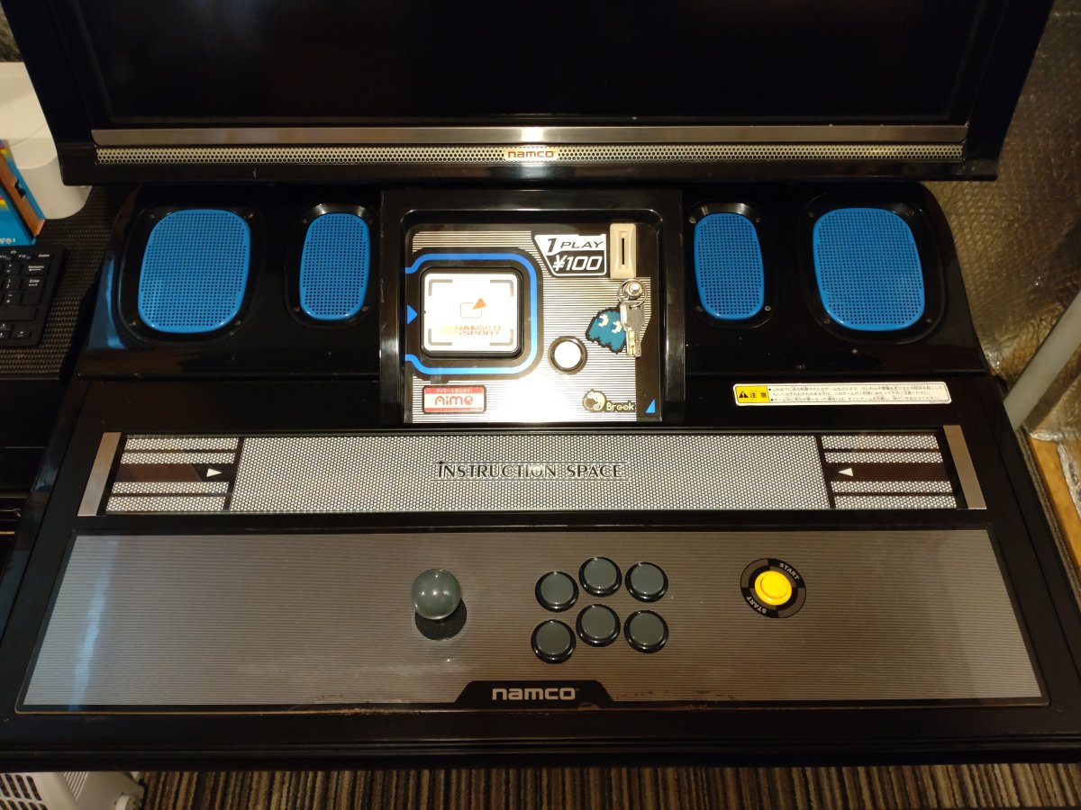

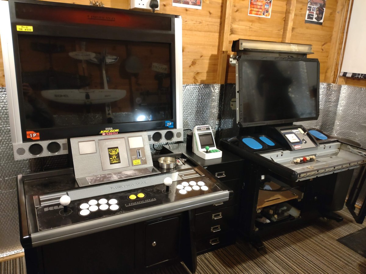

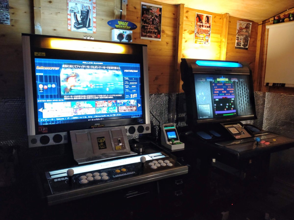

After the full strip down & clean I made some more progress tonight by reassembling the CP area as I took it to work & gave it the rattle can which worked out ok.

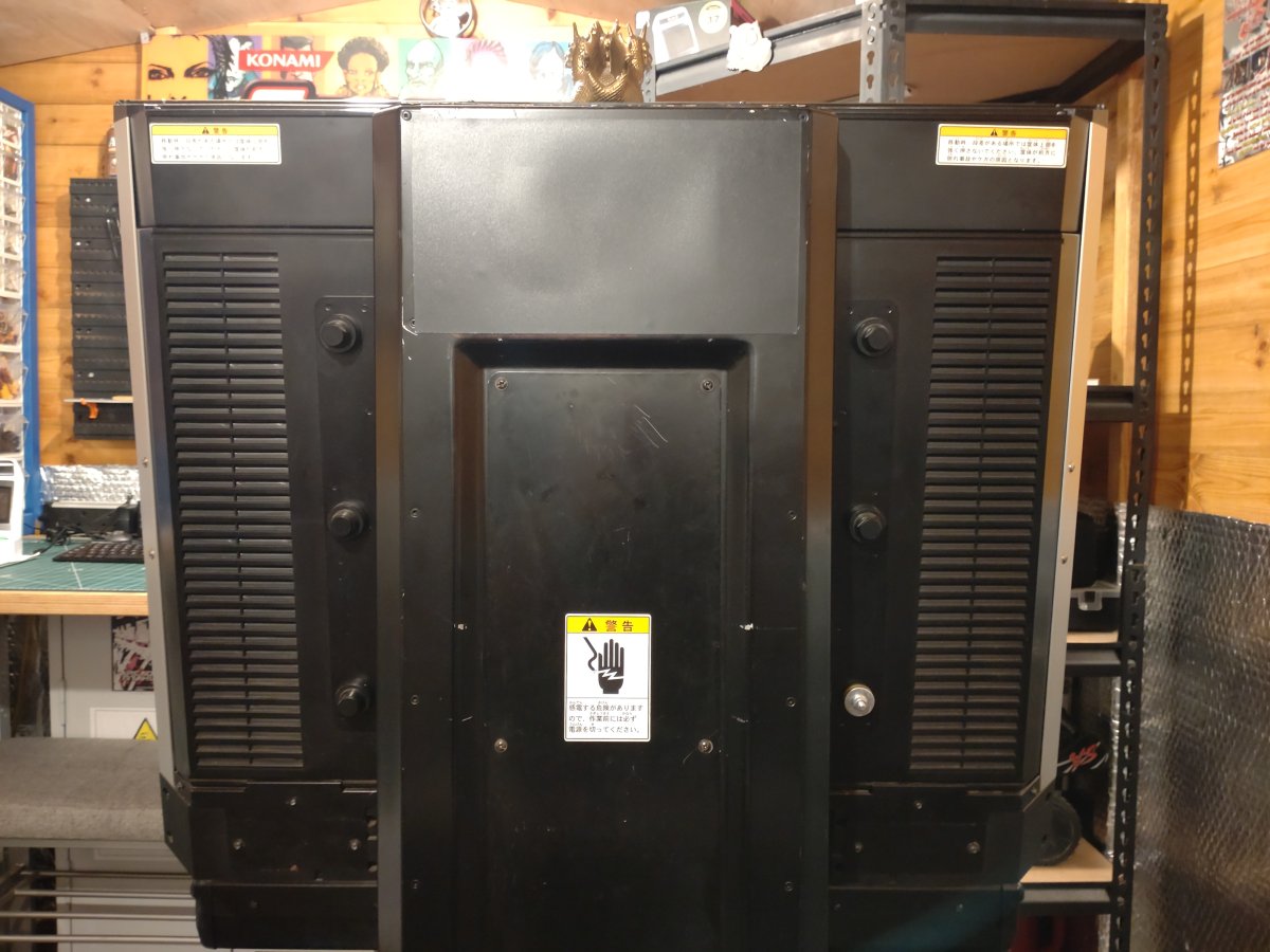

I also had my first power on, that 100v fan at the back was disconnected straight away :D I think the fans on the lcd are good enough for home use
1L6B CP may be temporary thing, I have a Lindy 2L 12B OEM UK one but need to remove something on the cp surround first.

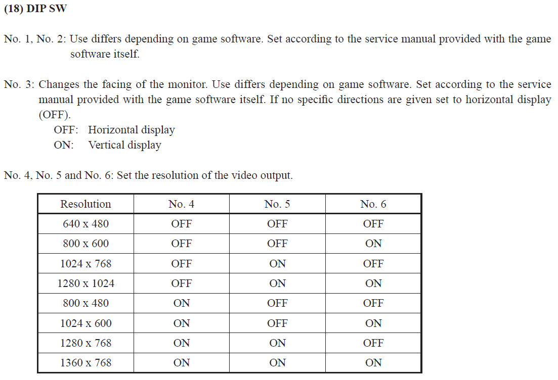

My Lindy has a 1080p monitor swap already done, lindbergh hardware is 720p only I think, so i'm assuming it would work fine if the monitor supports 720p?
Hmm, so i'd need to check whatever LG monitor i'm rocking in the cab can support 1280 x 768 and ideally 1360 x 768. I'm guessing it can becuase it supports 1080p :D

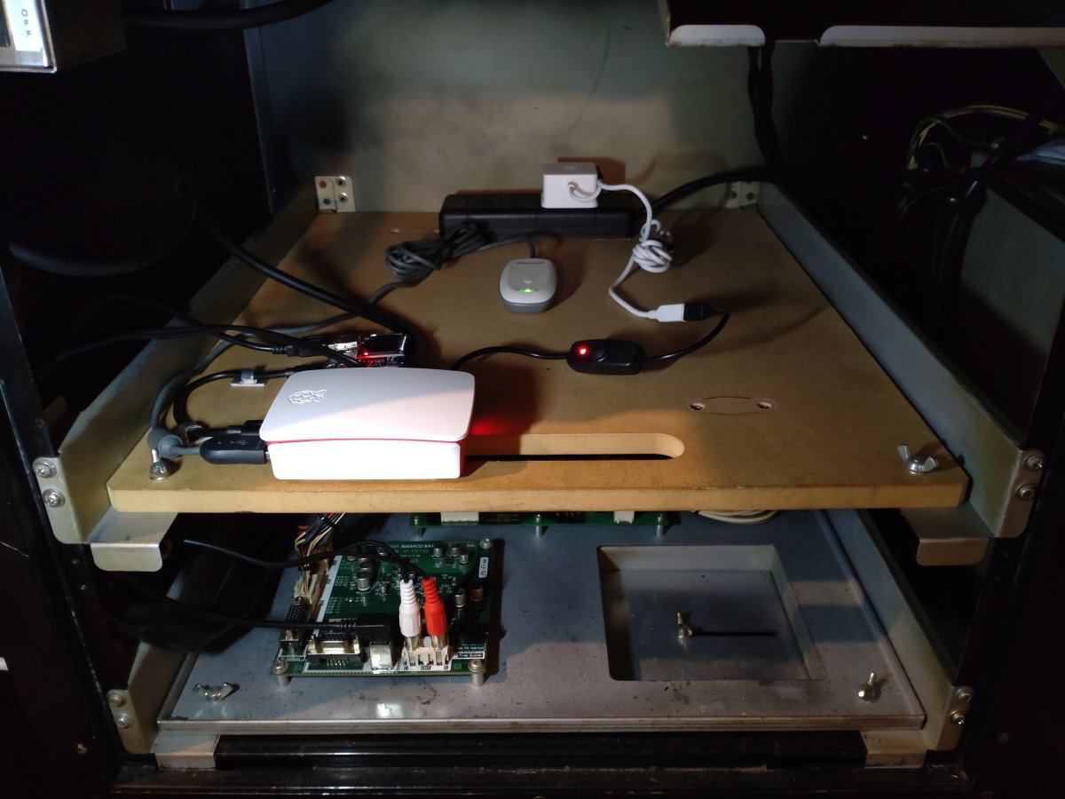

Here is my Pi set-up I've put it side ways so I can easily access the sd card slot through the pcb tray handle slot & swap out images.

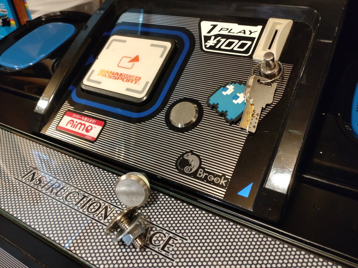

Along with my foil order I grabbed another Lindy instruction space insert which is better than looking though clear glass.
I also found lock space filler thingys from work from a scrap ipub fruit's as I don't need a lock on the middle door for home use, grabbed a few spare too.
