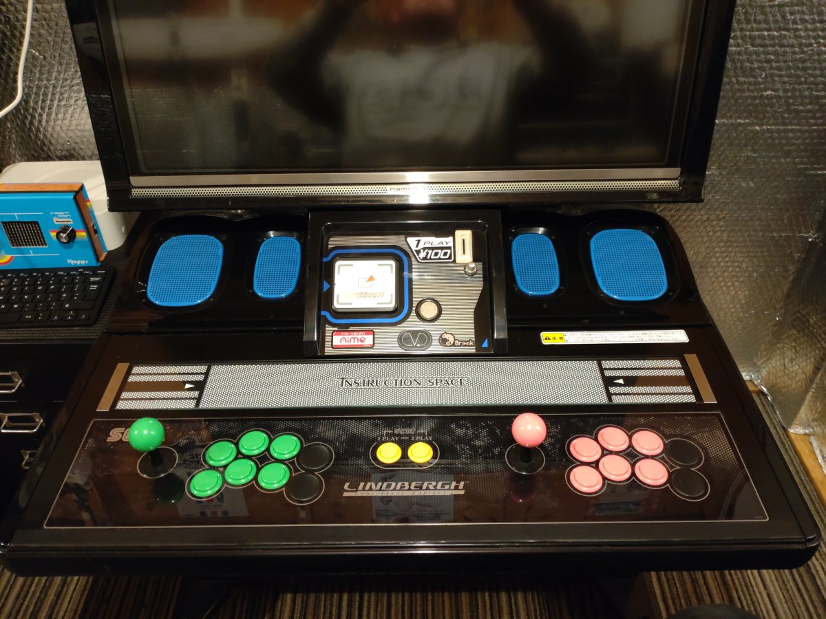

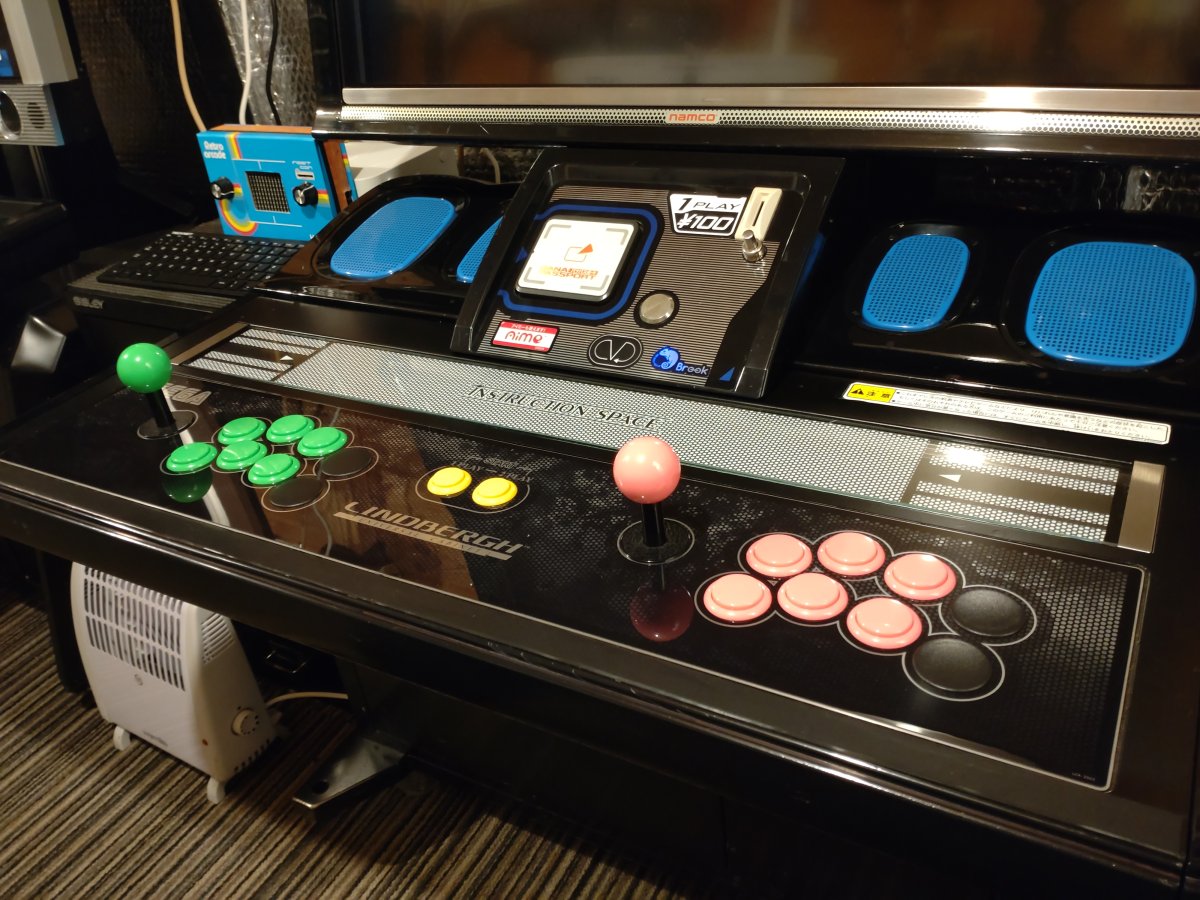

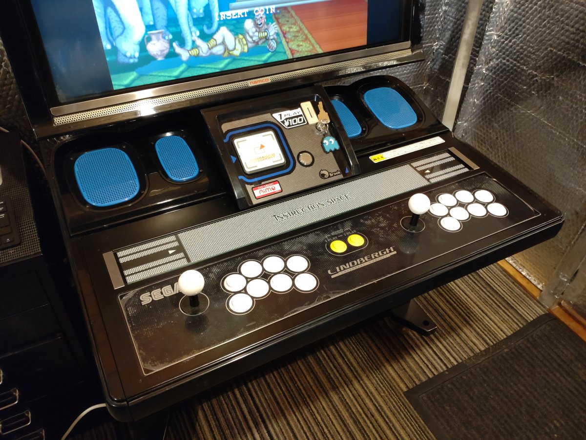

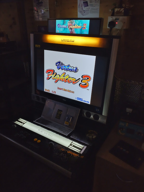

That instruction space insert is beautiful. Do you mind sharing where you got it? I'd love to get one for my cab.
I don't think any official art like on the Lindy was ever produced & I'm not a fan of moves strips.
I put the repro 2L16B panel on the Noir as it doesn't have those lugs on the underside of the cp which stop you putting on a official one without cutting.
One day I will take off the protective film, wiring & connectors is exactly the same easy swap.

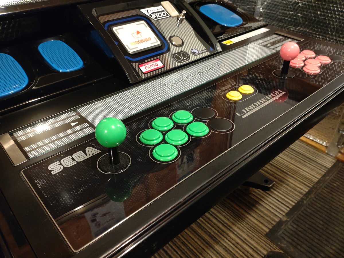

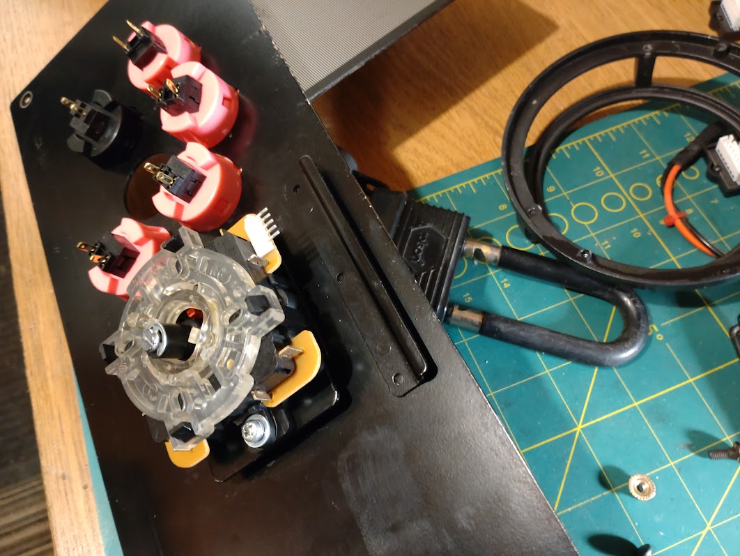

Decided to finally take off my protective film off the repro Lindbergh panel & add some new buttons with 7&8 plugged on both side:

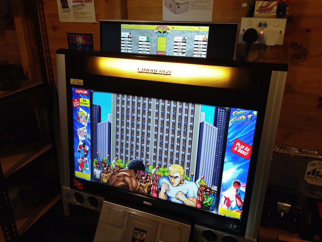

For those of you who have missed it I upgraded the Noir monitor to a LG Ultragear 32GP850 as the stock monitor being a early 1080P screen was a bit fussy with resolutions:
View: https://youtu.be/jB0Wnwf7Ykc?si=MJCBqvDbtfZPGvAd
All went well & is well future proofed old monitor has been offered up on a few UK forums for free with zero interest so will be scrapped.

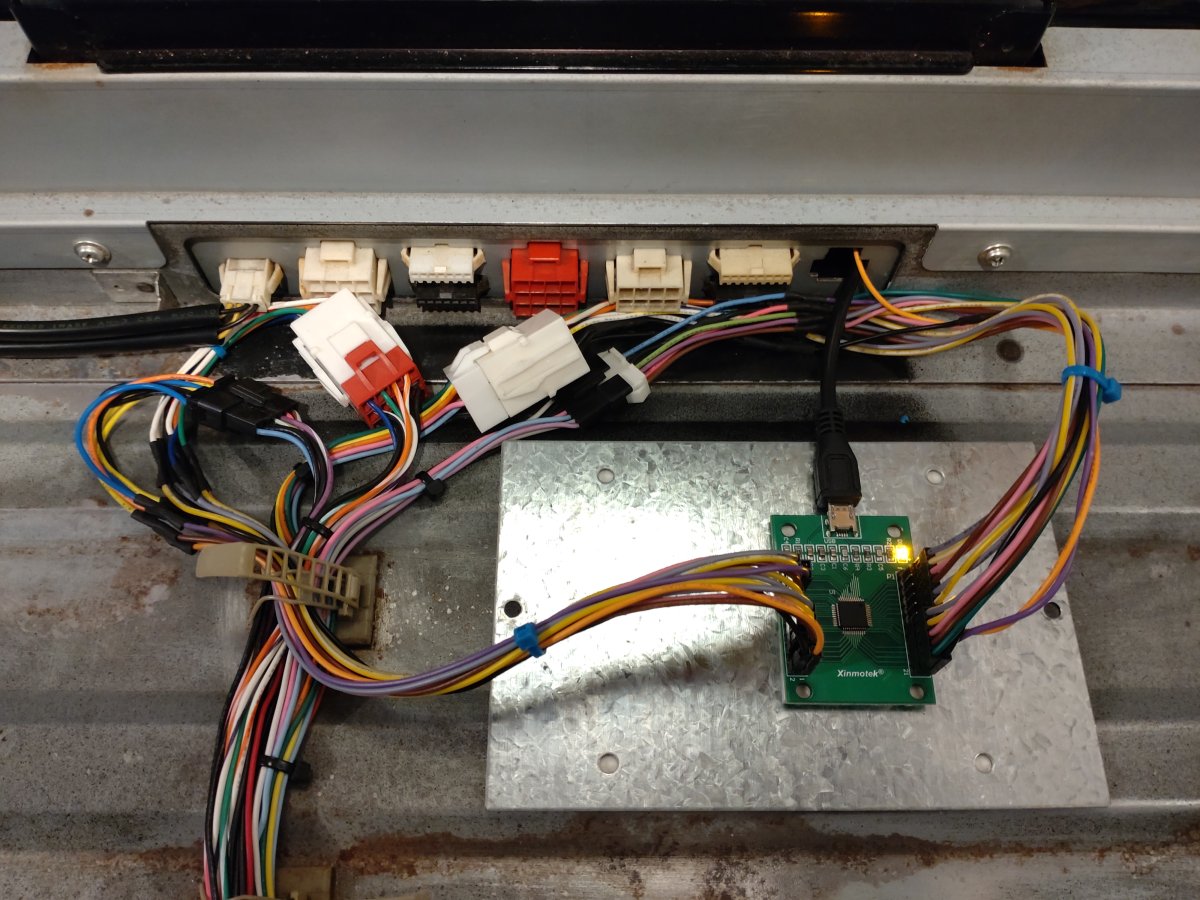

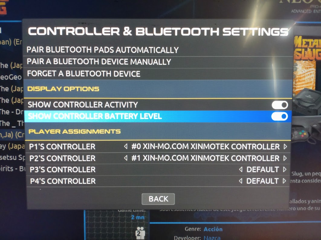

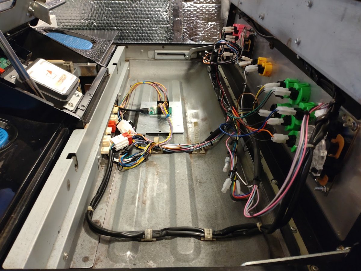

As I was having problems with the JVS-PAC 2 & Pi4 images I got a encoder off eBay & it works great with:
256gb Batocera Raspberry Pi 4 Image from Derek’s Pixeltorium and Quoc Le
It will keep me going until a joypad firmware is made, I had some jst connectors so it will be easy swap back with no oem wiring touched.
Hot key is credit button so easy game exit with start & credit.

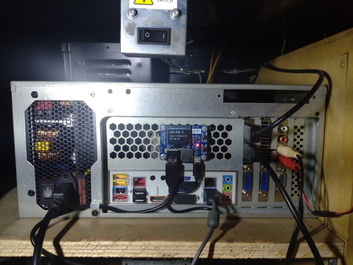

Fixed my JVS-PAC 2 to my pc case (screwed) with a break-out usb for the JVS input.
Just need to get a 1070 GFX card still.
