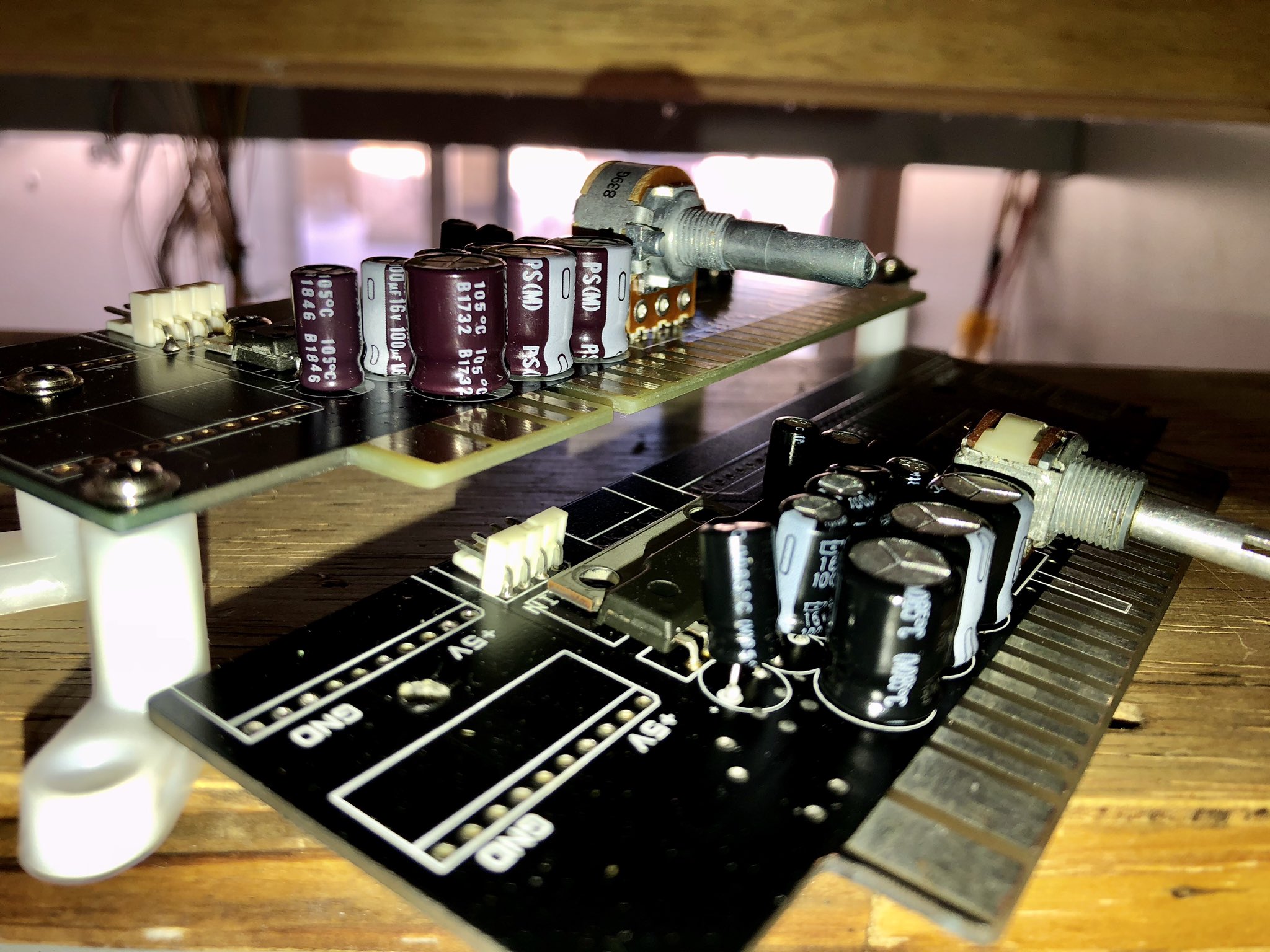

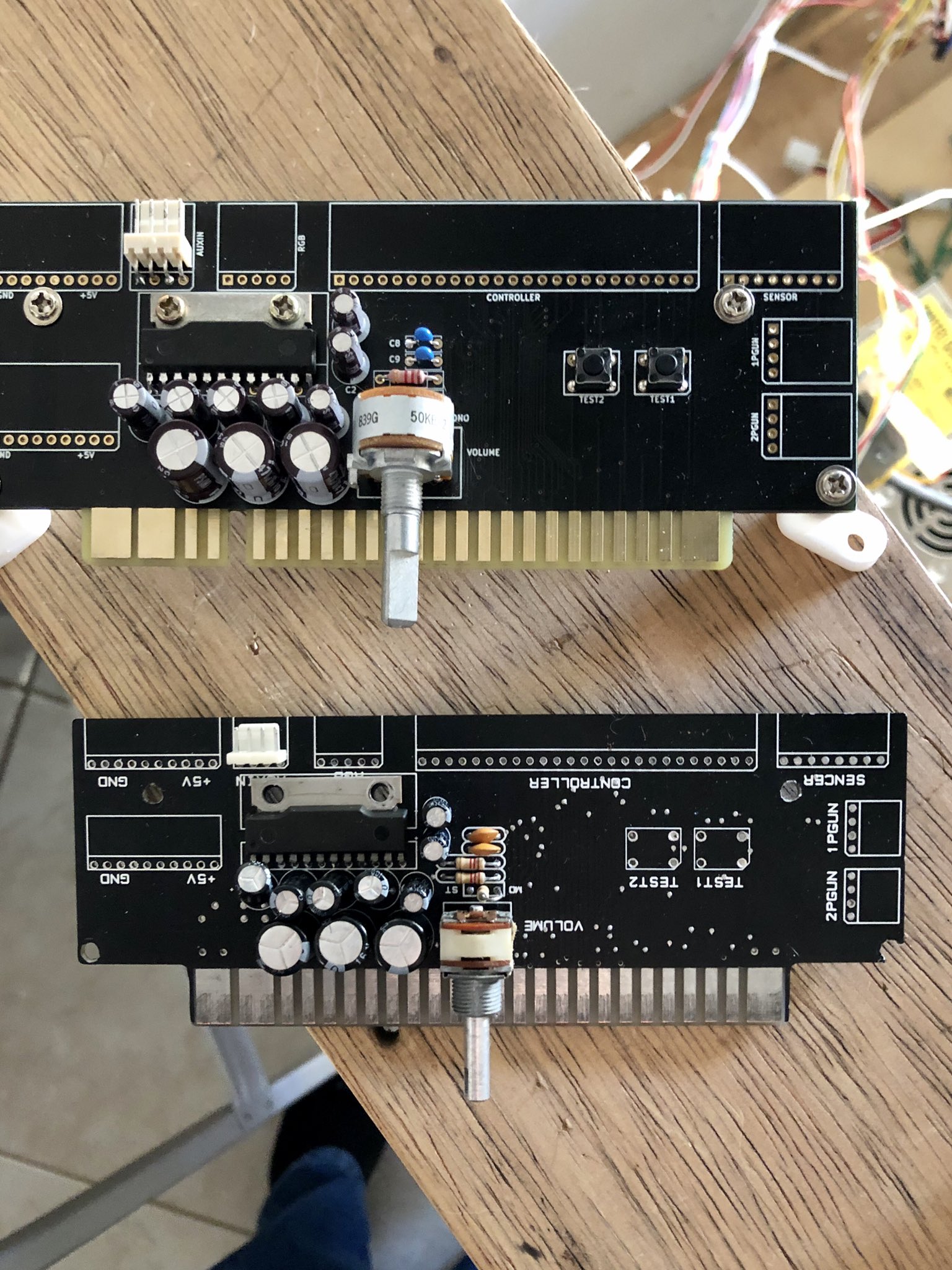

So my header supplier accidentally keeps sending me the wrong 10-pin headers, so I don't have a completed unit to test yet. But in the mean-time, here are some comparison shots of both boards with the amps on them. I feel like the old board was sloppy as it didn't have capacitor pitches that matched what was on the board and they just were cheap using what they had in stock.
Truth be told, the sound coming out of these things is actually really, really good. I am a bit sad their "mono" resistor does not work, and will just be fixing this by making the cable between the filter board and the adapter a summing cable. A little more work and money, but I don't want to skimp on quality here. Absolutely no reason to.

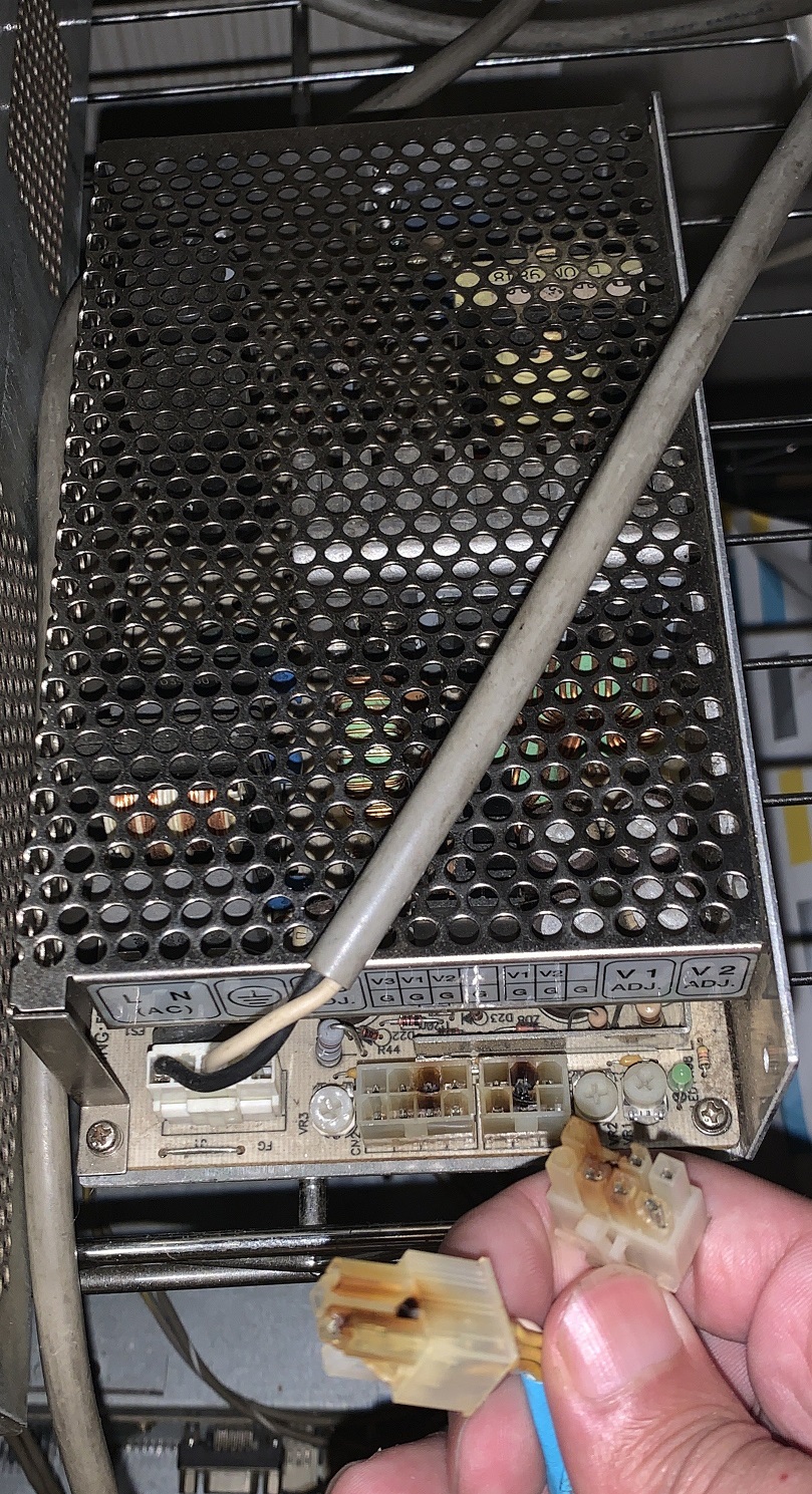

My friend experienced issues when using a lesser PSU on Model 3, it burnt and damaged the power connector and socket on the PSU. He was very lucky to have not caused damage to his stack.

Is that the Sanwa PSU? Cause that looks like a Sanwa PSU that comes with the Model 3 JAMMA kits (like the one I have). I don't think it burned out from being unable to provide enough juice, looks like something else happened there...
I'm not sure if that was a Sanwa PSU tbh. It's hard to say exactly what caused it to burn out like that, but I side with what Twistedsymphony says about it being related to current over-draw.
