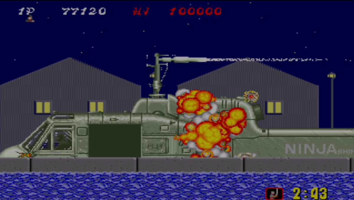

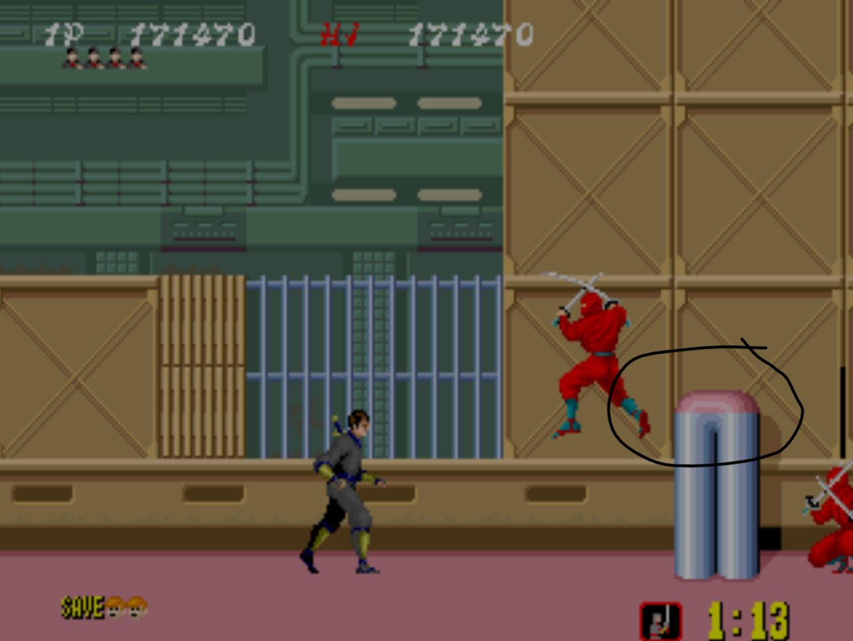

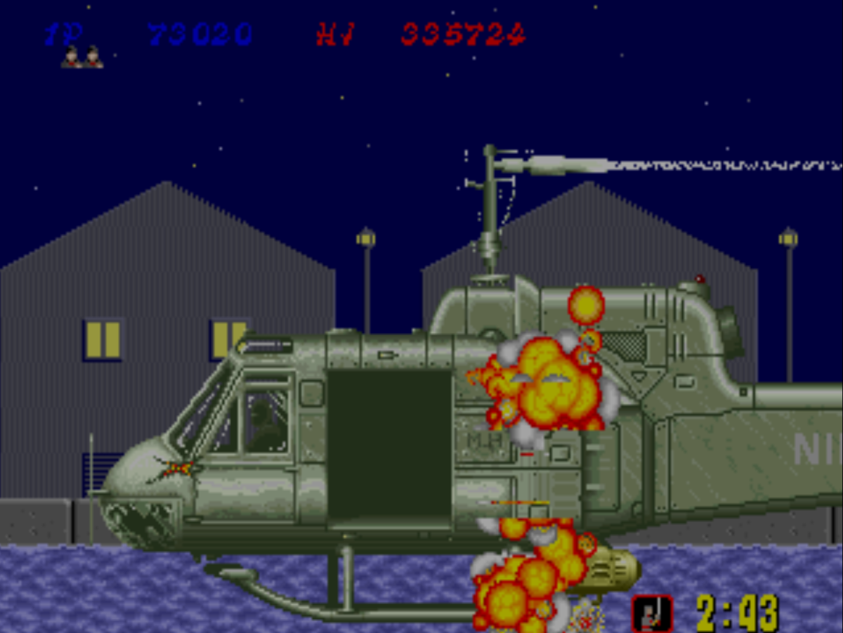

I just tested on mame right know, finished the game w/o any cheats turned on.
What I found, at close range when you attack making a punch or a sword hit the ninja should shout, to be honest he shouts nut its to low that it's almost inaudible.
I Found 2 graphic errors.... At stage 2-4, after beat the chopper, the chopper should dive behind the water, at stage 3-4 just some color error.
Beside this 2 graphic errors and the shout when the ninja hits at closed range everything else is perfect even 2 glitches that I know remained .
PS: I noticed that the score changes the last digit even not using continue and noticed too that some enemies spawn at diferent places occured 2 times, and when boss from stage 1 and 4 are beaten they should shout too, they shout but too low, almost inaudible.

Yep, fully aware of these.
1. Weird graphics tiles, yep. Sorry to say I ain't fixing those now. Changed to the graphics conversion would misalign a bunch of the other hacka I out in place.
2. Audio. The original sounds were so low quality they turned into distorted mess when put through the neo geo adpcm so I cleaned them up. Means they don't sound the same but they aren't painful to listen to
