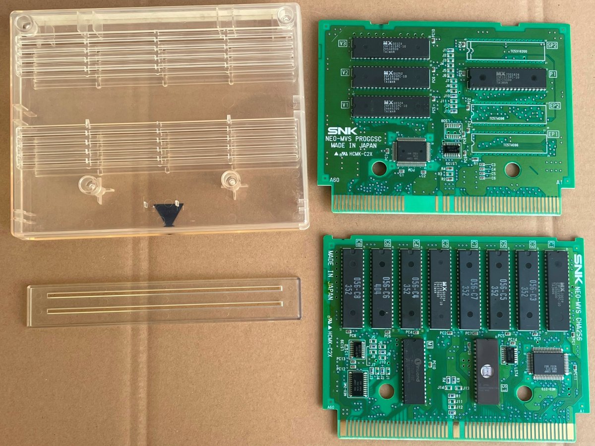

Also, if anyone is building an MVS cart of this, I'm very much interested.
