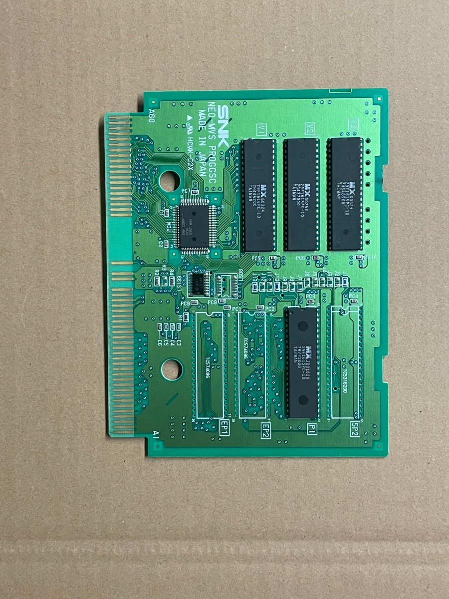

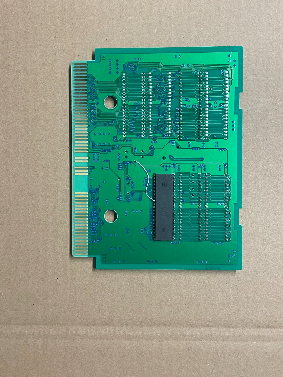

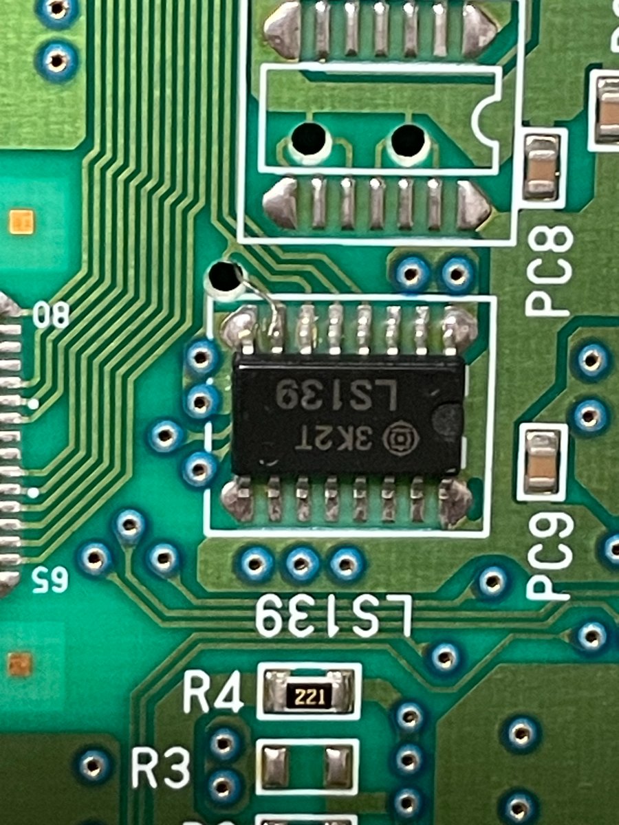

I'm a stubborn person, I like to do things the hard way, so if I have to put 4 VROMs on a 3 VROM PCB, I do it even if it's unorthodox. ;)
4 VROMs on one PROGGSC pcb. Working!

Soy una persona terca, me gusta hacer las cosas de la manera difícil, así que si tengo que poner 4 VROM en una PCB de 3 VROM, lo hago aunque sea poco ortodoxo. ;)
Great work congratulations!!! Could you share a diagram of how you connected everything and which IC did you solder under the PROGGSC?
