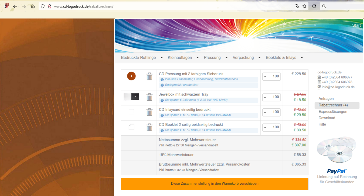

Sorry but you just don't know what that stuff actually costs. Without even looking for a good price, assuming the CD is pressed and not burned (i have my doubts) and the smallest possible run, one of those costs you under 4 bucks.
Yes work isn't free but i kinda feel the Lion share of that work had already been done by other People so maybe that guy shouldn't sell it for profit.
And yes he had to "design" the Inlays and the CD design but since he followed the NeoGeo CD Template 1:1 that probably didn't take too much time (Not saying it's badly done just that it isn't that "much" work either)
