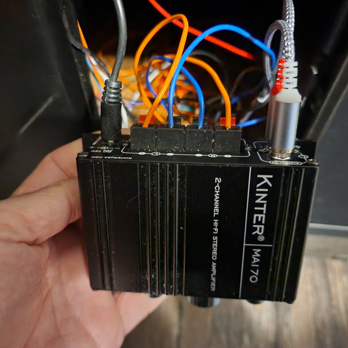

Making a standard JAMMA cabinet work in stereo requires some re-wiring and addition of an amplifier (for line-level / RCA outputs). I don't have any hardware recommendations at the moment. I run everything through a Blast City, which already has a stereo amp.
I was working on a generic solution to add stereo capability to any cabinet, while still maintaining mono if needed, with optional subwoofer output. I just haven't found the time to dedicate to building the prototype out yet.

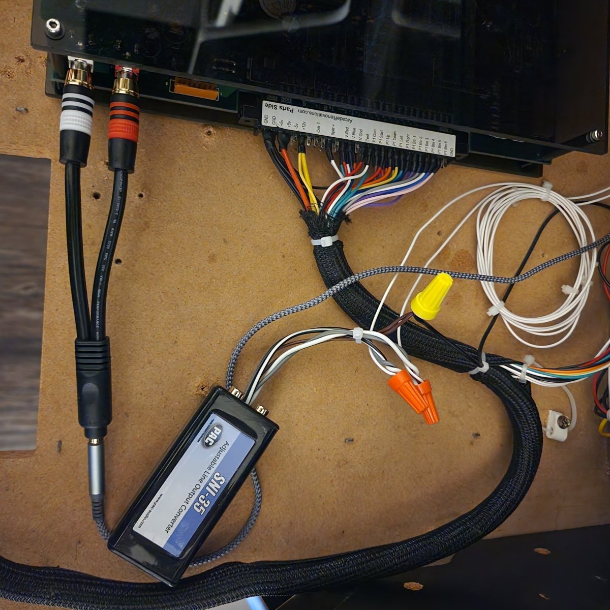

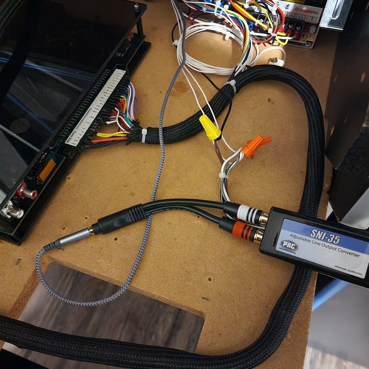

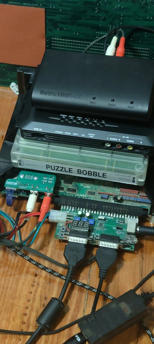

Thanks, this makes sense. Would you mind sharing a pic of how you have it set up? I think I understand what you mean, but am a visual learner :)
Sure thing! One pic has evertens stereo hooked up, notice the loc empty. The other has jamma mono hooked up, audio cables in the loc. Amp connecting the speakers in my cab and red/white compsite from to 3.5mm to the loc.

Curiosity piqued -- would the generic solution be a JAMMA adapter or something else?
The amp design I have would sit in between the speakers and the JAMMA connector. I suppose this could be a JAMMA adapter, but I envisioned this as something that would be permanently mounted in the cabinet. Basically cut the Speaker + and - wires and wire it into the amp. The amp would also have RCA input with ability to switch between stereo and mono, as well as headphone out.

Stereo is not part of the JAMMA standard, so I would recommend AVOIDING doing anything stereo related with your JAMMA harness.
most PCBs that supports stereo provide RCA connectors for it, or have a separate header that can be adapted to RCA headers.
Here's what you do if your cabinet already has 2 speakers
1. Buy any one of a Class-D or Class-T amplifier on amazon or eBay that you think will fit your cab somewhere and can be easily powered by your cab.
2. find a connector in your cabinet's harness that goes to those speakers and nothing else
3. disconnect that connector and build a harness that can connect your amp to it
4. run RCA connectors from your Stereo PCB to the amp
Then if you have a board that DOESNT support stereo: disconnect your speaker connector and re-connect your normal cab harness... then you can switch back and forth easily.
