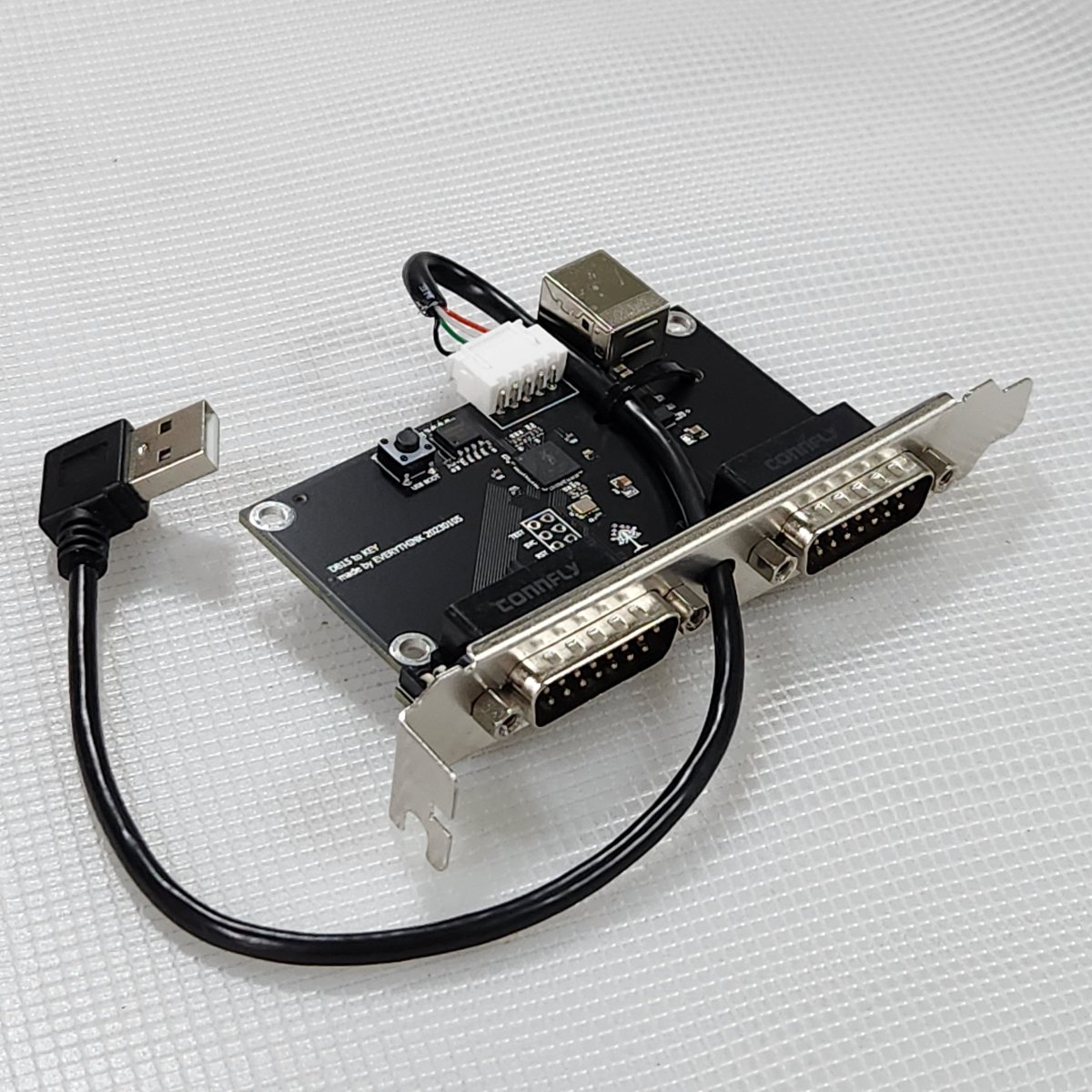

I made online shop 'Crown Arcade Shop' http://crownarcade.co.kr
'DB15 TO KEY' has renamed 'Neo Geo TO KEY' and TTX3 only version is released as 'Neo Geo TO TTX3'
Neo Geo TO KEY has 9pin USB connector for mainboard. You can use it on Desktop PC and Taito Type X4.
https://crownarcade.co.kr/products/neo-geo-to-key-pci-type-usb-keyboard-interface
Neo Geo to TTX3 has a bracket specially designed for Taito Type X3. Since TTX3 does not have 9pin USB connector on the motherboard, external USB cable helps to play it.
https://crownarcade.co.kr/products/neo-geo-to-ttx3-pci-type-usb-keyboard-interface
Both version supports 14-key simultaneous input and are optimized for ARTAX 4.1
