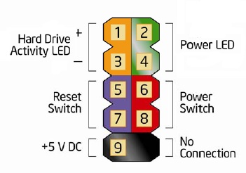

Does anyone know what pin headers on the mobo to use to put a regualar on/off switch as my PCI-ecard has maybe died & I want to test that the rest still comes on.

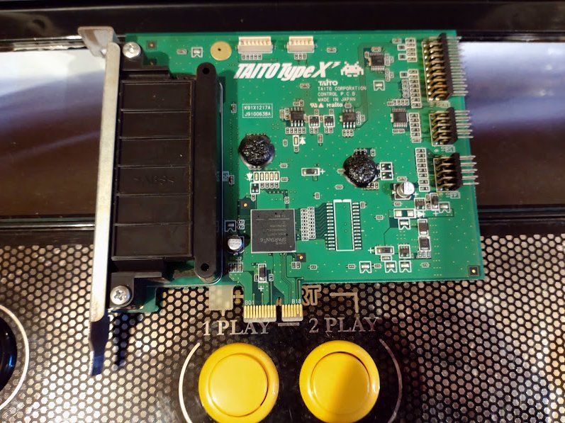

I meant the JVS/Fast IO PCI-e Taito board but thanks it looks like 2 chips fried.
I was only using it 2 days ago & turned it on last night & had nothing apart from 2 solid lights on the daughter board on he front of the case where you connect JVS/Fast I/O I tested the PSU with pins 4&5 & it comes on so took out the PCI-E Taito board & saw the melted chips.
Oh my! Those do look a little crispy 8|
FYI, the JVS portion of that card is separate to the FastIO… you could still feasibly run it JVS only, although I may be inclined to remove the PCI-E connector in that case…

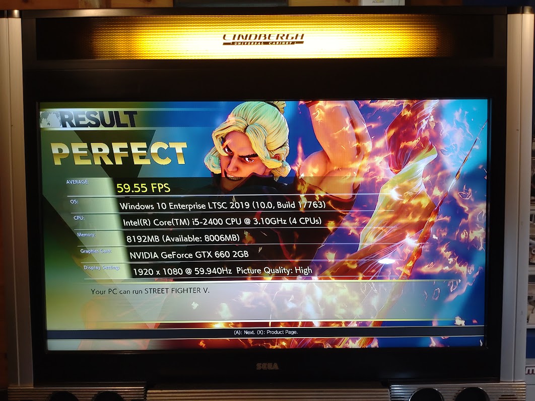

So after a few days of trying different things to get the Type X3 mobo to come on I gave up & looked for a old micro ATX mobo (9.6"x9.6") that supported Legacy bios boot, PCI-E 3.0, DDR3 1600 ram & LGA1155 socket & found the Intel Desktop Board DQ77MK to meet all these requirements & so got a used one on eBay & I also got a new PSU from Amazon as well as a pwr toggle switch, got it all fired up last night with the old components, i52400 + heatsink & fan, Twin frozen III gfx card, 8gb ram ect using my trusty JVS-PAC for controls, multi image so far has worked just as well as it did on the stock mobo.
Strangely enough after all that I gave the oem mobo a go again & the psu came on so something must of got disturbed for the better in the process so maybe I can get that going in the future to possibly sell on.
Well I could only run SFV on the high settings before as max would only get about 30fps so it looks like the Intel mobo is all good.

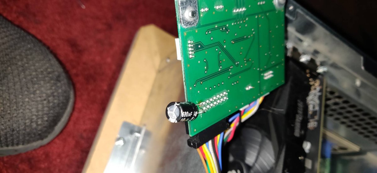

I wonder if you were having the same issue I was. I would connect the AC power to the ttx3, but the PC would not power on. iirc, I would get a solid green light on this board.
Using this same board, I was able to create a sudo switch by using the properties of capacitors. With the correct voltage rating and capacitance, you can create a temporary short across the power switch that would power it on. The perfect value that worked for me was a 10V 680uF capacitor. Do take note that too small of a capacitance would emulate a rapid power switch tap that is unrecognizable by the system. Too large of a capacitance would emulate a long press on the power switch which would power on then power off the system.
Here is how I soldered the cap to the board. Take note of the polarity of the cap.
I had this issue with two SFV cabs and one NesicaxLive2 cab. All three were fixed using this method. I haven't had issues ever since.
I hope this info helps you or anyone else with a similar issue.
