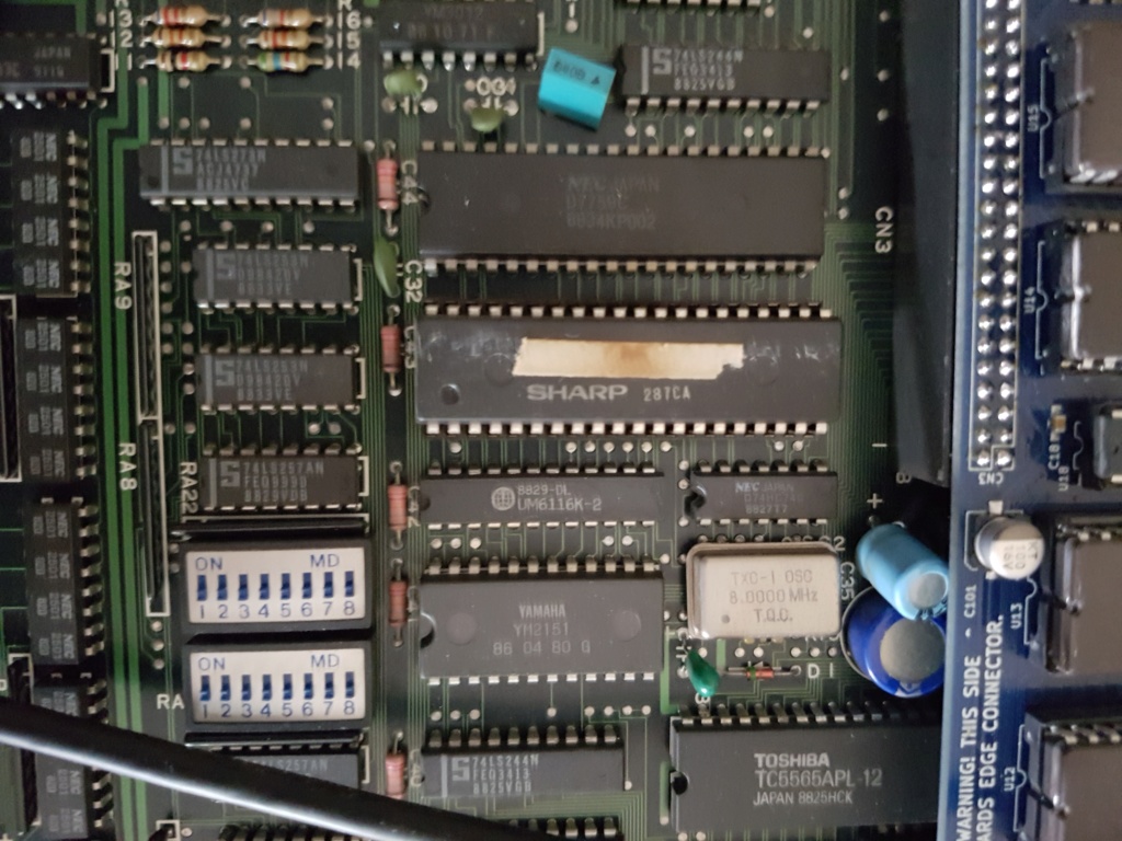

I have black screen with my mullti 16B. So @Derick2k burned me 14x27C322 (THX very much @Derick2k) , so I will re burn the NOS 27C801 but I have to a sharp chip instead of the Z80. Do you think the sharp chip is guilty.
Post a pic to see what/how you got things set up.

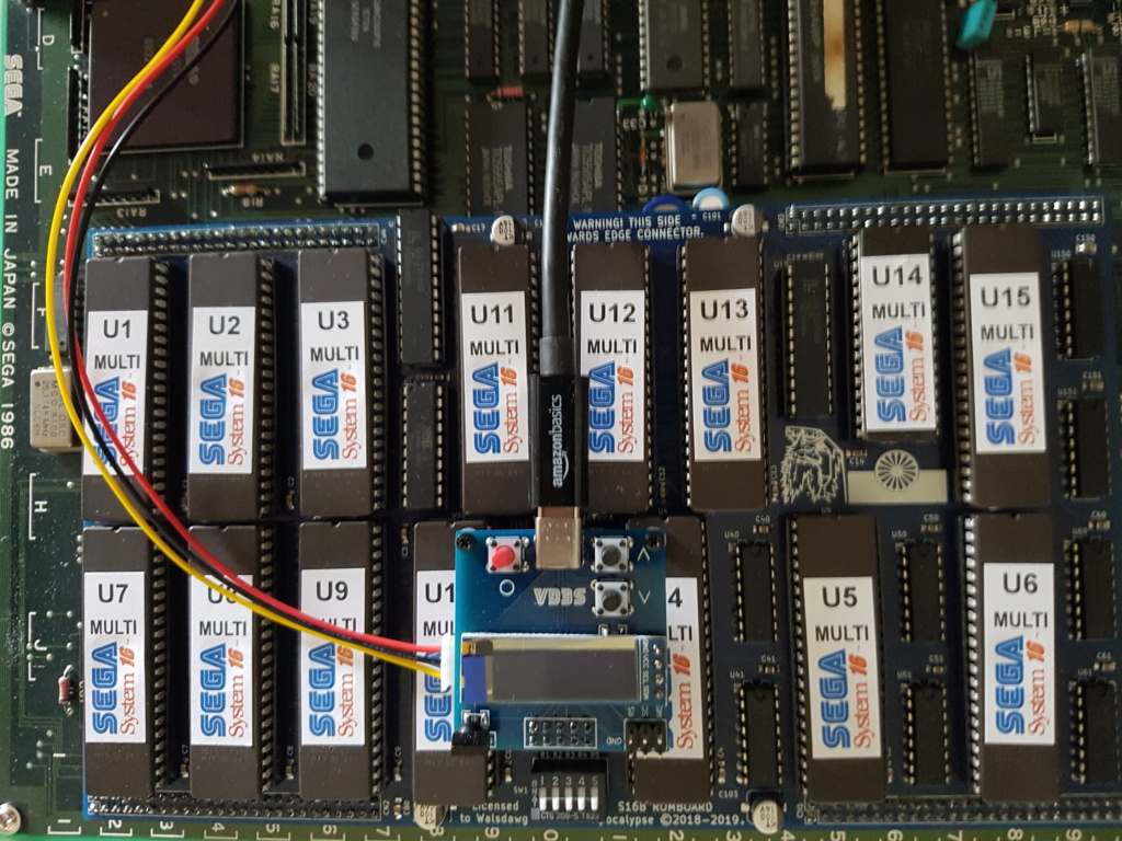

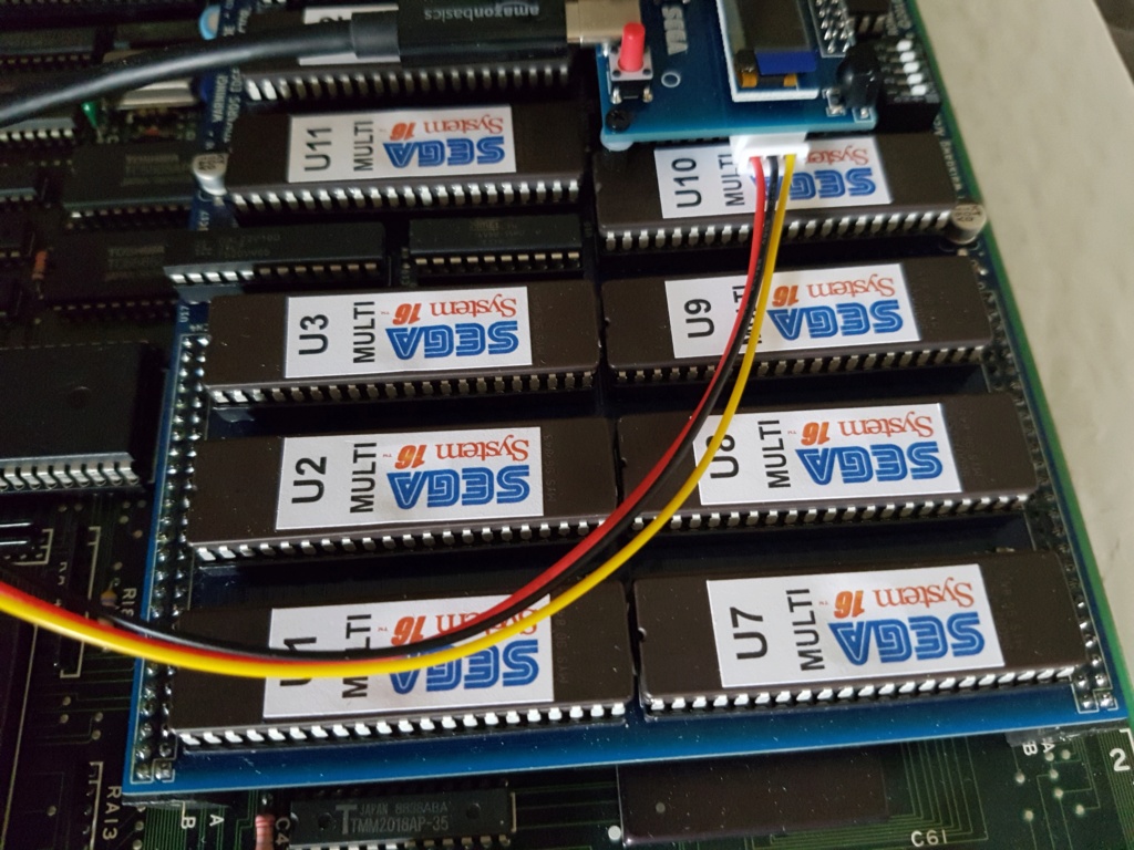

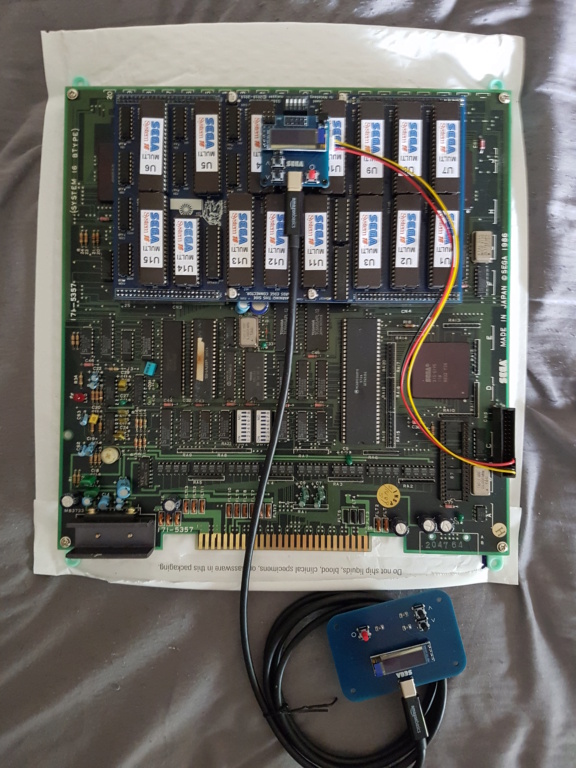

Can someone post a pic of their new Multi Rom board with all of the chips installed so I know where each one goes...

Pics above!
