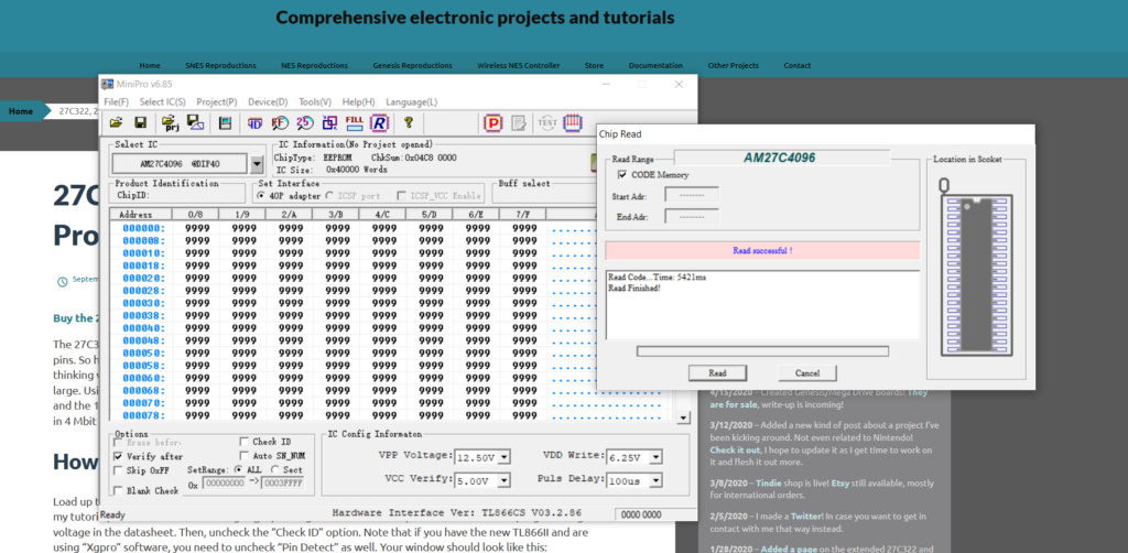

I try to program 27C322 chip, but with my TL866 I have this when I tried to read the eprom:
Also I tried to erase it couple of time with UV eraser.
Note that I use a adapter for 27C322. So impossible to program it. Could you help me please?
THX

i'm using TL866 II + only for write jed files on gal/pal chips & 32 & 40 pins only ... i didn't have the adapter who support 42 pins , but from what i know , you must write an 27c322 with a bin 8 times to have all dates from a bin who normaly is writed 1 time with an TOP3000 programmer .
ps : can you show a picture with your adapter ?
Are you using an adapter like seen in this article? The instructions for how to use it are in the article.

THX all so I found on the web, must load up the 27C4096 chip on the TL866 software, all explain here:
27C322, 27C160, 27C800, 27C400 Programming Adapter (TL866)
Now I know how to program it, I have another issue, I use Sega System 16 Roll-Up Pack found in forum but black screen (I check 2 times all eprom) and I compare with eprom burned by Derrick it's very different (HEX code) so is it normal does exist some of pack, what's the best?
