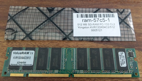

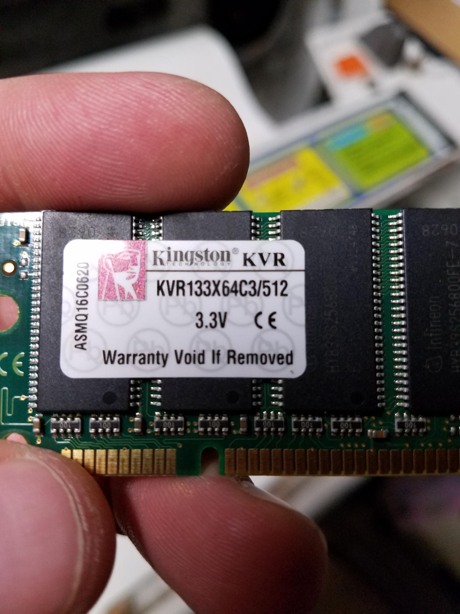

Tried another pair of Kingston 512MB (each) and one of it worked. I've not been in luck buying old SIMM of ebays.
At least my NetDimm now has 512MB installed.
I know some people have gotten the PC133 sticks to work, but I've got no problems with matching PC100 sticks.
As @twistedsymphony pointed out the Naomi operates the same (133 vs 100) I think PC100 might just be (slightly) more compatible?
Can anyone tell me what DIMM modules to use with Chihiro ?
The one in my unit does not have any label at all :(
I'm pretty sure any of the modules listed in the op will work in the chihiro type3. I have a variety of sticks. Back in sept or oct I played RAM roulette between a few netdimms and a chihiro type 3 and I *think* they all worked. But I know for a fact the one photoed above works.
