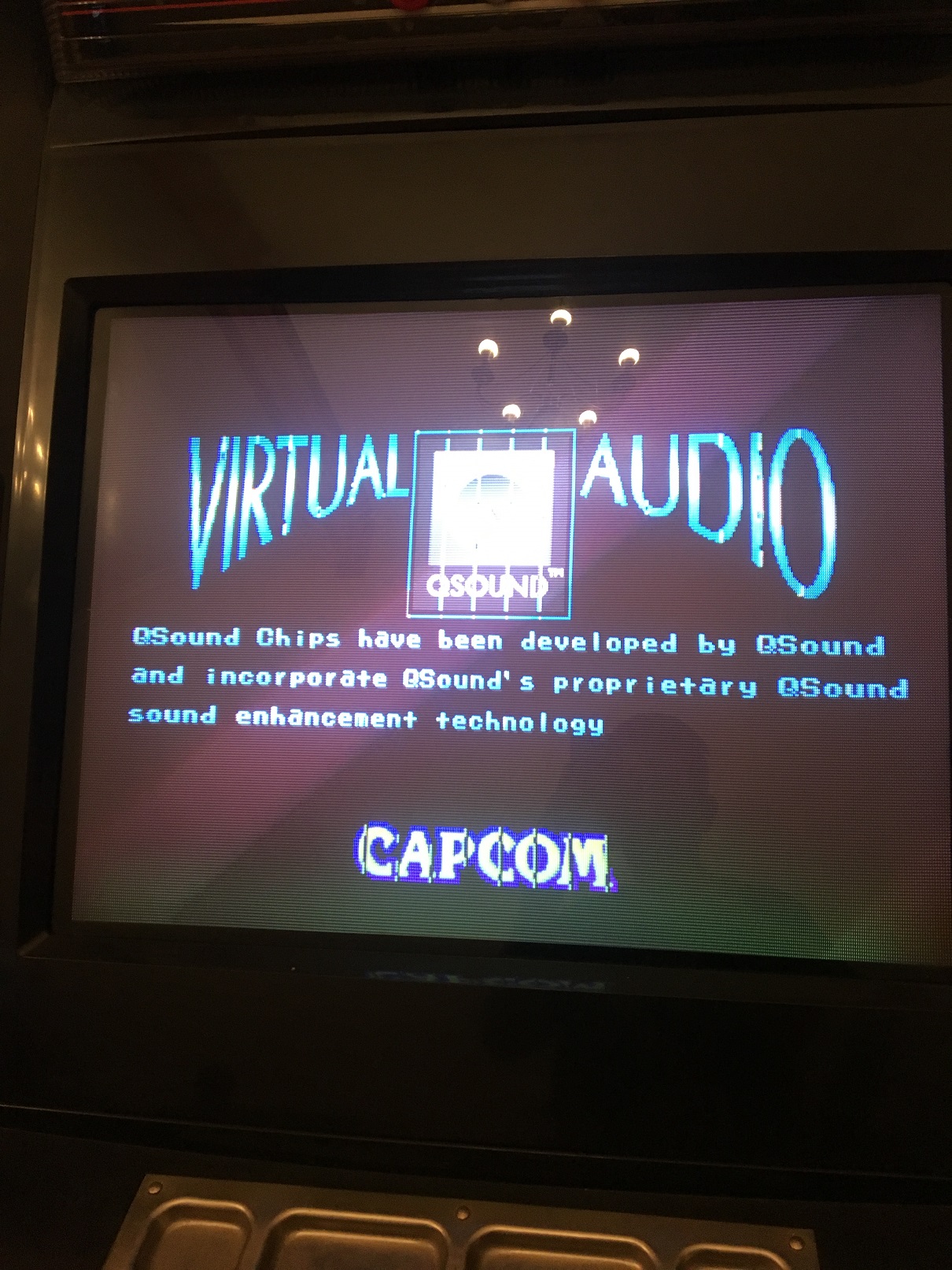

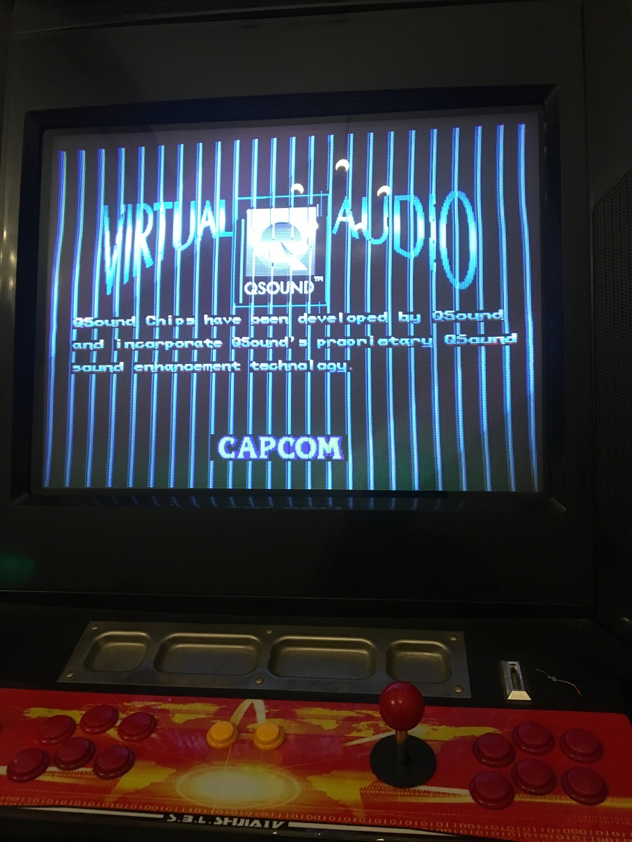

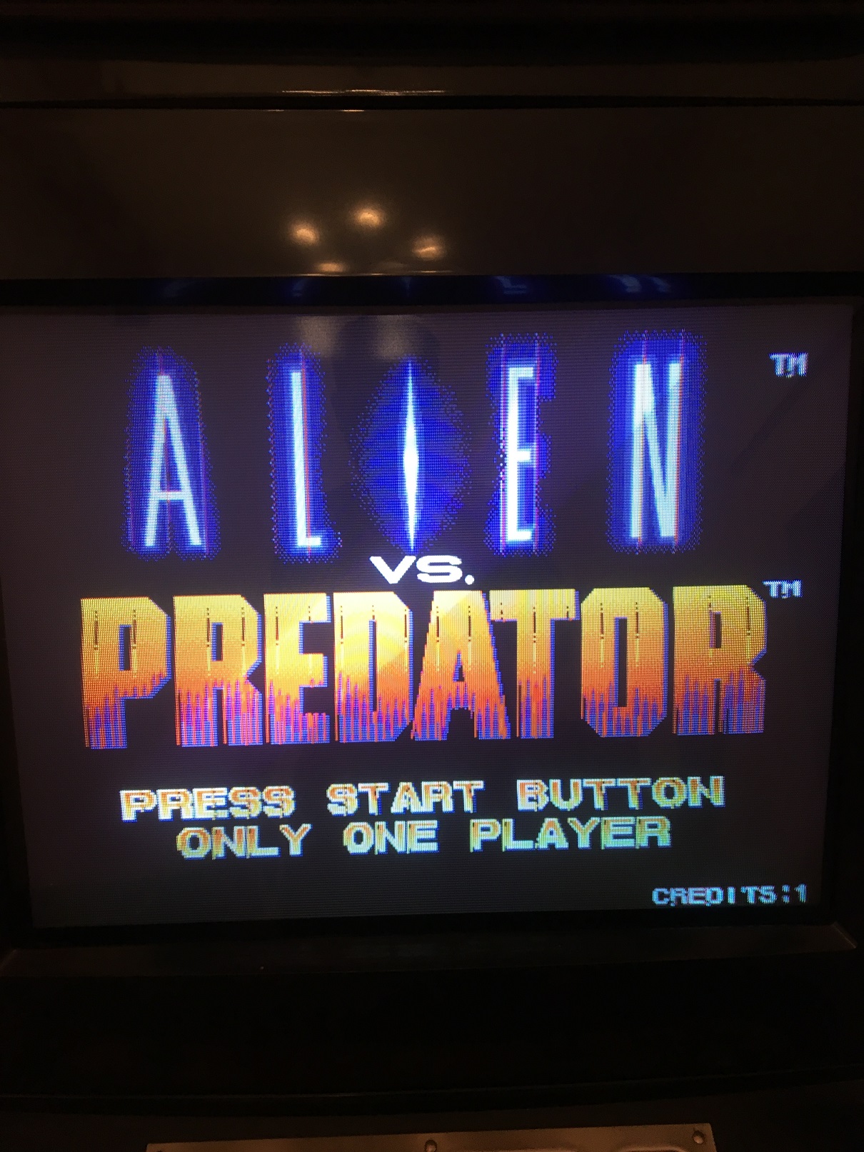

Those could be related to the jumpers, a bad pin or bad RAM in A Board. Are the bars always happening in the same place?
Does seem to be in the same place and not visible on every screen that comes up (always visible on the qsound screen doesn't matter which game).

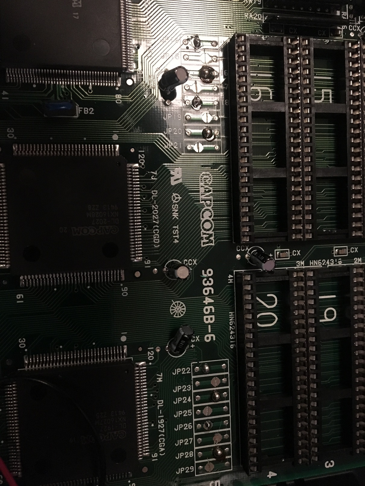

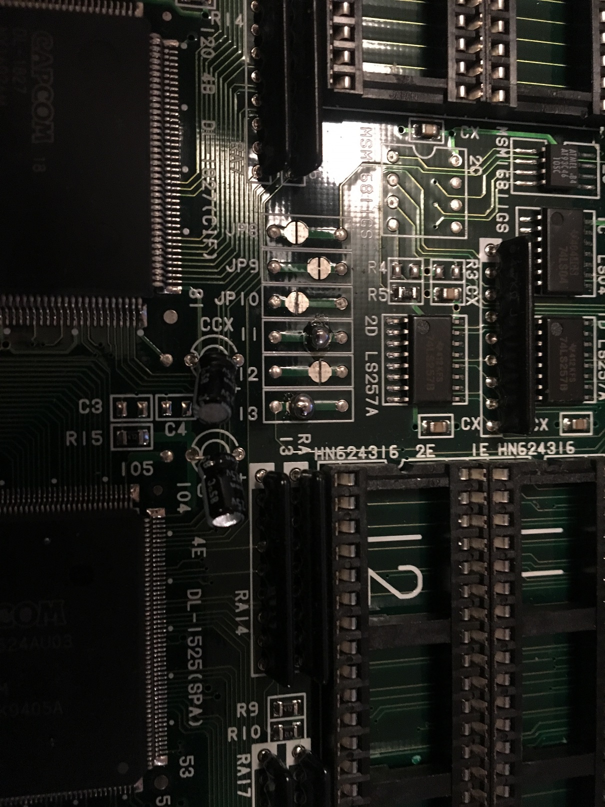

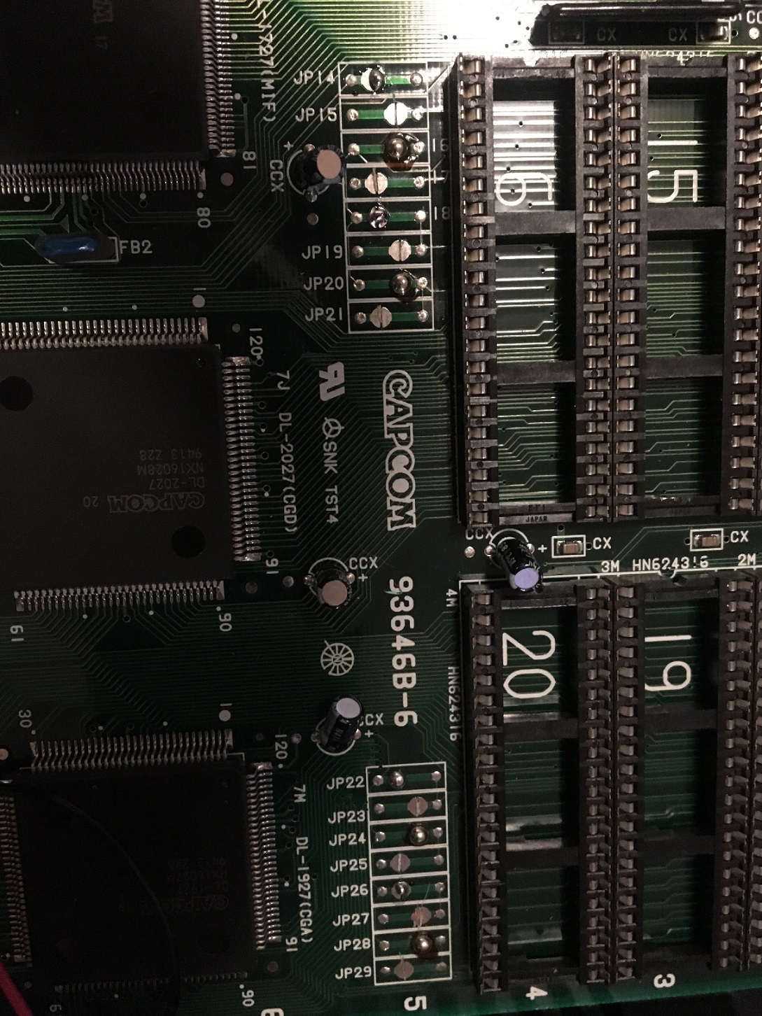

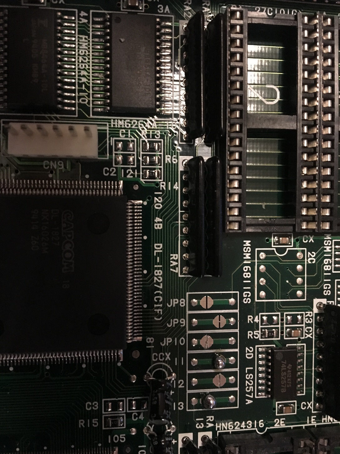

post some more pictures please.
I just finished taking the boards off, checking all the pins are straight and put the multimeter in beep mode over all the jumpers again. Here are some pictures
On some screens the artifact lines are less noticeable but still there (notice inside the word predator there is artifacts)

Have you reseated your A and B boards and checked for bent pins between the 2?
Also, make sure your interconnect board for your multi is properly seated. Those jailbars are all through data in the main program ROMs
Yeah i've done a+b a few times now (i assume you mean CPS2 motherboard (a) + game board (b)). No bent pins. I also just took the darksoft kit right off again, separated allthe boards so i could check all the jumpers and put those back on too.
I don't have the b board back in its case yet, i do notice boards in their cases connect really easily while i need to push on each connector when not in the case to make sure its in tight.
I just tried another b board that i have (marvel super heroes) and it works fine so it's not the a board or bent pins on it. If i don't get anywhere i could try changing the jumpers and pal on my marvel board to try the darksoft kit on it.

I don't see the B board being the issue if it worked fine prior to you installing the multi, I think there's a loose connection somewhere
Try installing the board into the case (making sure to remove the post that gets in the way) and putting it together with the clips and see if that helps

I just installed it in the case and BOOM! working no lines!
wow crazy i had the a+b pressed really tight but somehow being in the case makes the connection better. I must of pressed down on all 4 connectors so hard before but it made no difference!
