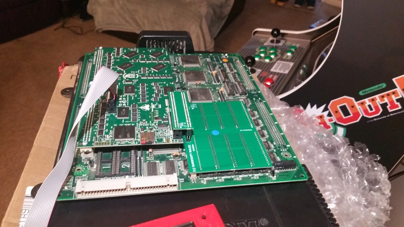

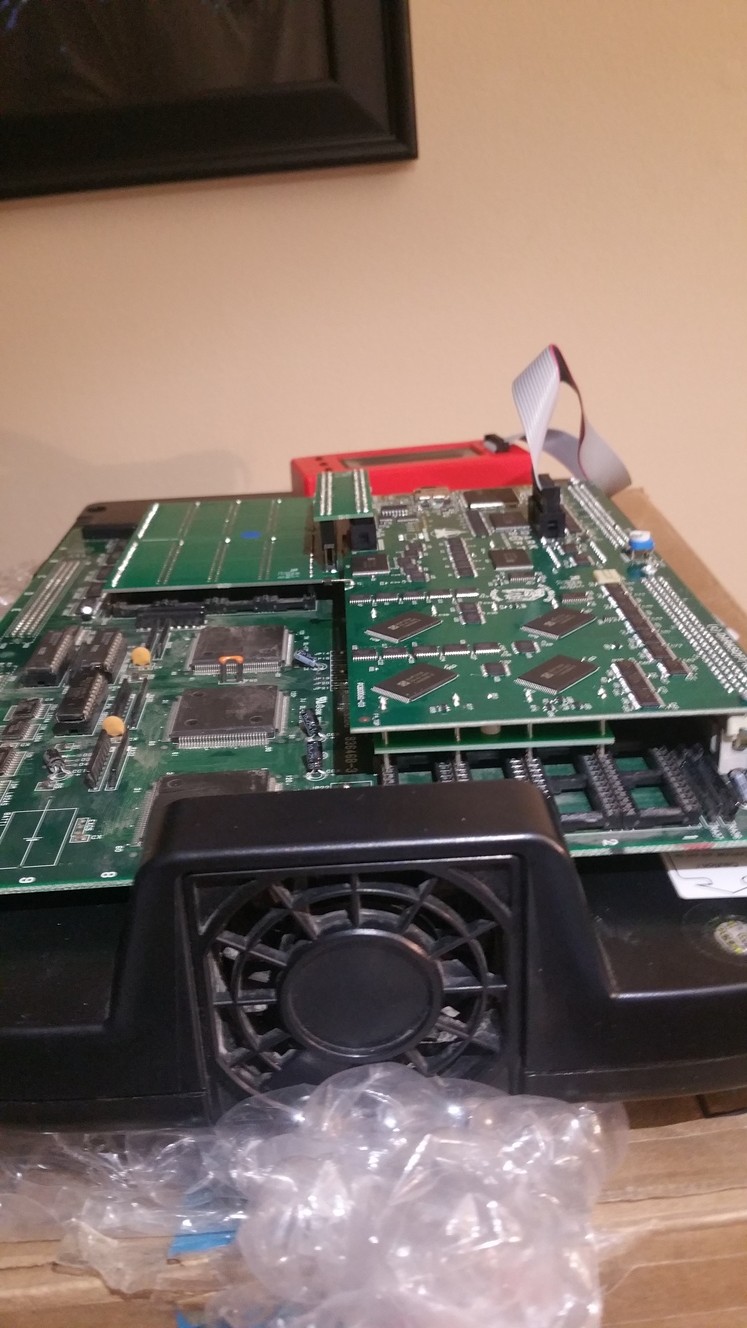

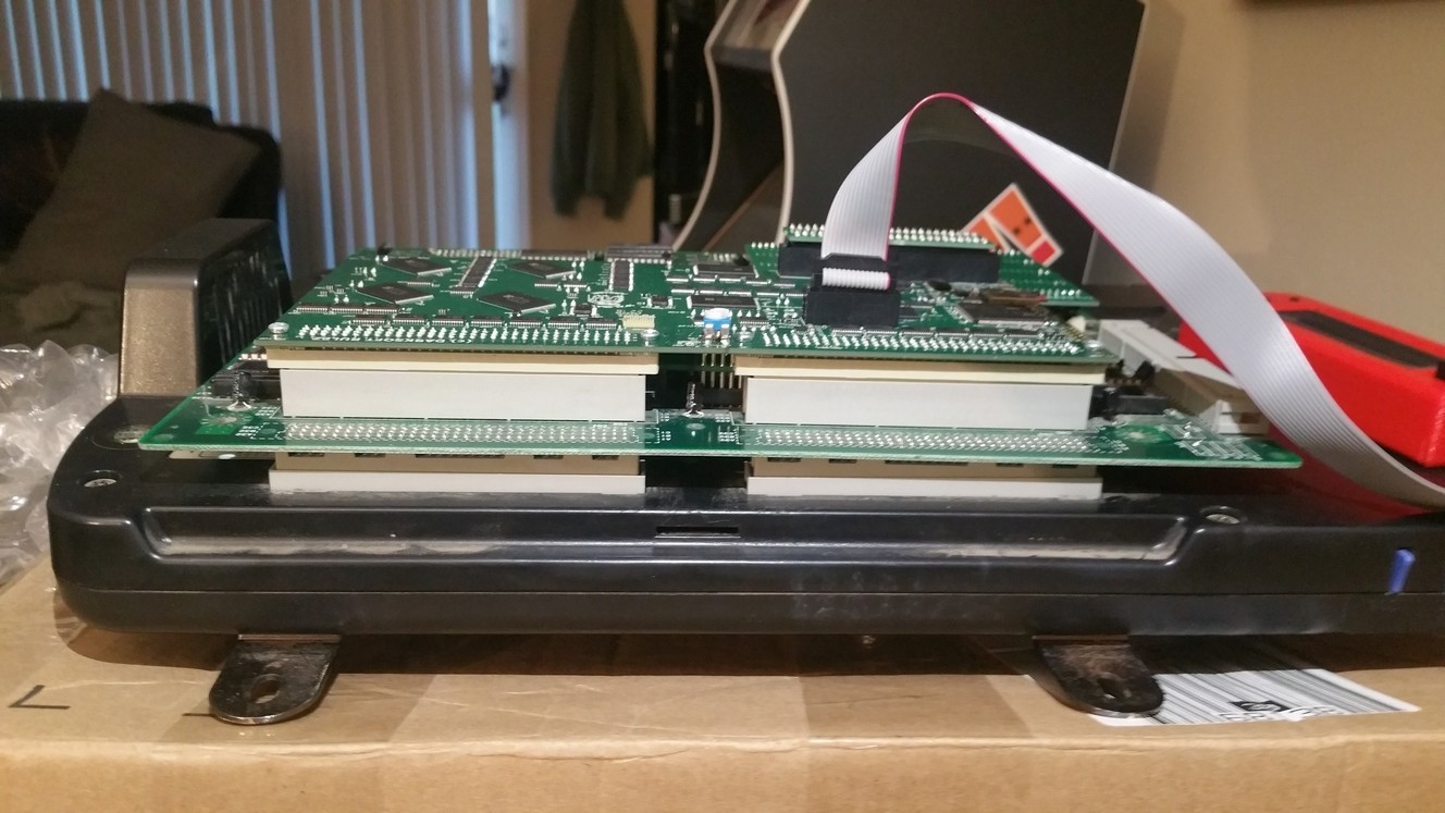

Also check that the interconnect board is firmly docked. Looks like it's higher on one side to me. Might not be making a good connection
I will verify sunday when i get a chance and let you guys now what i get.I received the same ram error when my A and B boards weren't seated together properly.
^THAT^Also check that the interconnect board is firmly docked. Looks like it's higher on one side to me. Might not be making a good connection
