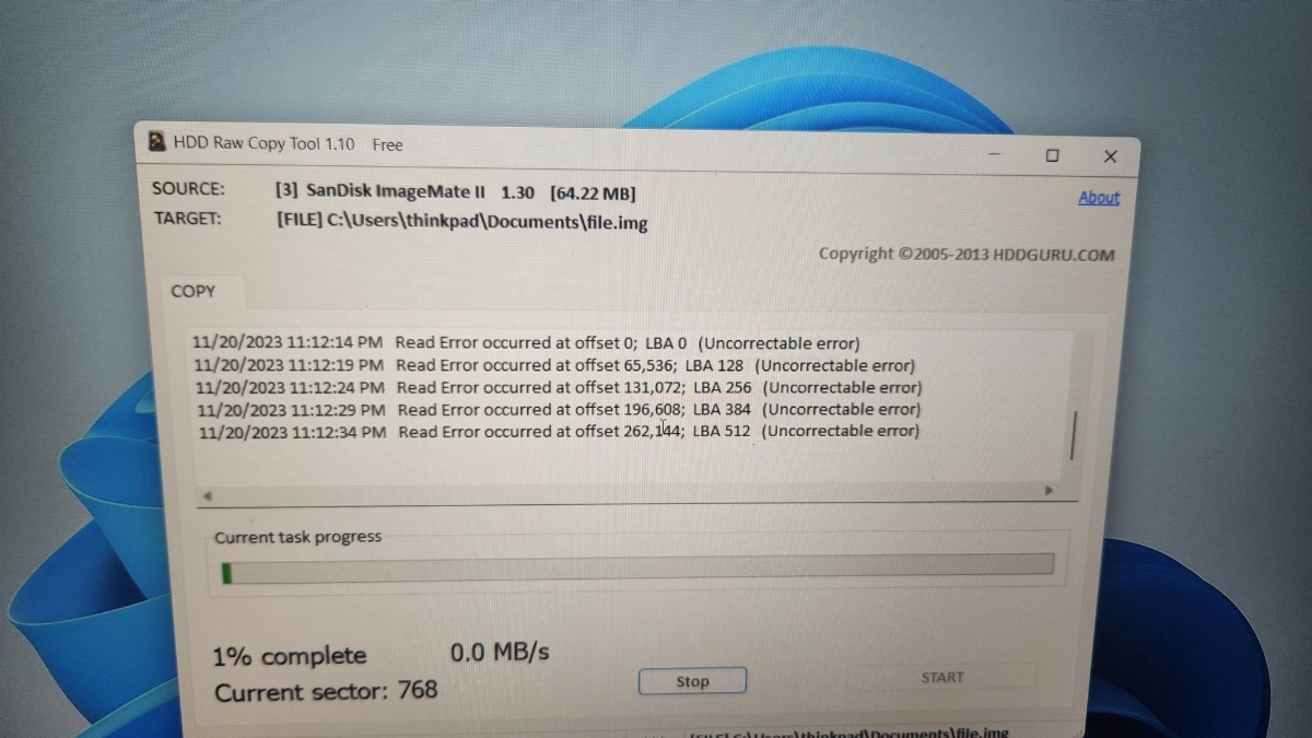

Hi all! i am trying to dump the game otenami haiken FINAL that i obtained.
I used the tool UWB to prevent writting to usb devices on my machine. And I have tried this on two different machines.
However when trying to copy every single block gives an error and no data is copied. I have tested it with other non-aracde cf cards to make sure everything else works.

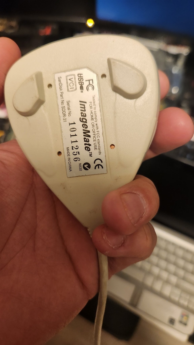

My usb to cf adapter is a sandisk imagemate
Any help is appreciated.
I don't know anything about the dumping process for these games, though I'd suspect that ImageMate device might not be up to the task. A lot of these CF based games require lower level access to the device information that can only be provided by an IDE based adapter as most of the USB devices don't include the functionality for it.
I don't know if this is your problem or not, just pure speculation on my part.

Is there a recommended usb to cf adapter for this task? This imagemate is an older one and I figured it would be sufficient.

That likely wont help. it would need to be a native IDE interface. IDE and CF are essentially the same interface. so your CF to IDE adapter is essentially just changing the shape of the port.
honestly the easiest way to get this would be to find an old laptop that has a PCMCIA port that the Gnet Card can be plugged into directly.

put the CF card back in it's adapter to make it a complete G-net card and it should plug right into a PCMCIA slot, and that will be native IDE.
