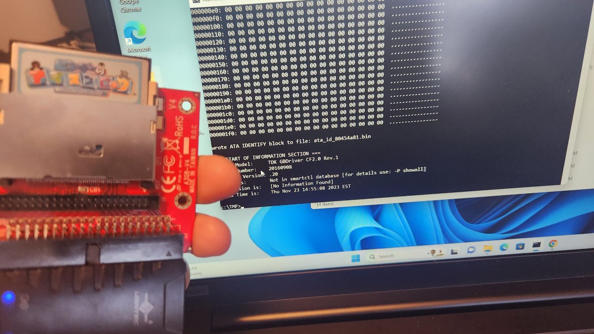

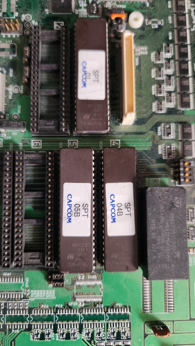

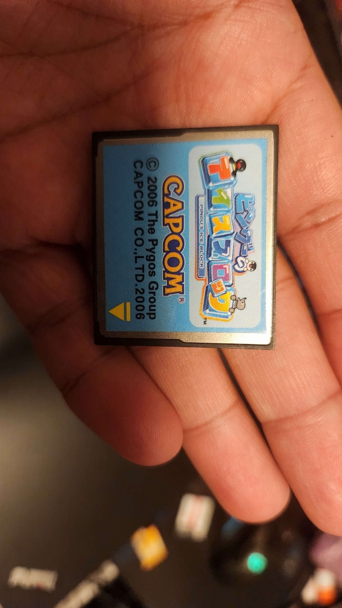

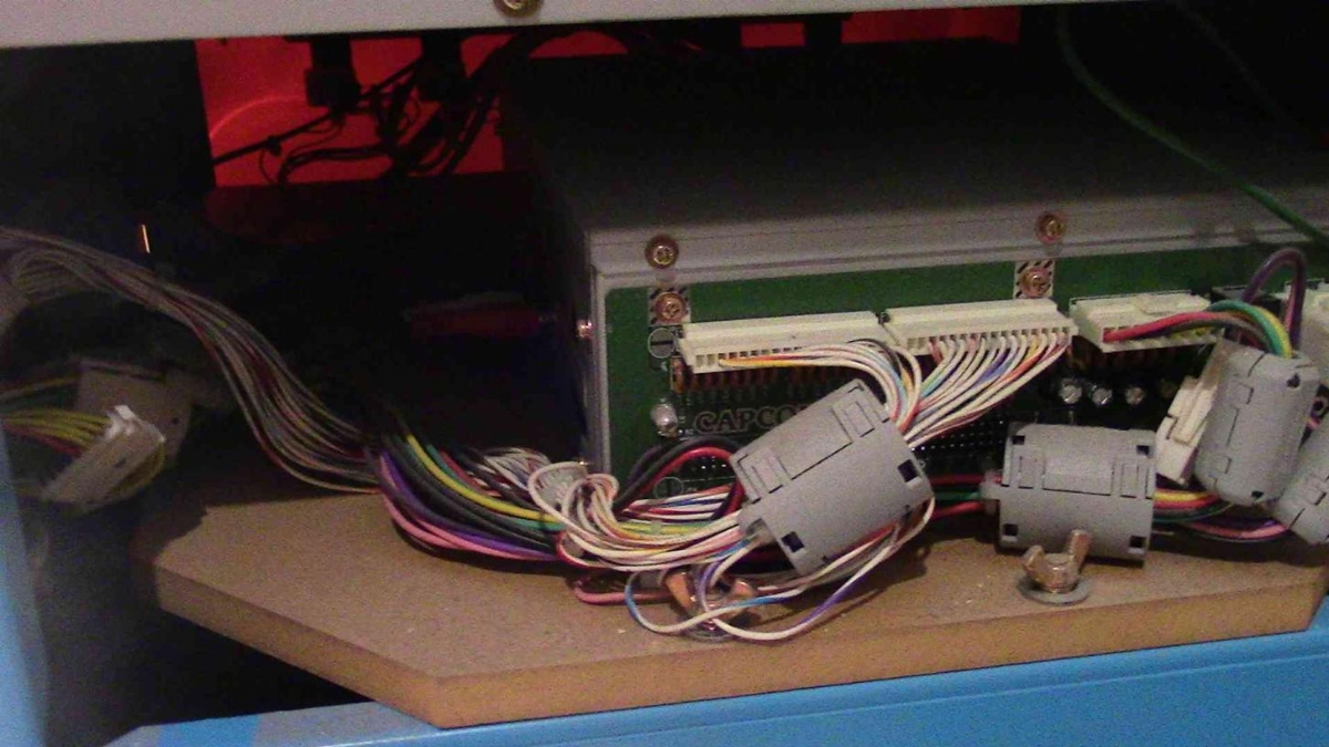

Short and sweet: this game is undumped. Capcom recalled nearly all of them. Information online for what platform this runs on is wrong as evidenced by the actual equipment and my twitter thread.

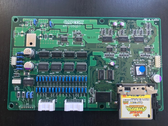

Its a medalusion 2 amt-04054 system with a cf card daughter board, which is unknown until i get to take apart the machine.

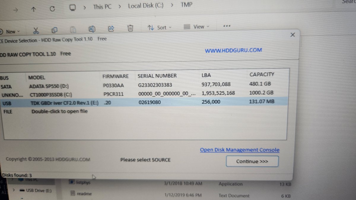

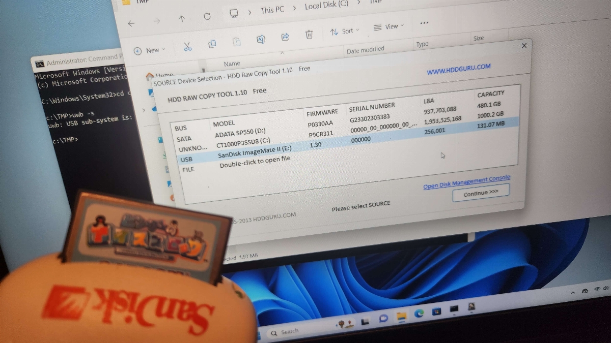

i was given two tools. UWB to block windows from witting to any usb device, and hdd raw copy.

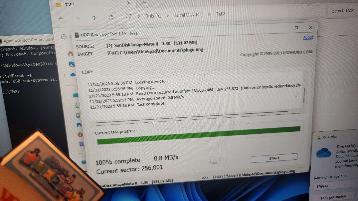

I managed to get a copy of Pingu, another medalusion 2 game, to test.
The dump finished with one error but I think its ok?
How can I confirm this against the existing dump for pingu? I dont think its in a .img format like what i just created.
I planned to use a program like HxD to compare.
