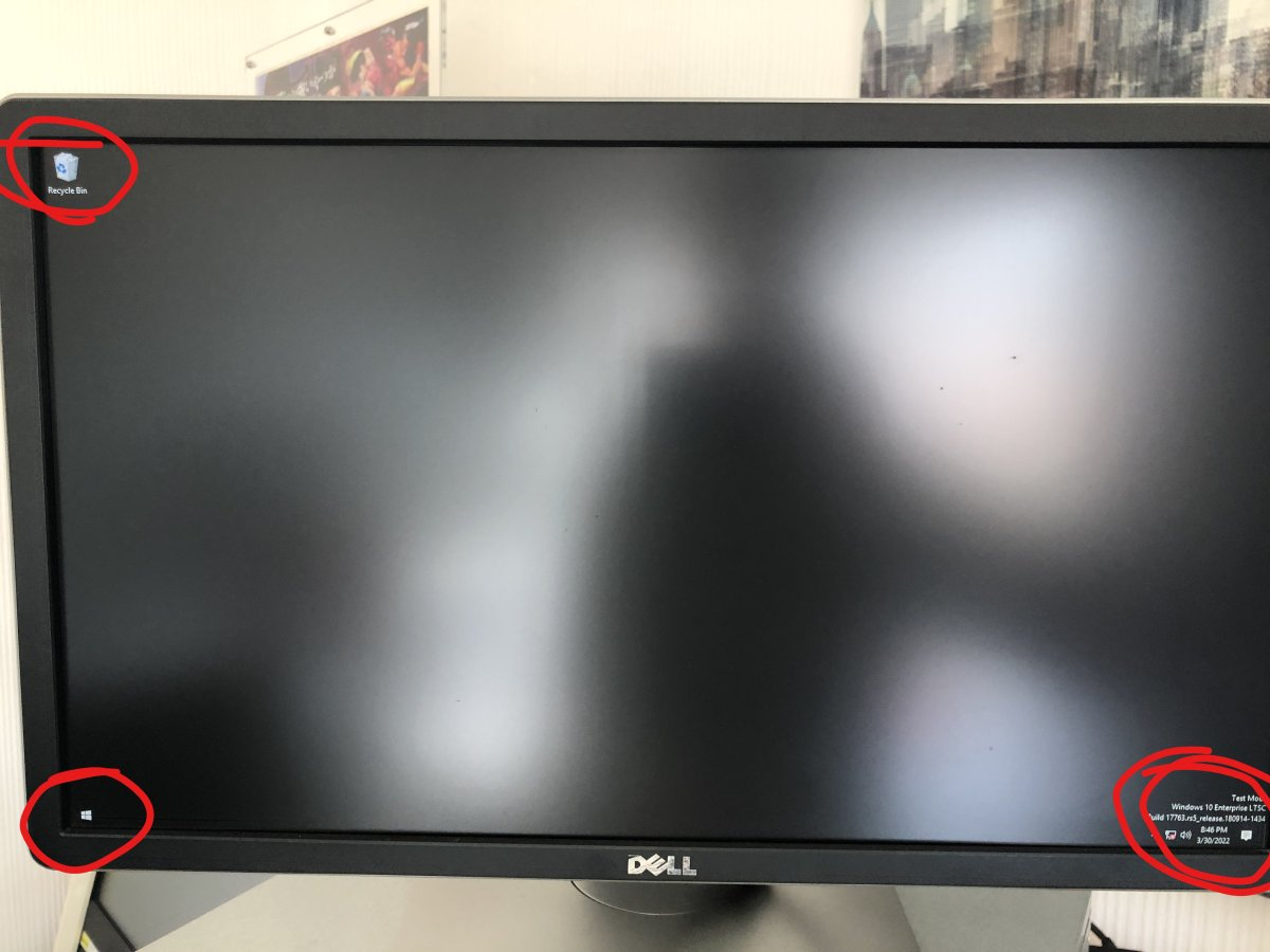

I am not. The screen below is popping up after I launched a game from attract mode, as well as when closing a game.
It didn't do that before.
Try changing your shell app, go into the registry and modify this key:
HKEY_LOCAL_MACHINE\Software\Microsoft\Windows NT\Winlogon\Shell
Change it to e:\system\am\multi.exe and reboot

So I did that and only have a Black Screen and can't do anything again...
@chunksin: Is it me or are you trolling me ?:unsure:
He's not trolling. Just did it and it works fine

Anyway, ctrl-alt-del to run task manager and then select file-->Run new task and type in regedit
Then you can change it

So I reversed everything back to how it was and reversing this step was crutial:
Control Panel - Programs and Features - Turn Windows Features on or off
Add all options in Device Lockdown section and apply
Now the Taskbar and Startmenu is hidden again and also doesn't show up during game launch anymore.
Which I don't understand because the opposite should be the case but anyways i don't want to spam this thread due to my lack of Windows knowledge...
