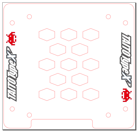

Working on an acrylic mounting plate for my SSD, since I use a taller cooler for the i7 cpu, the OEM mounting bracket that is meant for 2 drives gets in the way so you cant close the lid.
So whipped this up real quick. Gonna fine tune it when I get a moment, if anyone wants I can upload the file when im finished.
Here is how the test cut went, this is a fast and dirty, rushed the paint, etc..just to see how it would look, Im happy with it, will do a few finished for my X3.
here is the file in case anyone wants to mess with it

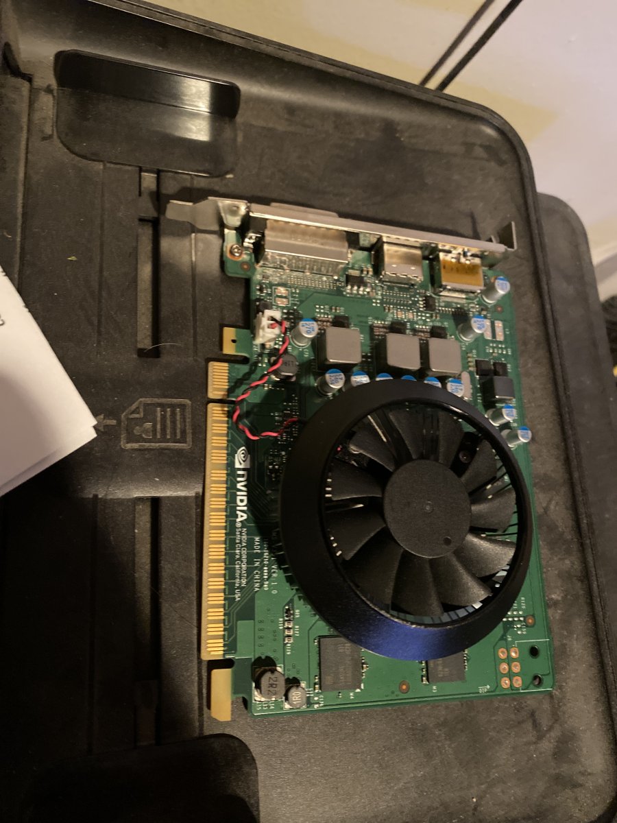

I came across this GTX 1050 would this work well for the multi?
1050ti is about the same as a 680 so a regular 1050 should be a little less than that. Still better than a 660. Will have no problem at all until you try VFeSports, DOA6, GG Strive etc.
