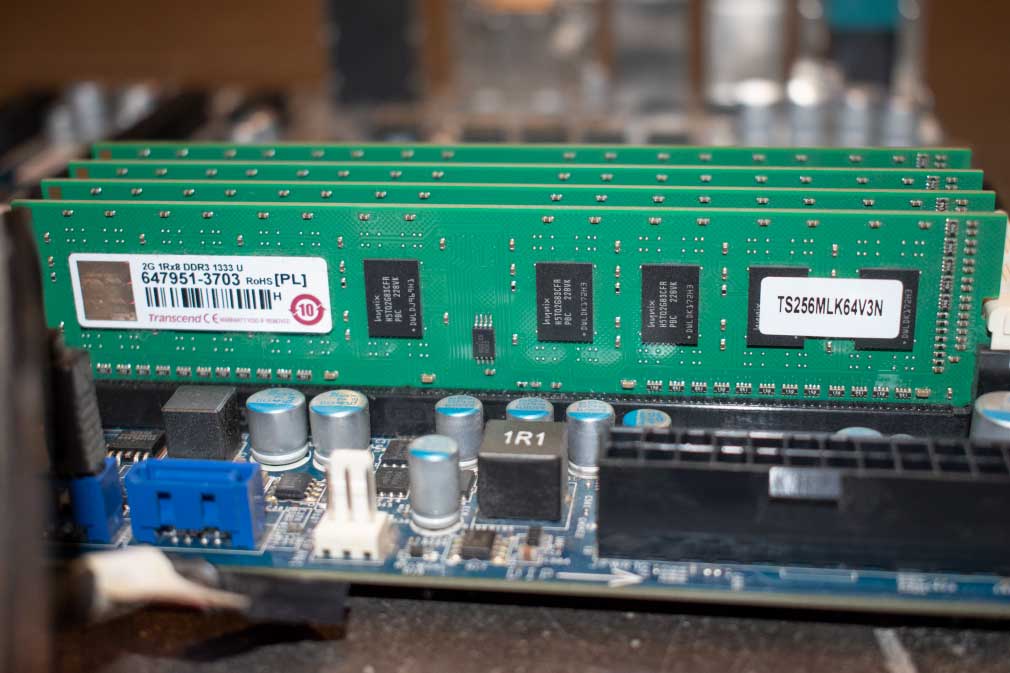

Would anyone help me find suitable ram that can work with the ttx3? Would like 16gb but everywhere I can't find anything to purchase ram.
The same in 4Go
What would be a 8GB per module option?
Keep in mind you'll need to consider if the ram module is high or low density. Although TTX3 came mostly with Intel based Sandy bridge CPU's, not sure if TTX3 motherboards were 40, or 50 series which do not support high density variety, which in turn will not be compatible with later reisions of DDR3 modules that ARE compatible with 67 Series.

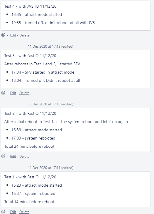

Does anyone have a dump of the earlier b16 or b13 bios by chance? I'm trying to diagnose an issue where since updating my x3 to the b23 bios it shutsdown after about 30 minutes of run time.
I'm running a non-uefi gtx680 and it didn't do this on the old bios :(
Thanks so much Murray!
I think I might have a hardware failure somewhere, downgrading to b16 didn't change a thing.
I had a similar behaviour like that with the original AH multi when FastIO was used and was in attract mode (not in game). I couldn't replicate the issue with JVS though. IIRC it was due to the one of the pins in the header and when it was removed, it no longer rebooted. A newer version of the base windows was then used and no longer had that issue - which I also believe is what's used in the newer multis.
Maybe the base windows from b23 needs to be used so this shutdown issue is not present - I have no real evidence to support the claim though :D
So far I've tested the b23 and b16 bios with the latest multi - fastio only
It will shutdown, not reboot and it doesn't matter if it's in attract mode, in game or even browsing in windows explorer.
I will try removing components and test it, nothing is overheating so I have excluded that as a cause and the power supply is a brand new 650w seasonic.

I just tried the ram of my old PC and it starts, I have not tried in game, I do not have the multi handy.
