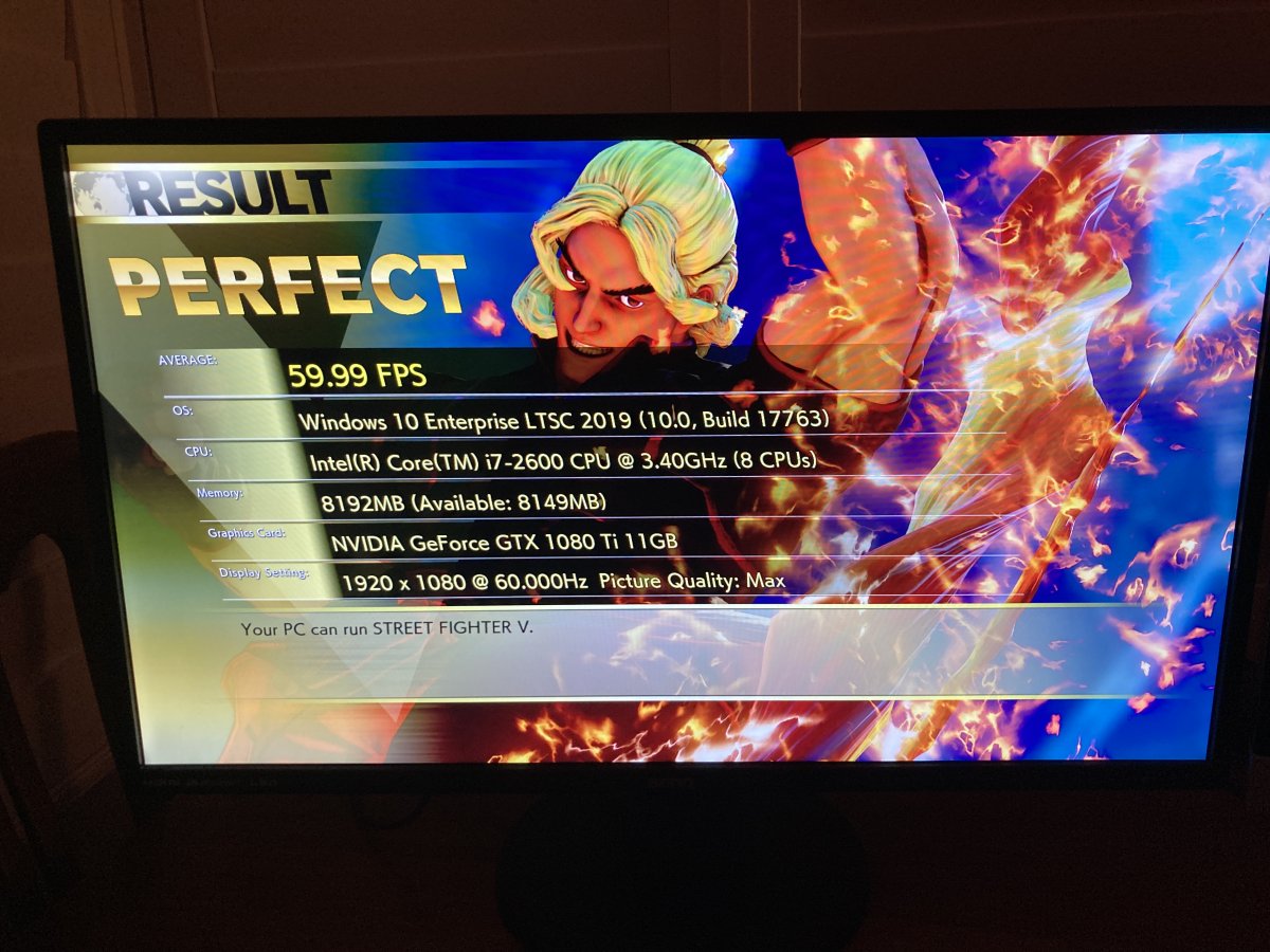

Went a bit overboard and put a GTX 1080Ti in my X3. Photo below is after a couple of hours running the SF5 Test with maxed out settings in the Nvidia control panel.
Upgraded the PSU to a 850w with a power switch. Going from a i5-2400 to i7-2600 did give a slight bump in performance. 8GB of RAM is the max needed for the multi, I actually ran 4GB with no change in performance really.
