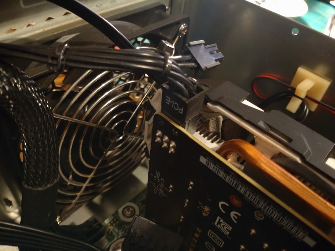

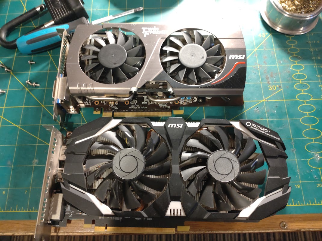

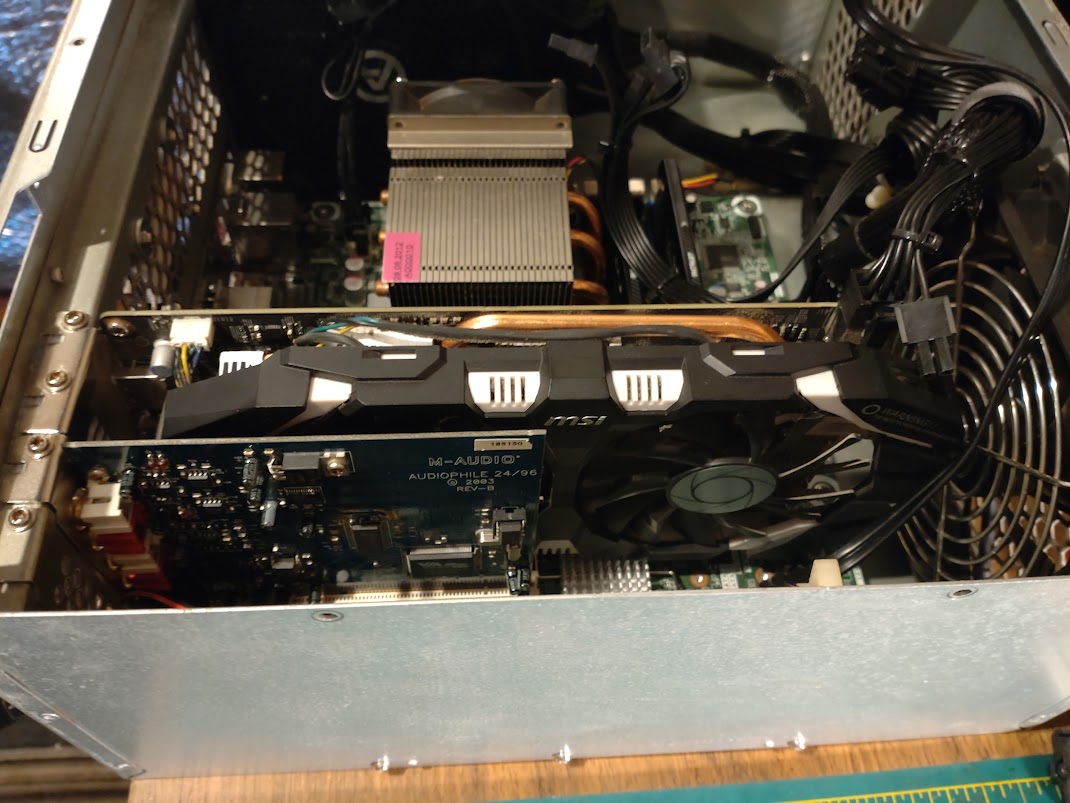

I bagged a GTX 1060 from a local trade-in place called CEX in the UK today so far so good fits good & VF E Sports & Dead or Alive 6 are now working great as the stock 660 wasn't strong enough.
Fits well no slim case fan needed.
