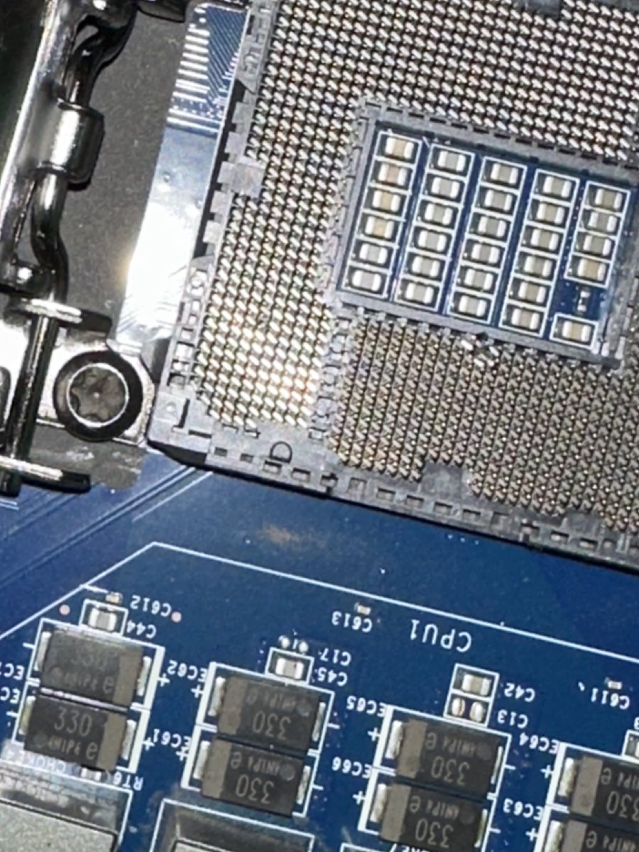

So I was changing the cpu from the i5 to the i7 I accidentally dropped the cpu into the socket area and bent a few of the prongs. Is this fixable or do I need to replace the motherboard? The computer now turns on but red light in back stays on and there is no splash screens, just stays black.
I've re-bent pins before. There is the risk of snapping them, but you might as well try, since there's nothing to lose.
That’s the only option right, or else I will need a new motherboard correct? Where can I find those?
If you are running the Atrax image than any i7 capable motherboard will be fine… probably better.
