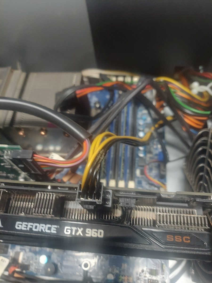

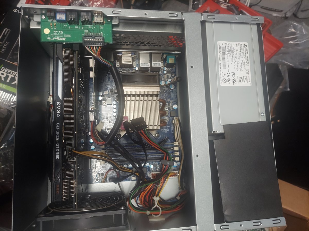

Stock power supply on this one is 600w
How ever it looks like it only has 6 pins connectors for the video card.
A evga gtx 960 fits though 👌
But it has a 8 pin connector 😕
What did you end up doing? New power supply? If so which? Funny I just ordered one as well so now I’m curious as to what I will need to do.

i ran into the same issue. was a simple solution for me though. i had a spare PS from my last pc build. i just replaced mine. But i only did that because i couldnt find my 6 to 8 pin adapters.

Never mind I guess the post after yours explained, get a 6 to 8 pin adapter haha. Thank you
