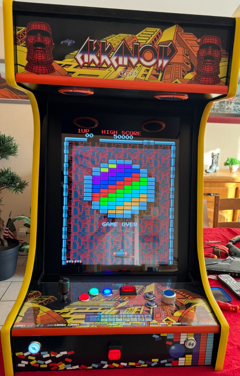

I wish to share my experience with the ULM26 monitor bought 2 weeks ago.
I built a vertical bartop for fun to play arcade games like shoot’em up, Arkanoïd style and Pacmania…
Video out from my supergun is RGBS to VGA with cable I made. I got very nice experience with Arkanoïd : very nice color and good refresh rate with smooth animation.
I tried without issue : Arkanoïd Revenge of Doh, Tournament Arkanoïd, Ghox, Raiden I and II, ST-V Shienryu, Namco System 1 Pacmania, Taito F3.
For testing purpose I plug Cruis’n USA PCB and I got test screen.
But with CPS1 and CPS2, I got no video at all (tested upscaler HDMI with XRGB Framemeister too - nothing on screen).
For now I'm pretty happy with it so far.
