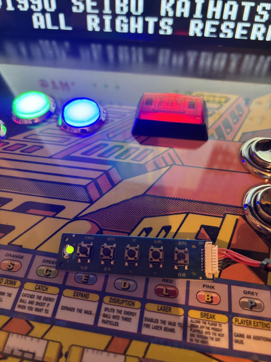

There is a wired remote but short cables. I rewired mine.
Okay gotcha, yeah if it's just extending some wires to make it longer I could handle that as well.
And from that remote board you are able to adjust those settings?

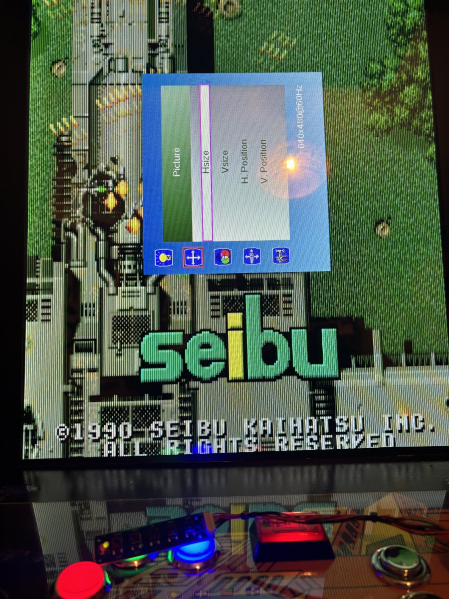

I set full screen by adjusting H size and V size for different PCBs.
For information, I use Retro Scaler A1 to generate scanlines.

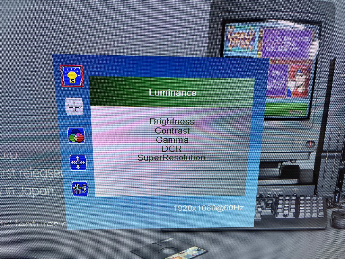

With HDMI, the screen adjust controls are greyed out and not functional. :(
I'm guessing they are for VGA/RGB video only.

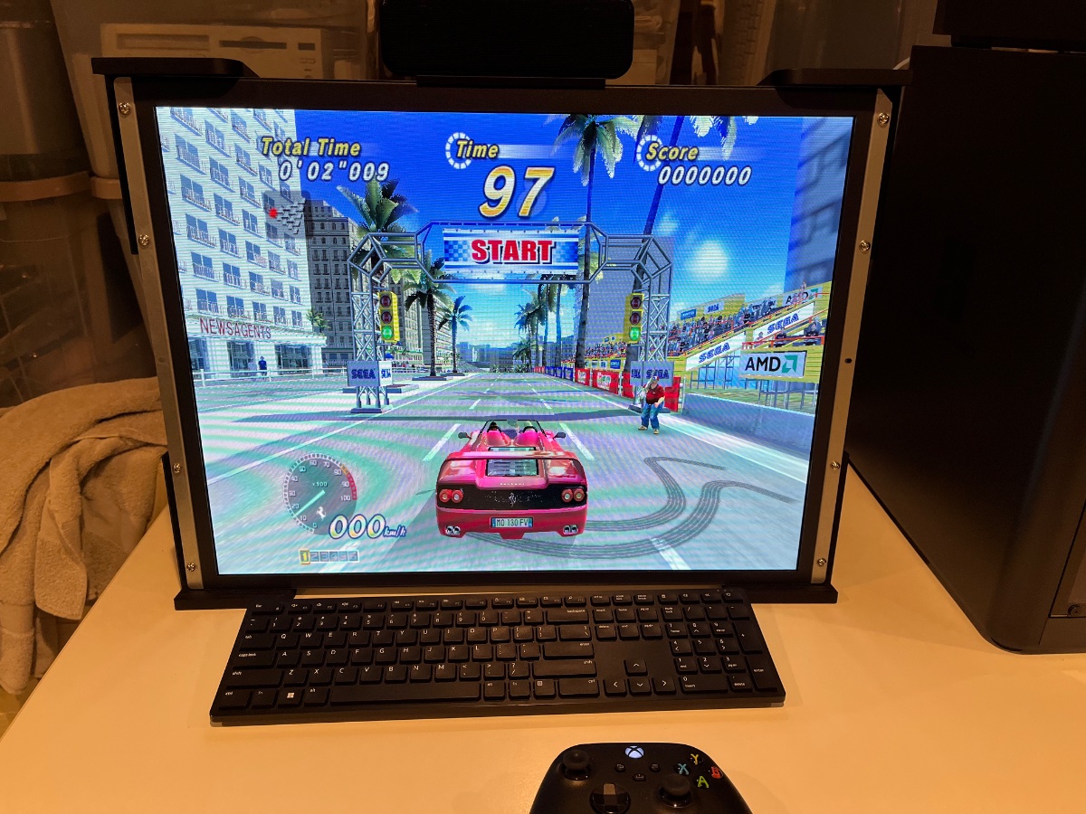

Ya, so here is OutRun 2 SP via the Lindbergh core on Batocera running at 1920x1080. OutRun 2 SP is a 16:9 game. Notice it is tall and skinny.
Yeah damn, if there was a way to squish that 16:9 that would be absolutely perfect for me, as long as it still looked decent (since it wouldn't actually be 1920x1080 resolution).
Quality wise, aside from being stretched out like that, it looks good though.
ya, there's a lot of hate for these monitors and I can see why; they are lo-res and have a janky video board, but 4:3 Model 3/Lindbergh/Naomi/PS2 stuff actually looks really great on them.
