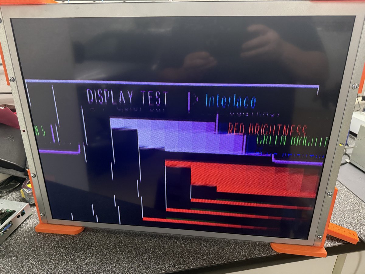

Has anyone else tried interlaced signals though the VGA/D-sub15 port of this monitor? It would be good to know if the new display board isn't able to do 480i on VGA, or if the problem is unique to my monitor, especially since it seems my installation wasn't plug and play like it was for others.
Edit: I also sent an email over to support to see if they know anything, but given past interactions I'm not holding my breath.

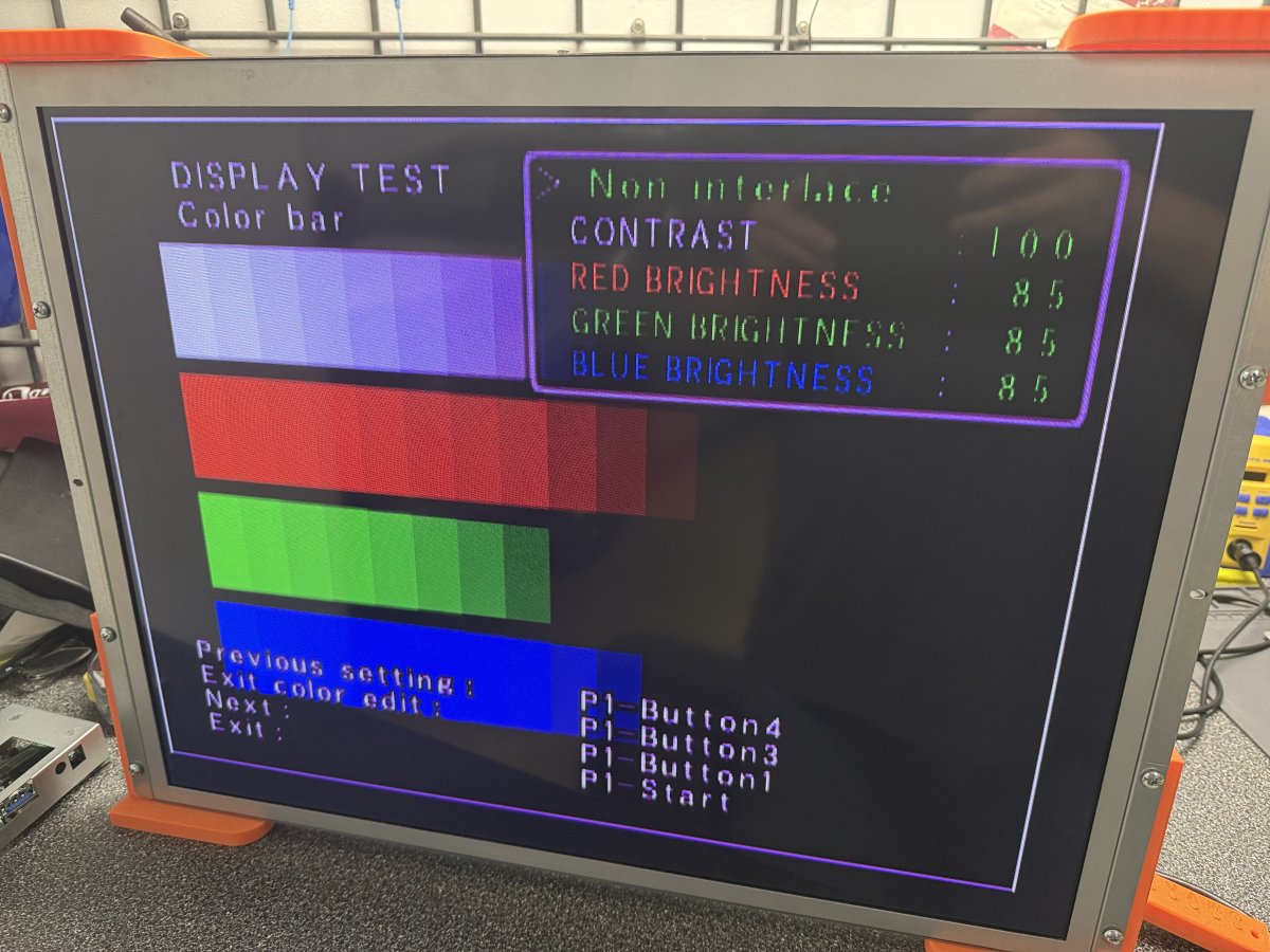

I can try my Namco 246 through VGA in a few hours running at 480i.
Matt
I would appreciate that. You probably wouldn't need to wait for hours. The image becomes instantly garbled the moment I try an interlaced signal. It happened with 2 different sources, which was my MiSTer (PS1), and my Time Sleuth.
240p vs 480i - Namco 246, outputting RGBs over HD15.
480i does NOT appear to work.
Matt

Good to know. Your board does the same thing as mine. Not the end of the world since most arcade hardware I can think of will output both 480i and 480p, but it will be annoying for consoles since there are plenty of 480i games, or games that switch inbetween interlace and progressive video.
That kills pretty much any PS1 based board set as a large portion of those games require 480i: a portion of Namco system 10, 11, and 12 games, some G-Net games, Konami system 573, Maybe Tecmo TPS. Thankfully I think Capcom ZN1 and ZN2 all have 240P optional.
Sega Aleck64 too, probably some others I'm not thinking of.

I've been in communication with Unico's support through email, and they told me that my LVDS cable seemed to be a one off mistake. They also said that they were willing to replace the monitor if I was still under warranty, which technically I am not since the monitor was delivered to me on August of last year. Shame on me for not having the foresight to return the monitor for a refund when given the chance to do so I guess.
They haven't updated me on whether or not 480i is working correctly on other monitors besides mine. They told me in the beginning of the email chain that 480i should be functional, but haven't responded to the images and video that I sent to them after they requested it. I'll upload the pics I sent here too for reference.
If 480i does in fact work on other monitors, and mine is uniquely screwed, I'll be pretty upset if they don't allow me to exchange the monitor for a fully functional one. At minimum I'll raise a stink on social media, but given how crappy their reputation already is thanks to multiple communication and shipping woes, I doubt it would matter that much.
My LVDS connector did not have a missing pin - and I had the exact same results as you did, so I do not believe the monitor to be functioning in 480i mode.
