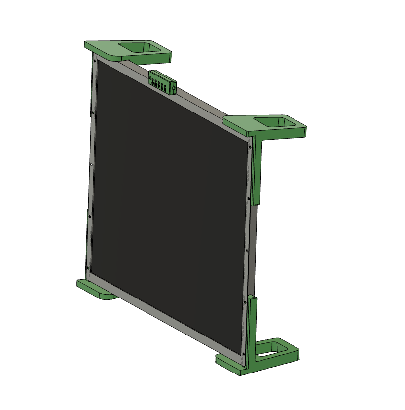

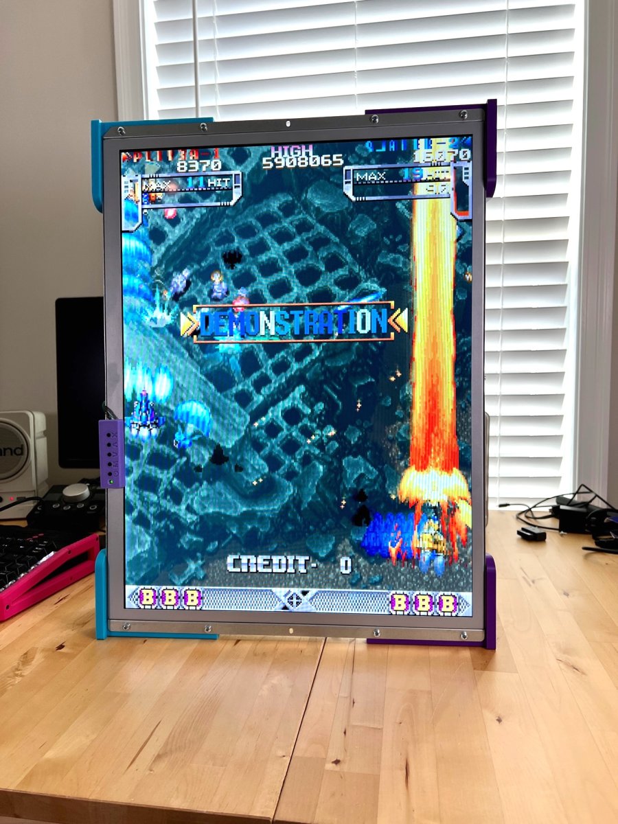

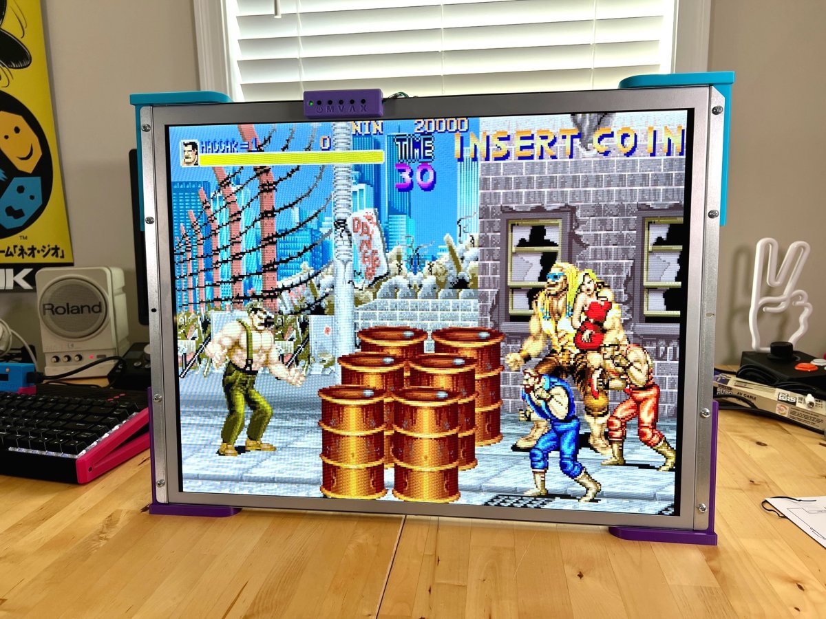

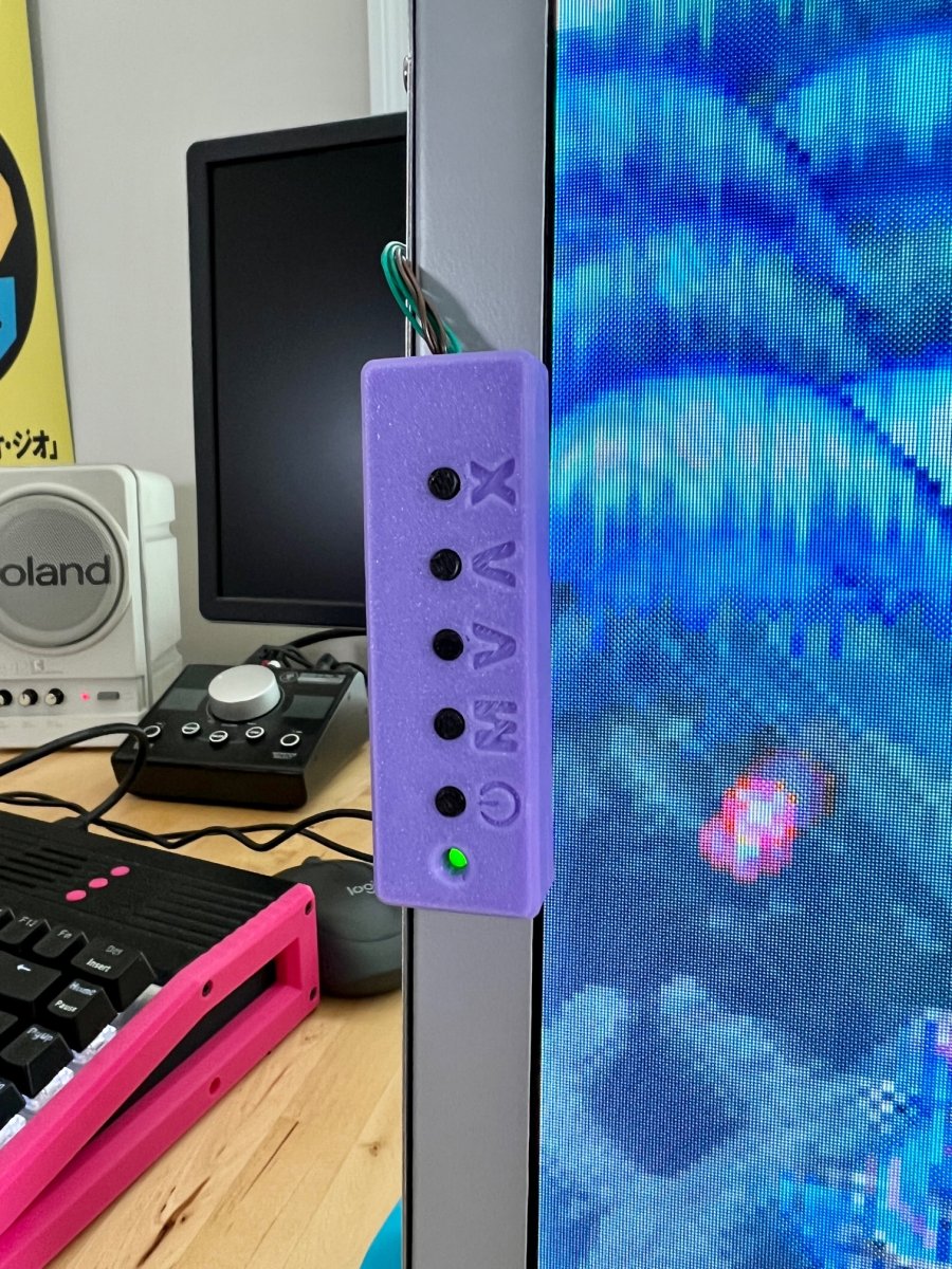

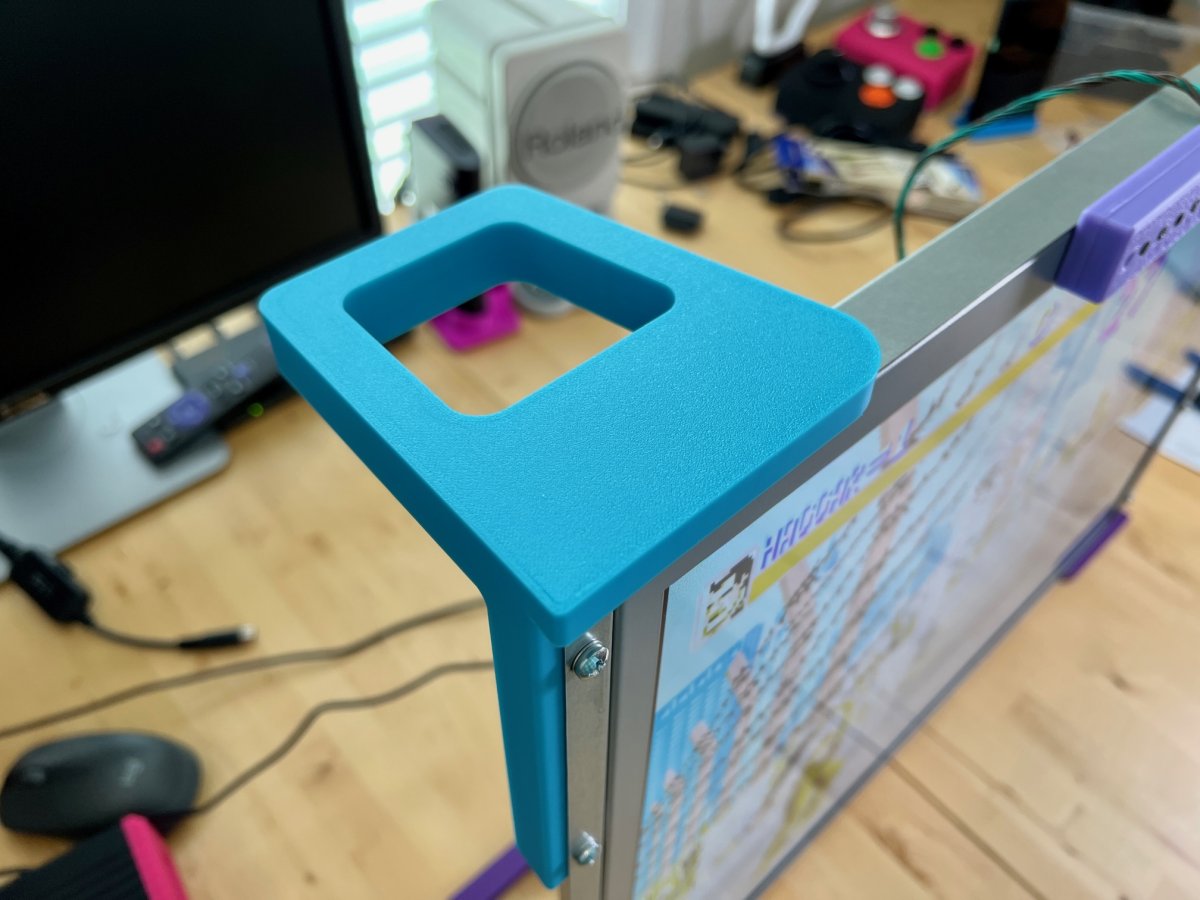

However I went ahead and designed a full set of legs and even a controller board case in hopes they sort out it's color and weird resolution/scaling issues.
Features:
5 degree tilt for better viewing angle and stability.
Large, thick legs for strength and durability.
Symmetrical monitor placement. Place the display on any side - Horizontal and vertical!
Protective case for the control board. Easy snap lock design to protect it and has cutouts on the back for a pair of magnets. Can easily attach the case to anywhere on the metal chassis.
Captive nut cutouts on the back of the legs. No extra tools needed besides a screwdriver.
Give it a download and let me know what you think.

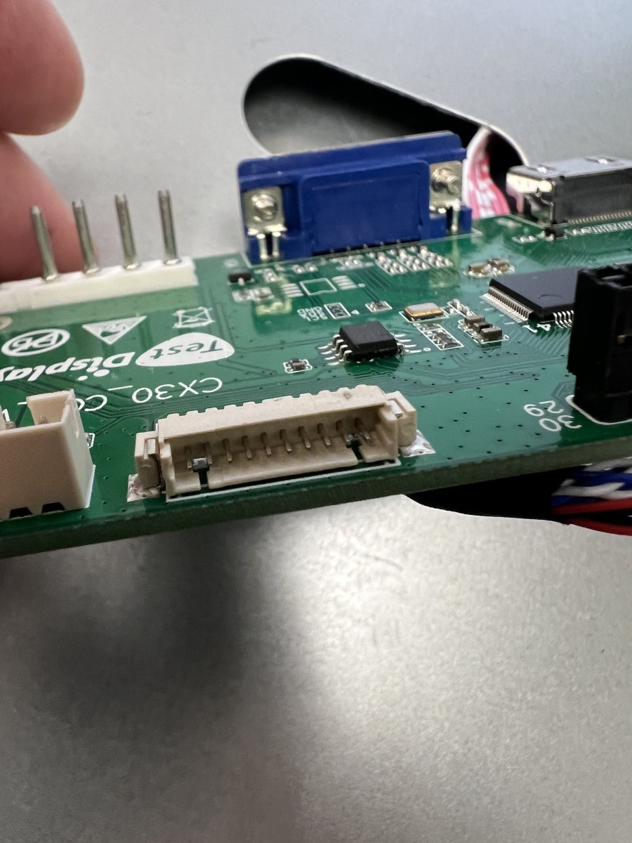

Here are pictures of the connectors.
I am sure its a JST connector? But not sure which.... I also need to take the tape off of the included male to male cable, on the one end, I have an idea there is something there like a cap or a resister inline.
I will take some pictures tonight...
It looks like its 1mm between each pin, and its 10 pins...
I just did some searches for jst 1mm 10 pin 1 meter cable, and came up completely empty. I guess I will have to buy the parts and try to just crimp it myself...
