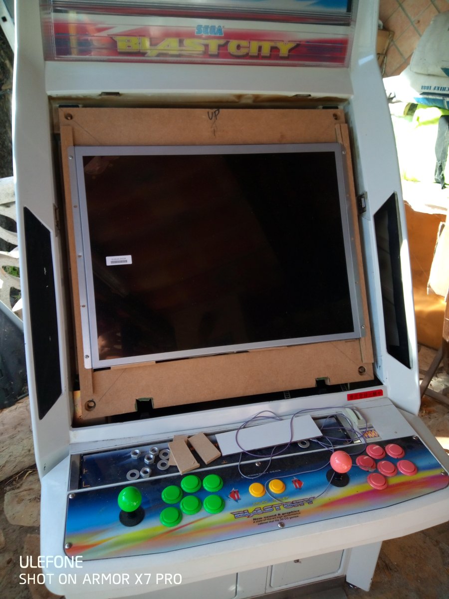

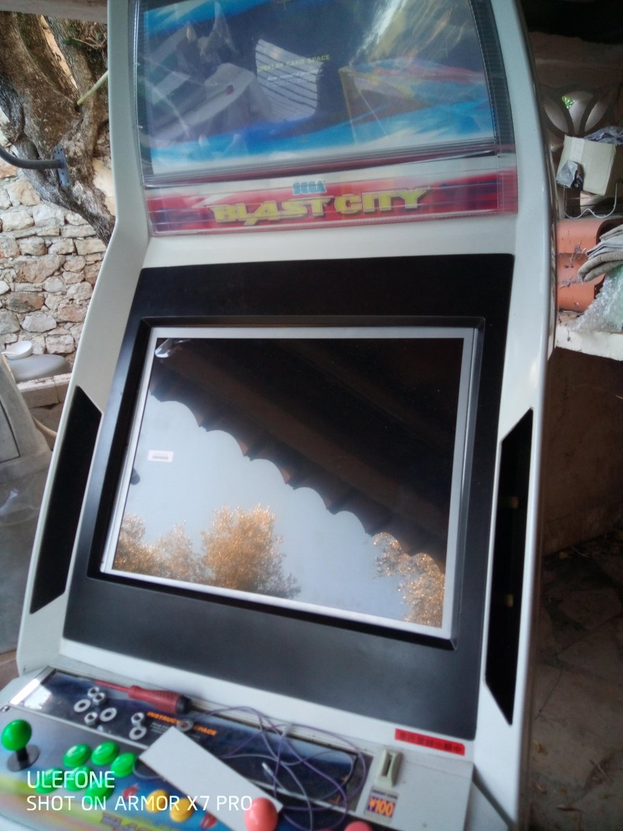

Hello Todd
I instal this screen in a Blast city and i will need a black windows frame to make link with black guenine Bezel .
As i see you get a very good touch for 3D print .
What will be your Idea to get a complete size bezel with LCD screen please.
That's so close! have you thought about spray paint the bezel black? that's what I did with mine.
Maybe buy a 19in screen plastic bezel and cut the outside of the bezel to fit?
Why not adding an other bezel ,i was looking about foam 15 mm wide plate and cut inside a window ,
Any Idea where to found a bezel 19" please

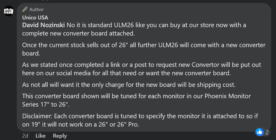

Per their Facebook page, the updated display controllers will be available to all existing owners of the ULM26 for the cost of shipping. I'll dig my monitor out and do some testing whenever I get my hands on the updated PCB.

- Per Unico's Facebook, the new control board has been promised, but it has not shipped, nor will it ship until they clear out existing stock. After existing stock is sold out, then they will ship the PCB to existing customers for no fee (besides shipping), if it is requested. No one in the public has one to test, so it's a guessing game until then. It could make the ULM26 much better, it could also make no difference or make it worse. We don't know.

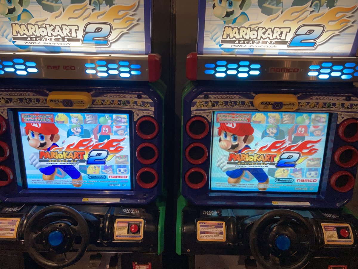

[Unico on left] After much fiddling with settings on the Unico, GBS 8200, and the Triforce CRT settings (did you know you could?), I got the image to look acceptable. I documented my settings soup for Triforce if you need it. Would I use it for raster-based 15k games? No. I fundamentally don't like the look of LCDs, especially budget TFT displays like this Unico. The pixel response also sucks (ghosting). But for a 29" 31k replacement on casual racing games like this, I'll allow it.
