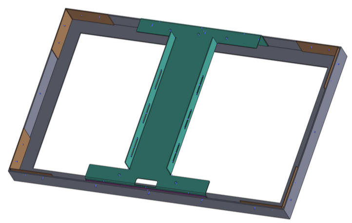

Just to add to the price, 3 parts are required for this design. I initially designed in a single part for a specific monitor to keep low price but figured an universal bracket would be more worth it on the long run.
Update:
prototype is en route.
Usually shipment should be here within a week but can't be sure due to the situation at Washington state. 2 out of 3 parts are already being manufactured. Once the newer design is checked I'll have the last part manufactured. :) Fortunately the manufacture is classified as "essential" so shouldn't really impact the batch.
This new design will pretty much cover all vewlix models. Some models will require a minor modification with a tap bit.
The model shown is for FC (red). 4 corner brackets will be held with L shape brackets.

Once the part arrives I'll report back.
