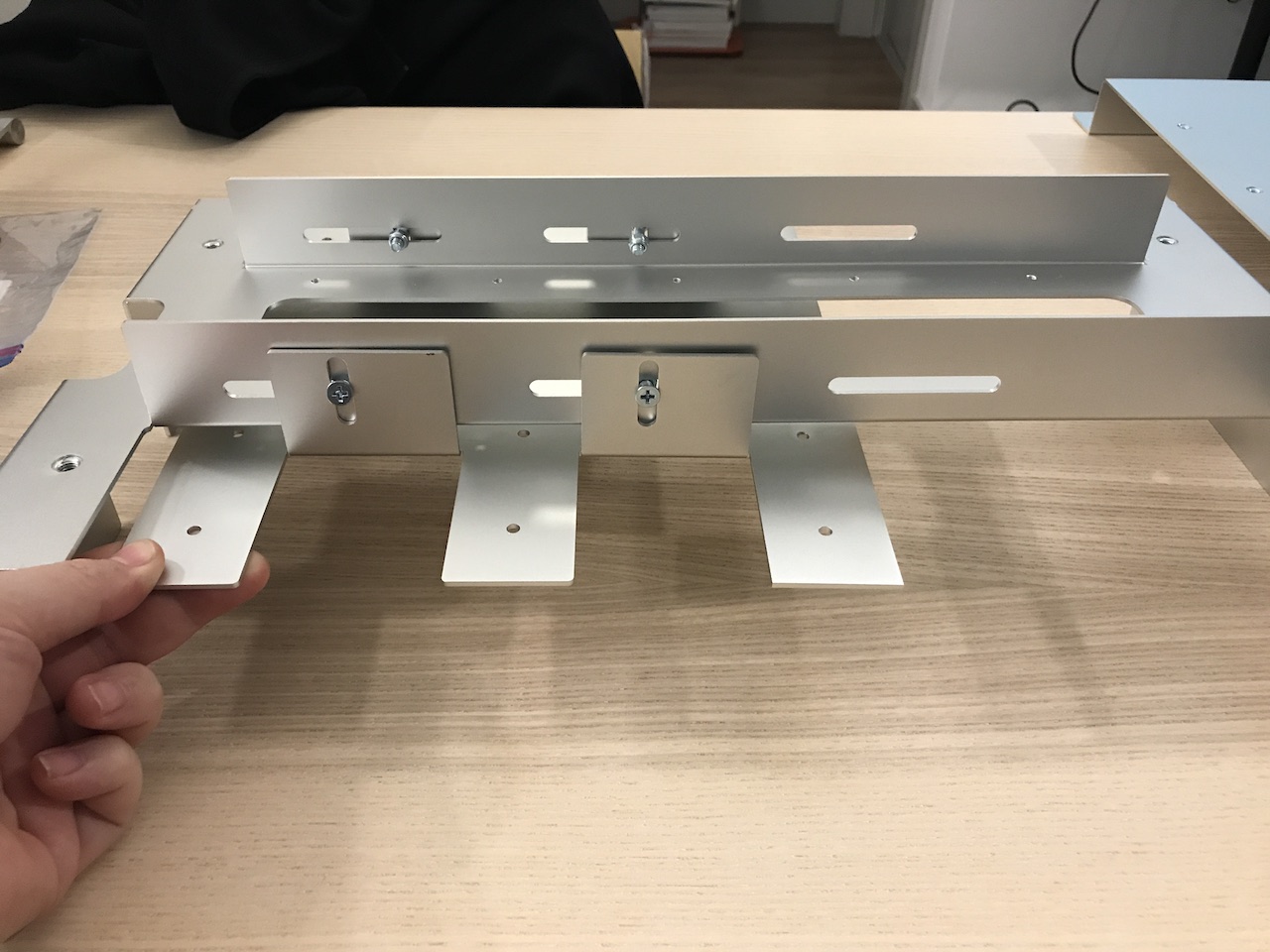

Update: Material will be aluminum instead of steel like last time. This will shred some weight saving some shipping fee. I was told the bracket will arrive at the end of this month. Once I verify the design, I'll get a quote for the price.
Design for other Vewlix models will definitely follow up.
Received the brackets today. I didn't have the necessary screws and etc so I had to improvise for now. Material is aluminum so weight is really light.
One of the major design update is the bracket will be able to work with any VESA location and thickness of the monitor.
Some monitors don't have a flat rear surface. The bracket will always be flat and it will push down the monitor nicely regardless of the monitor rear surface. No more putting spacer and washer between the monitor and bracket :)

After installing the top.
I'll put this in a case tomorrow and continue verifying. Overall I'm happy with the design :)
