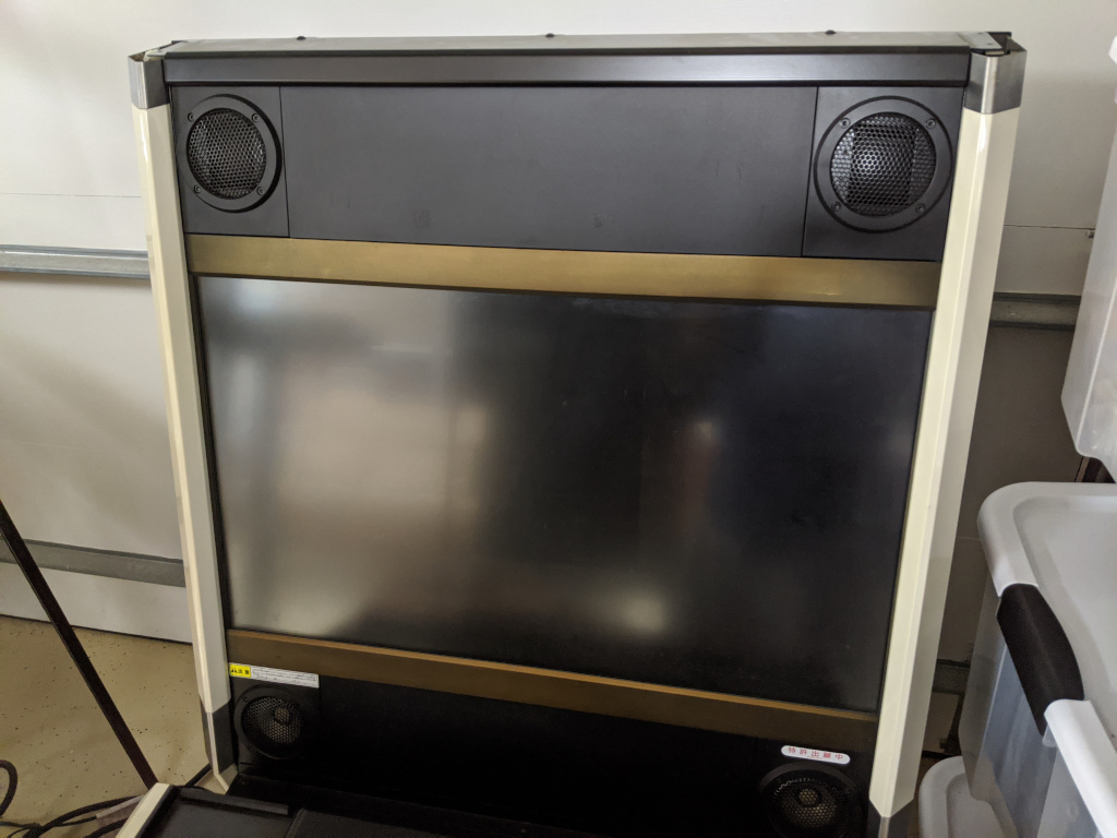

I was just reading some old posts in this thread and it sounds like Hadouken Arcade makes bezels too? Someone painted my monitor bezel gold for some reason and I would love to get a replacement. Is that the same one he makes?
I don't. The bezels are just discolored. Powder coating would fix the problem.
That bezel is discolored from years of cigarette smoke. You can clean a good amount of it off but will not be in like-new condition unless you repaint.
