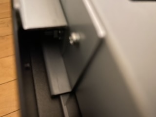

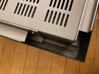

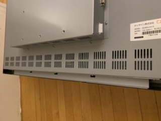

Anybody done this to a Vewlix Diamond Black? I’ve got the monitor off, I’ve unscrewed all the sides but it’s still attached to the frame. Looks like it’s attached to the Plexi inside the frame too.
looks like there are more screws but they are all at a funny angle....
Can you take some pictures?
So I’m not sure what else to unscrew or does it just pull out? Doesn’t feel like it. Just don’t want to break it.

My guess is, the whole assembly should pull out. Try unscrewing the top and bottom. Additional screws could be holding the assembly. The pictures are bit too small. Can you email me with additional pictures? hadouken.arcade@gmail.com
