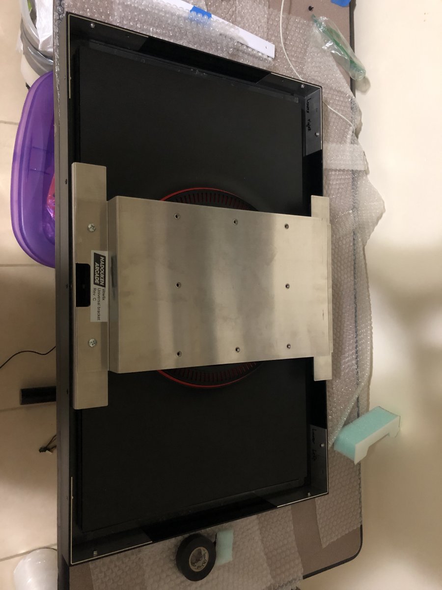

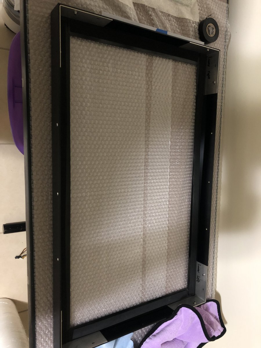

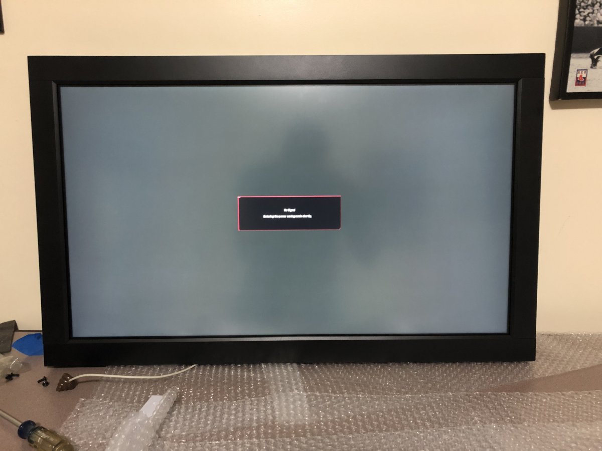

I replaced the lcd on mines here is some pictures
if you have any questions when you doing yours let me know.
Awesome thanks for the reference!!! Did you make your own corner brackets? I added those to my order, basically they're designed to keep the frame together from what it looks like? What about the glass? VewlixFC glass is taped onto the original monitorfairly well haha. Did you reuse yours? Will the bracket allow us to center the factory glass? TIA!
So yes the conner brackets that you order is to keep the frame together, and yes the glass is taped haha, i cleaned the glass and re taped it with new black electrical tape and center the glass.. as for centering the monitor it was actually a bit of a pain lol…. I took some of the foam the bracket comes in and placed it in the bottom conner on the monitor once i placed it on the frame and tighten some of the screw to hold the monitor good and plug in the power and stand up the frame turn on the monitor and see how its placed … if you need to move it from a certain conner then flip it back again un do the screw a little and move it then tighten again then stand it up again turn it on see how it is and ect ect ect lol.. once is good, fully tighten the monitor and place it back on the vewlix

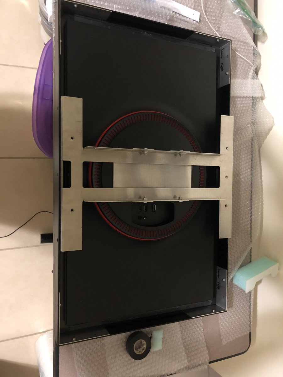

@hyp36rmax I designed these parts, if you're handy with CAD and a 3D printer, you can modify to suit your needs or just print them. https://www.arcade-projects.com/thr...iation-owners-thread.8709/page-70#post-288116
Thank you!! How does this install in the frame?
Thank you! I'm confident for this install now.
They sit behind the monitor, pressing it against the glass. You use the unused screw holes in the frame to hold them in place. You may need to drill another hole or sand the part a bit depending on which monitor you have. Mine is an LG 32GK850F-B.
