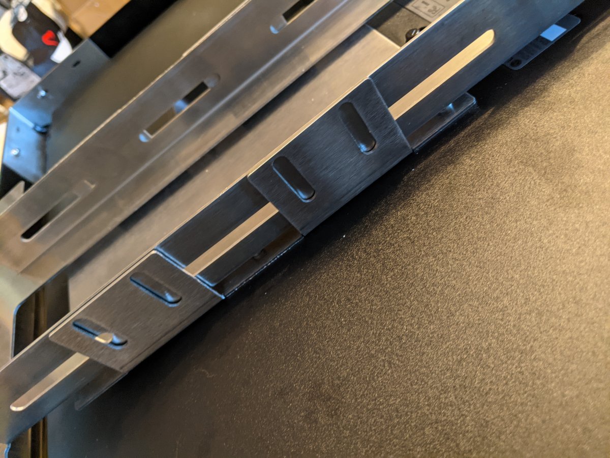

Got the bracket in the mail and got the monitor installed. I'm so happy with how it came out. The glass that came with the stock monitor was hazy and yellow so I went to a hobby shop and got a piece of museum plex to replace it.

I taped the plex to the inside of the frame to keep it from shifting. I used gorilla tape for that. I didn't tape down the monitor. Just connected it to the bracket and the bracket to the frame.

Is the adjustment cutout from the front? Do you have a full shot of this?What jassin said. The glass doesn't really slide around, it sits on the bottom edge fine. Very little movement at all -- maybe 1/8 of an inch if any. With the sealant, it's very rigid, no movement. But I would consider it optional and not really needed.

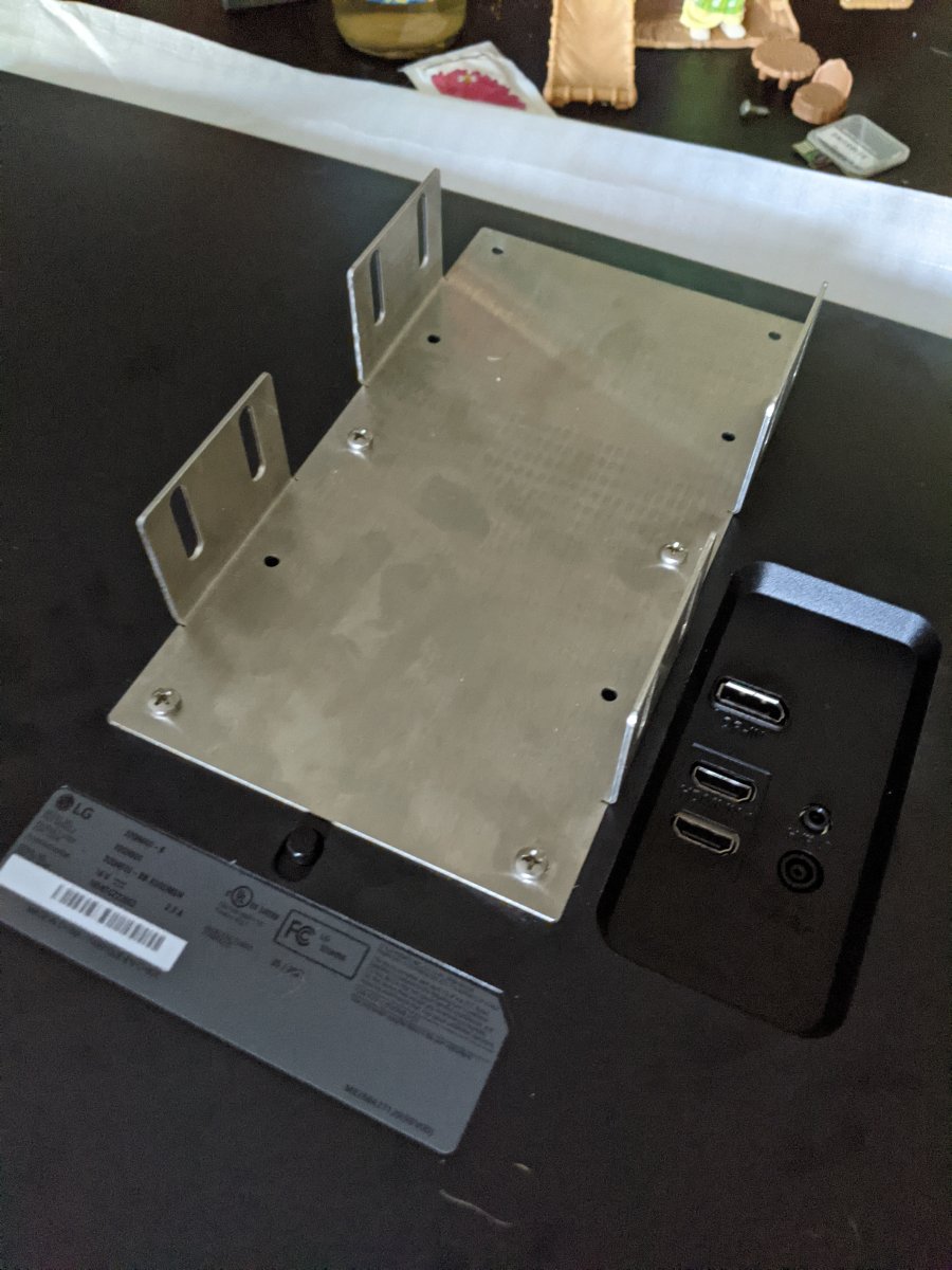

The 32ML600M has it's control under center front bezel. Chris smartly designed the Rev. C bracket to have a cut-out so that you can access the control (see picture). It's tight, but I can just fit my giant fingers in that cut-out to adjust the monitor settings.
I had to downgrade freesync from extended to basic, since Guilty Gear -Strive was auto-swapping to HDR and it looked like trash on my PC. I was able to do that with the cutout, but it was definitely tricky and I had to have a friend read out what was on the OSD.I can't easily take a shot without taking the monitor out of the cab. The cutout ends up being on the bottom back of the monitor (IIRC) and once installed, you can reach your arm in to adjust if needed (with the back of the cab off). Honestly, I haven't touched those buttons in months because once the monitor is set, there is no need to be fiddling with it.
