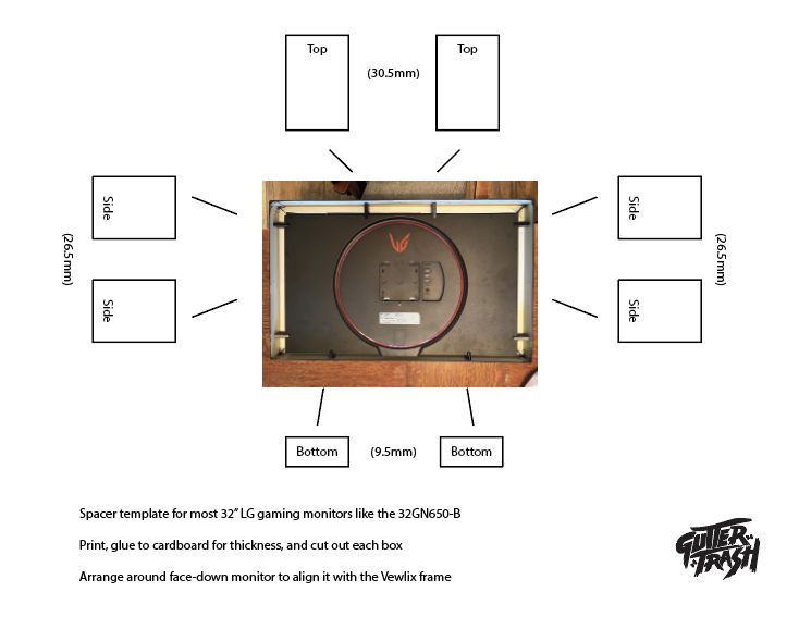

I just made my own brackets instead of buying this, but I have access to tools not everyone does like a laser cutter. I think the Hadouken bracket is still a great idea.

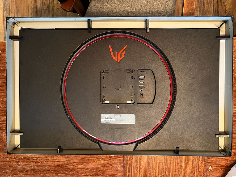

One thing I did as part of my install though that might be helpful for everyone was 3D print brackets to perfectly center the monitor and hold it in place. There are a lot of ways you could apply that idea, even without a 3D printer.
For instance, if you're using one of the popular LG monitors that all have the same basic case dimensions as mine I could make a PDF with spacer measurements that you could print on paper, glue onto a piece of cardboard, and cut out. Lay the cardboard pieces in and use it to align your monitor.
I don't know how the the Hadouken bracket installs exactly, but the way I did it was lay the metal frame face down, put foam gasket around the edge, and then place the monitor face down on that. You don't need to see the front since the spacers will let you align it from the back.
Lemme know if that seems like it would be helpful.
That probably would be. I was lazy in my installation, and while I did have the monitor lined up perfectly, it *can* shift if you don't tighten everything perfectly. Having some spacers to shove in there would probably save some trouble and guarantee good positioning

The included Lego pieces are for positioning but I think monitor specific spacers would be ideal. The only problem is not everyone has a 3d printer or the same monitor. Maybe a series of shims that can be installed permanently would be ideal. I just did mine (again because the monitor was damaged in shipping...you should always turn a monitor on before installing it.) I ended up using the white lego peices long ways, rather than stacking them, to space out the monitor from the top. I did it with the monitor face down in the frame. When tightening the vesa mount to the intermediate bracket, I pressed down on it to make sure it stayed flush when flipped around.

The Hadouken bracket actually uses the 3 middle bezel holes, not the original monitor mounting holes, so I think this approach could still be useful.
Right. For the first part that's why I was suggestion you could make cardboard spacers from a printed template. No special tools needed, print at home or at a local office place, glue onto cardboard, cut out with a knife or scissors. Everyone should have access to that.
The second part is legit, but it sure seems like we're mostly all using these similar LGs.
I made the PDF for everone, see attached file. Here's a preview of the PDF:
