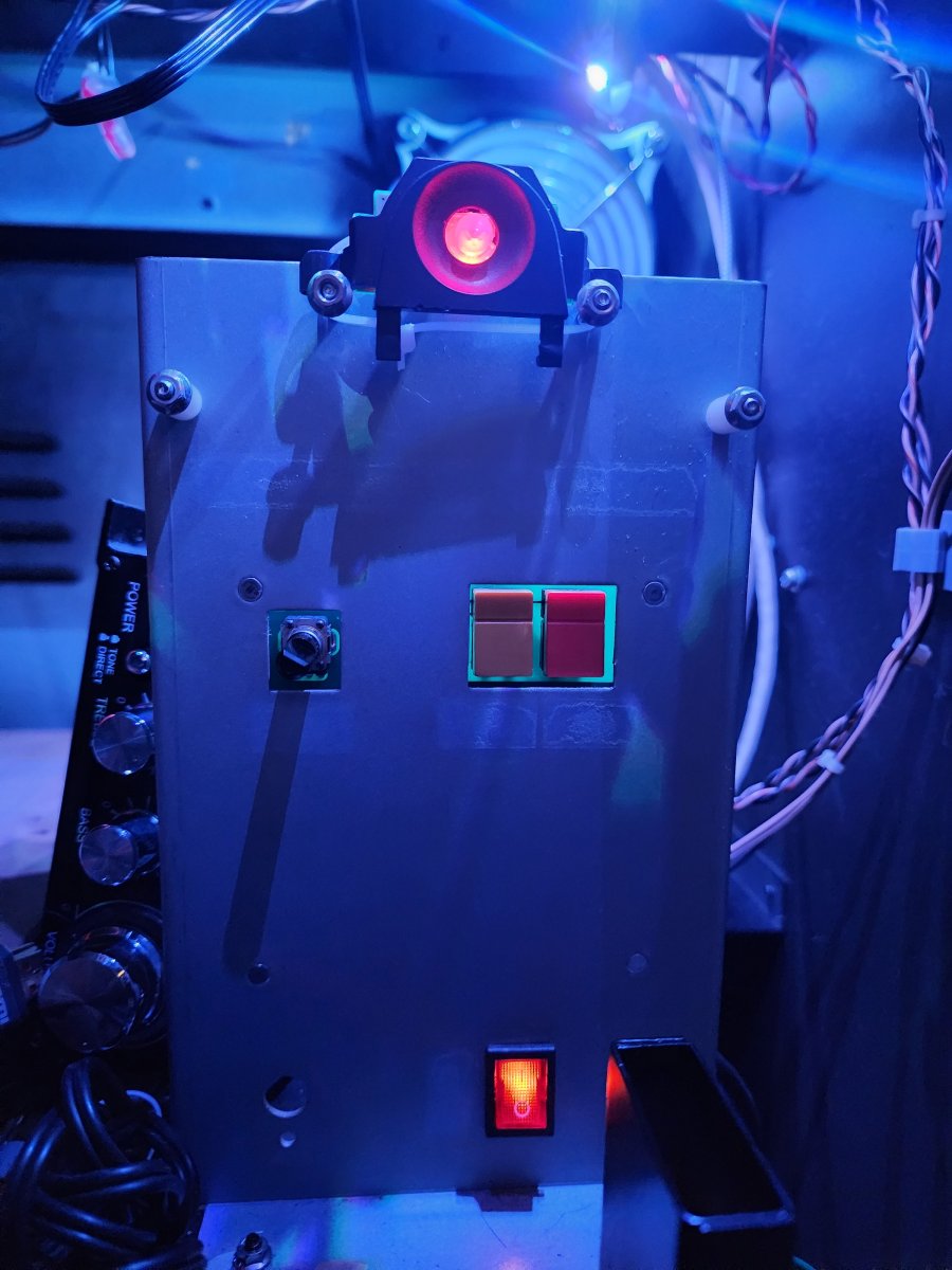

I didn't even use spacers or mounts. I just installed the bracket and it was centered.
I installed mine upside down the first time as well. It aggravated me so much I removed the rear casing of the monitor and soldered in an extension to the little lg nub which now sits where the original vewlix monitor controls were. Pain in the ass but worth it.
I have to admit when I read this post on my phone at stupid o'clock this morning I really struggled to make this image out. I was getting vibes from a Guardian from Zelda BOTW :D

Hahaha I totally see it! I use it all the time. The issue I ran into is the lack of auto switching with the inputs. I didn't even think about that when I bought the monitor. I utilize a display port and 2 hdmi inputs so it made sense for me. Other than that I don't use it.

So I'm a savage and cut the wire and used a cat5e cable to extend it. There is connectors on both ends but I wanted it done now. 7 wires and 8 in a cat5 cable, seemed perfect and works flawlessly.

I can grab pictures tonight but all I did was cut maybe 6in before each connector and solder in the cat5 cable, I just seperated all the prs. Then I used heat shrink to tighten everything up and to avoid shorts.
