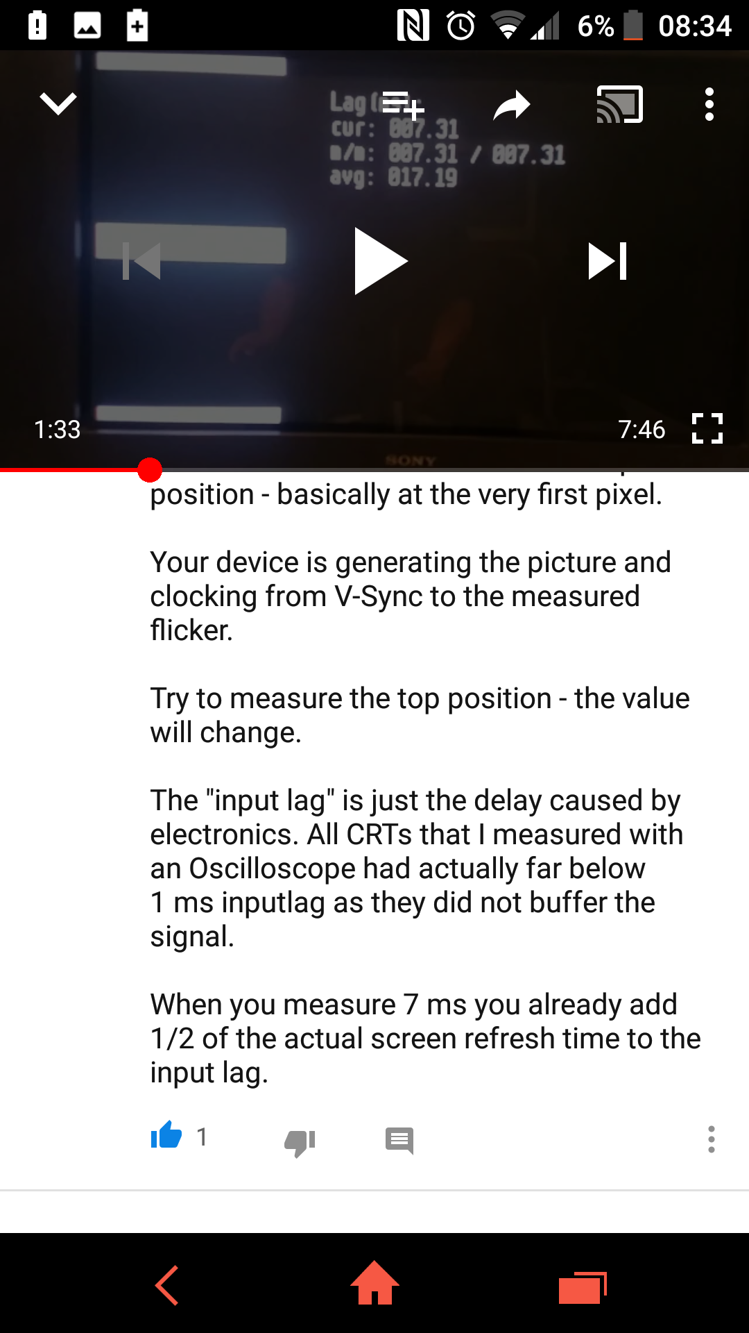

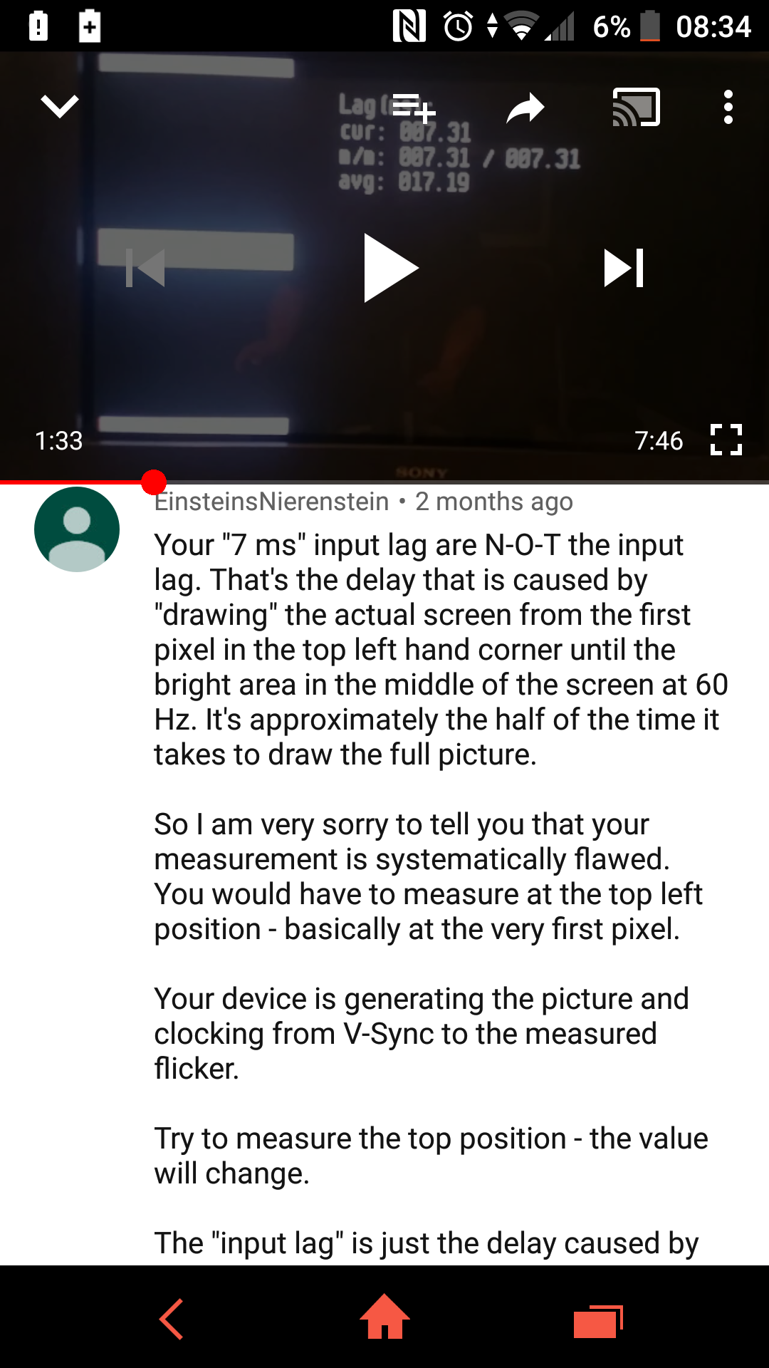

I also got this from YouTube
Don't know if this is accurate
Read my comment above.
Basically there are two schools of input lag measurement. One is measure from the top, because it gives you the 'extra' lag from processing and the screen, vs the standard, which is a CRT. So a 2ms measurement at the top means the screen lags 2ms behind what a CRT would do.
Another school likes to measure from the center of the screen, because that's where we're looking, and more closely represents real world usage. But keep in mind a CRT would give you 8ms at the middle. A frame draw is a frame draw.
It really doesn't matter which one you use, you just can't directly compare the two without noting where the measurement was taken. If someone says I got 2ms at the top, and someone else says I got 10ms at the center, then congrats, you both measured the same lag.
