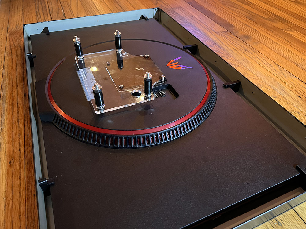

I haven't had time to finish things, I test fitted last night and discovered one of my measurements was off, my M8 bolts are just a little too low. So I need to recut the big clear acrylic part with everything shifted 10mm up. But this is the basic look of it all:

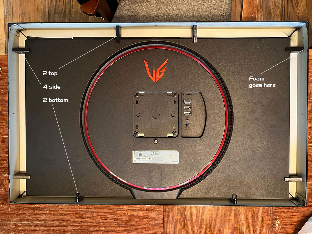

What I did is just not really a 'kit'. I'd be happy to share some files, but you need a 3D printer and a laser cutter, and it's not exactly plug and play. Not hard either mind you. What @ikefc did in the opening post of this thread is actually probably easier for people to do though. I was just stubborn about trying to make my own since I have said 3D printer and laser.

My STLs:
https://drive.google.com/file/d/15Z4bi1mAHdz66phXgZTcYXzid6PsTaNn/view?usp=sharing
https://drive.google.com/file/d/1RhYPtyarAYnX7lvQQbb91k8sRmAqN6dH/view?usp=sharing
https://drive.google.com/file/d/1nfKRmNEM0bcROrBpAY-rcDXZnavAaz-z/view?usp=sharing
They're designed to have 1mm of foam place between them and the side of the monitor frame, and use the stock screws.

Yes, the stock glass is re-installed per the normal method with the metal brackets, nothing changes on the front side.
