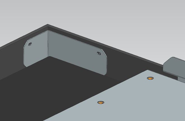

Whilst I was test fitting a kit on @wonderbanana 's Vewlix F I measured up for the corner brackets. Nothing super exciting but this is the L bracket in CAD:

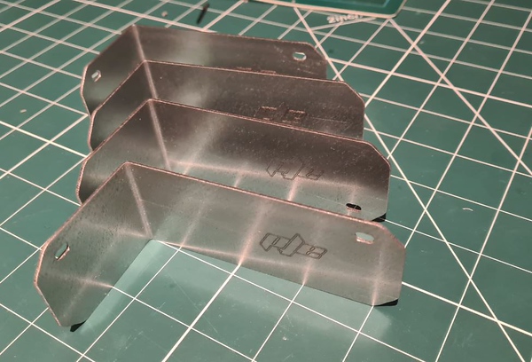

Sent over to my man @Ordyne and precision cut/bent:

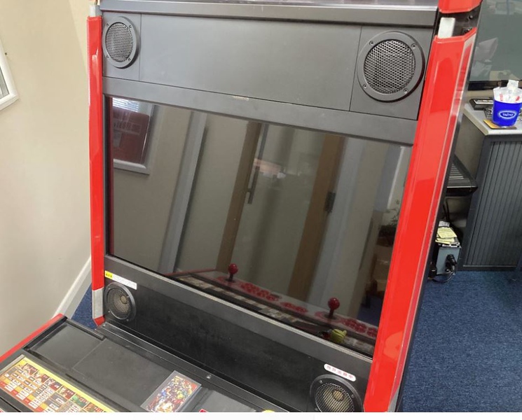

@wigsplitta very kindly offered to help test a kit of both of his Vewlix C and AMI L so I stripped one of my kits from my Dia Blues and sent over to him.

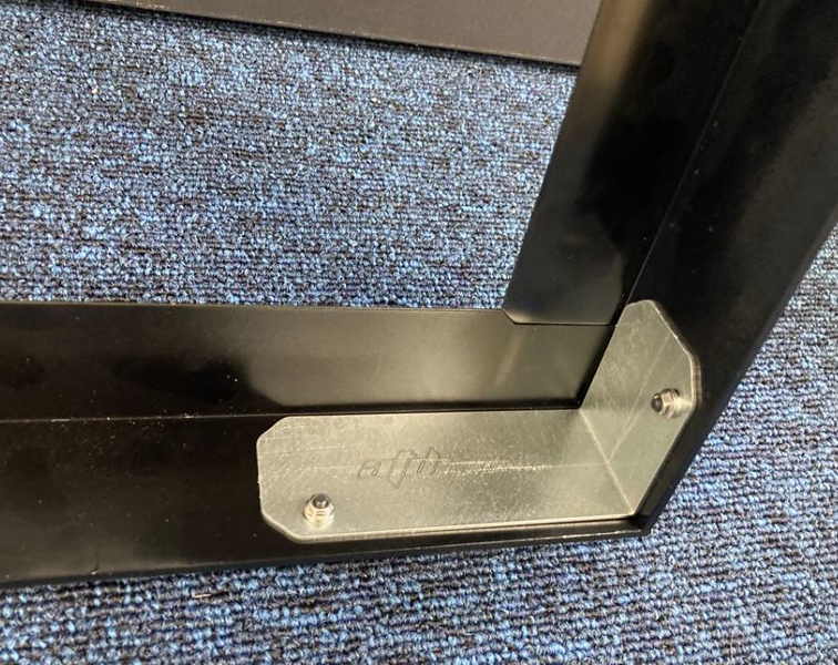

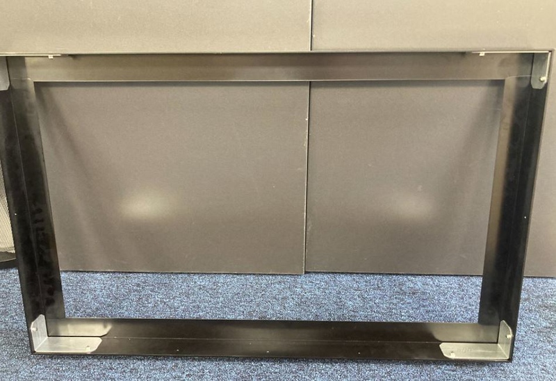

Corner brackets fitted:
One monitor kit fitted to Vewlix C:
Also fitted to his AMI L:

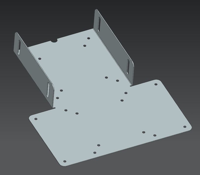

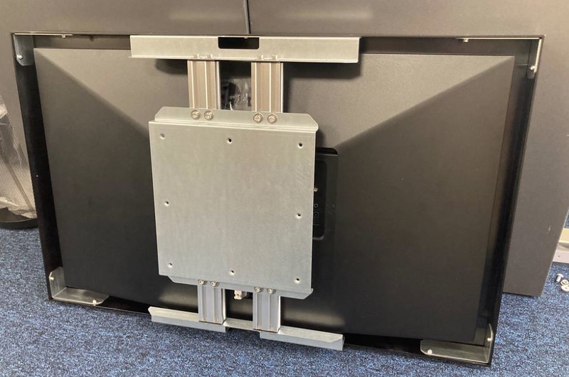

The monitor he was fitting to his AMI L has a 'VESA' spacing of 200x100 which was also offset/located at the bottom of the monitor.. My original mount (selfishly) only supported 100x100 and would not fit his monitor. He managed to get it to fit with some Mc'Guy'vering but I want to make this as universal/future proof as possible for everyone.
This is my current plan for the VESA mount:
This should fit any monitors with 75x75mm of 100x100mm 'central' spacing (including cut out for LG stands) as well as 200x100, 100x100. 75x75mm offset spacing where the mount points are at the bottom of the monitor.. 50x50mm is also an VESA mounting pitch but I can't see that being used on a 32" monitor so I've omitted it unless anyone thinks it's worth adding.

Awesome work as always @FrancoB :thumbup: Thanks for letting me have a test with one of these.
As you've shown, it fitted nicely into both my cabs that had different original monitors and was easy to assemble. No modification to cab or brackets required, very much plug 'n' play which I what I like. The adjustment available for height and depth is great, and allows for a monitor to fit nicely even without the original glass in place (I'll get get round to doing that sometime, probably ;))
The updated mount to accommodate 200x100 looks spot on and will hopefully help to cover pretty much every monitor replacement.
