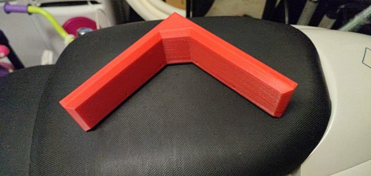

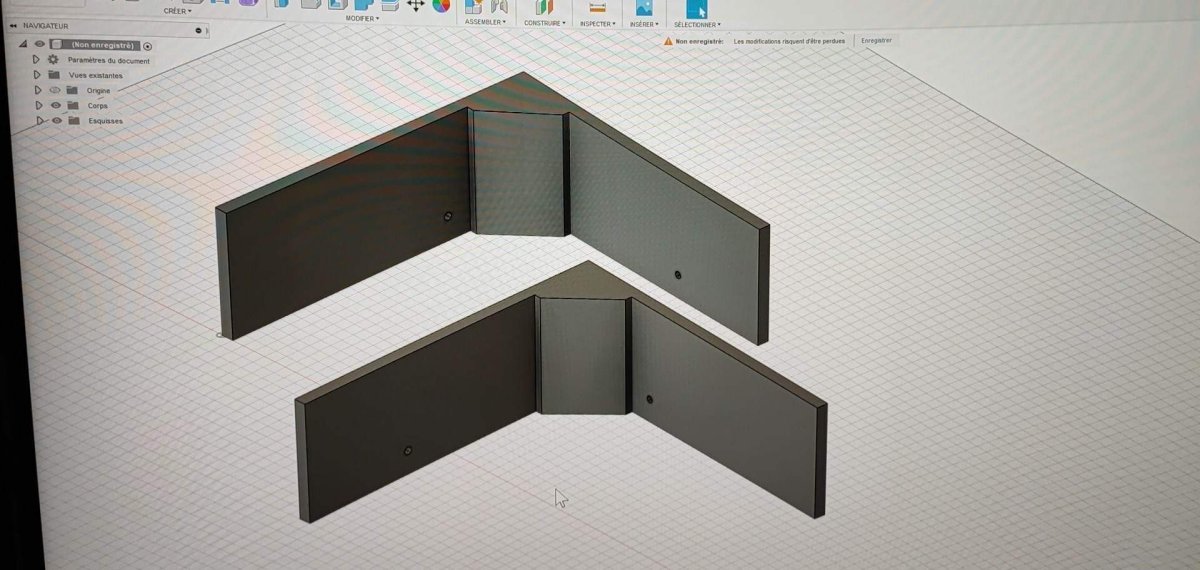

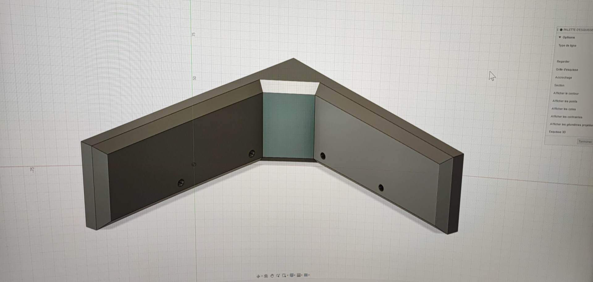

Hi guys , for those who have the TA32Hxx screen ( without the main black frame) , I’m working on the corner brackets (3d printing) and will share the stl files here in few weeks .
Finally it’s not thick enough, so we’re working on another unique model ( 2 holes per side ).
It should look like this .
Will keep you all posted once printed and tested , but for sure some longer screws will be required ( I guess it’s M3 models)
Edit : printed

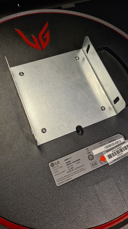

Whilst I'm here, my previous plan was to make the monitor>cab mount in [this post] to get my cabs up and running and then pickup work on the universal mount later in the year. Rather than do the job twice I've decided to do it properly once. I've stopped working on that design and i've instead been focusing on an all metal mount and I'm just going through the design with my fabrication guy.
I'm going to make two mounts for myself and couple of mates. If you are interested @Exroath or anyone else then I can look to get some additional ones made. I'll be shipping from the UK so it might only be suitable for UK/EU guys but the design should make it fairly easy to ship. I'll most likely stick up an interest check thread soon to see if anyone wants one and/or is interested in help testing/developing the first version.

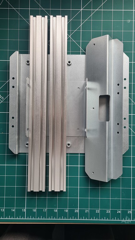

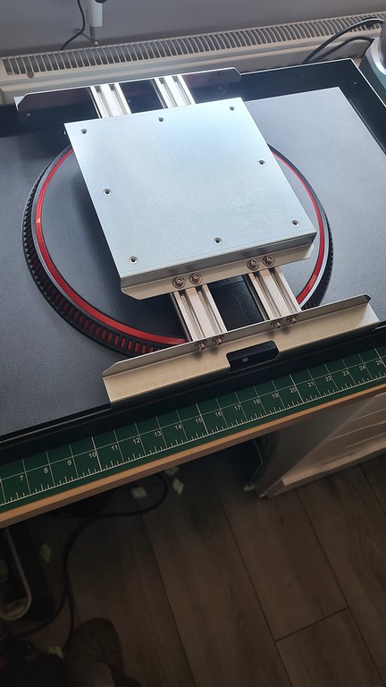

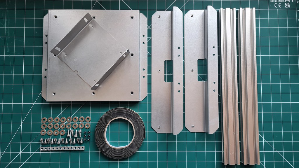

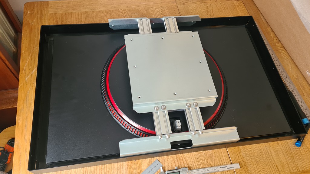

I've spent a lot of time on this recently but I'm really happy with how things have turned out. I got a design made and the legendary Craig @ atbfab.com fabricated the parts for me. I've had a few internal revisions and two production visions but this is where I am currently:
I've used 2040 aluminum section for the cross bracing as it's really strong but light. It also gives lots of bolt/clamping opportunities on all sides/ends.
This also makes it a modular mount so it's easy to make any future adjustments with out redesigning/manufacturing the whole thing and it also means it can be compactly packed for shipping.
PEM self-clinching nuts are used throughout. No drilling required.

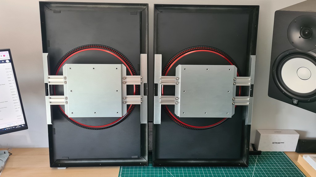

Fitted to my Diamond Blue frames and LG 32GN550 displays:
I've also been working with my good buddy @wonderbanana during design. I took the third kit to his and we successfully fitted it to his Vewlix F and his LG 32GN600B (with the ridiculous protruding stand mount)
I measured up for the required corner brackets whilst I was there and I'll sort him out with a set of those too.
I've got a few more things to sort out and I'll then see if anyone else could use one.

The quality of this kit is INCREDIBLE, I was absolutely stunned by the attention to detail and how easy it was to assemble.
Amazing that this can all be done without any drilling to, so if for any reason I want to go back to stock, I can.
Over the moon with it, my cab is finally how I want it. :)
