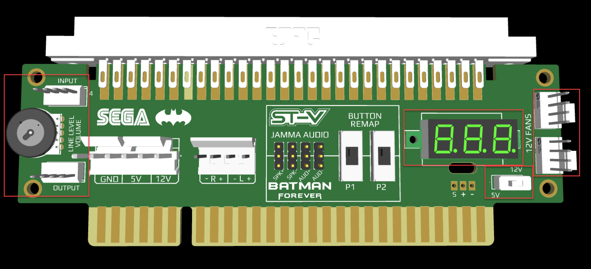

I have a test PCB of the original layout, and the fitment was great, beveled edge on the goldfingers was pretty good. Everything was as expected.

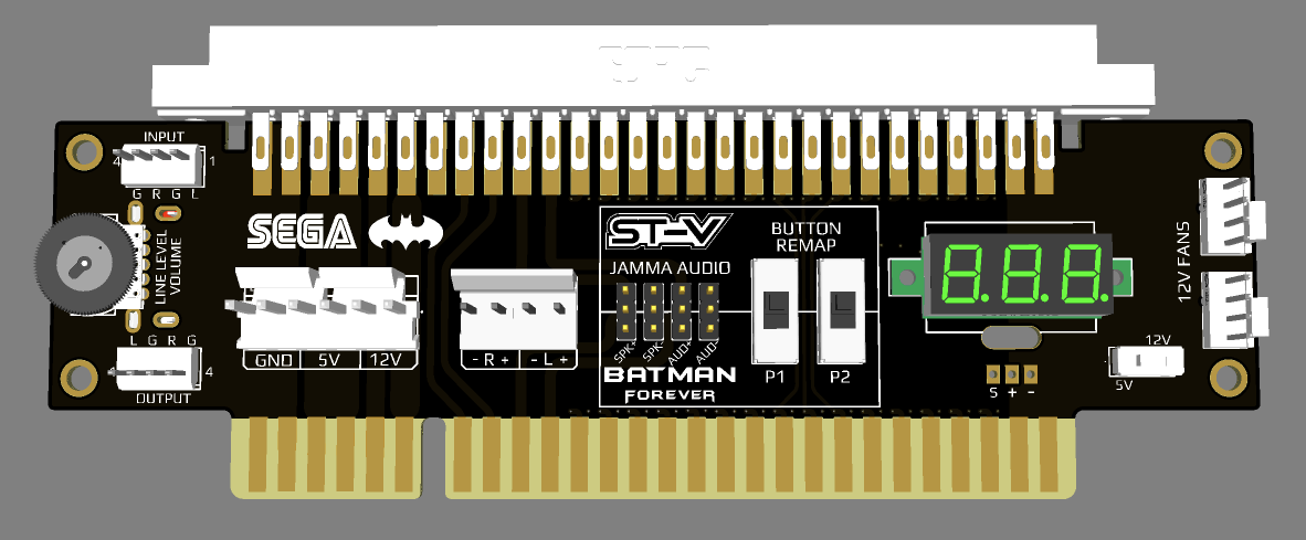

After chatting with Mitsu we decided to make some changes, here is the new board layout/setup:
  • add an optional line-level audio control thumbwheel pot and in/out headers. This is for the cabs with amps that don't have volume control. It's meant to take the line-level audio from the Batman soundboard and then feed that to the cabs amp.
  • Fan headers have been moved to the right side of the PCB
For those that want the volume control option, do you want rca jacks? I can try to add those.
These are completely optional, the items highlighted do not need to be installed for the board to operational and you can save a few dollars.
The, P1/P2 slide switches while fully functional, do not have a satisfying click/feedback, they just slide smoothly to either position. I will try to source a different switch if I can because I want that click :D

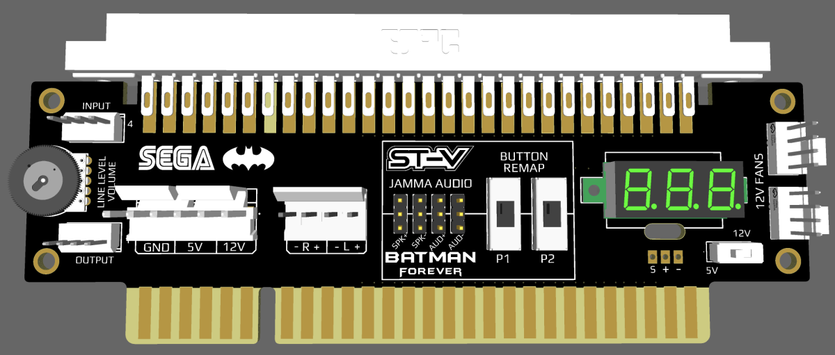

But. the PCB is ready to be ordered. I'm thinking maybe a green color with gold enig to match the STV mb? or do you guys want black/gold? The black and gold will cost a little more and take a little longer to fab, though.
I will tally up the costs of the PCB and parts and put up a list ASAP.
@Mitsurugi-w will be offering these for sale assembled and/or as kits, his choice. There will also need to be some harnesses made up.
Lastly, @plasticfactory will be getting the latest iteration of the PCB ASAP so he can finish up the case he has been working on, I can't wait to see what he comes up with.

Added an extension header for the volume pot. Again, you only really need this if the amp in your cab doesnt have volume control or you want to control volume from somewhere else.
This is an easy add to the PCB. Sorry I can do the button remap as an extension, etc... just doesn't make sense as Im trying to keep the cost the pcb/components as low as possible and there technically are other adapters to handle button remapping already.
