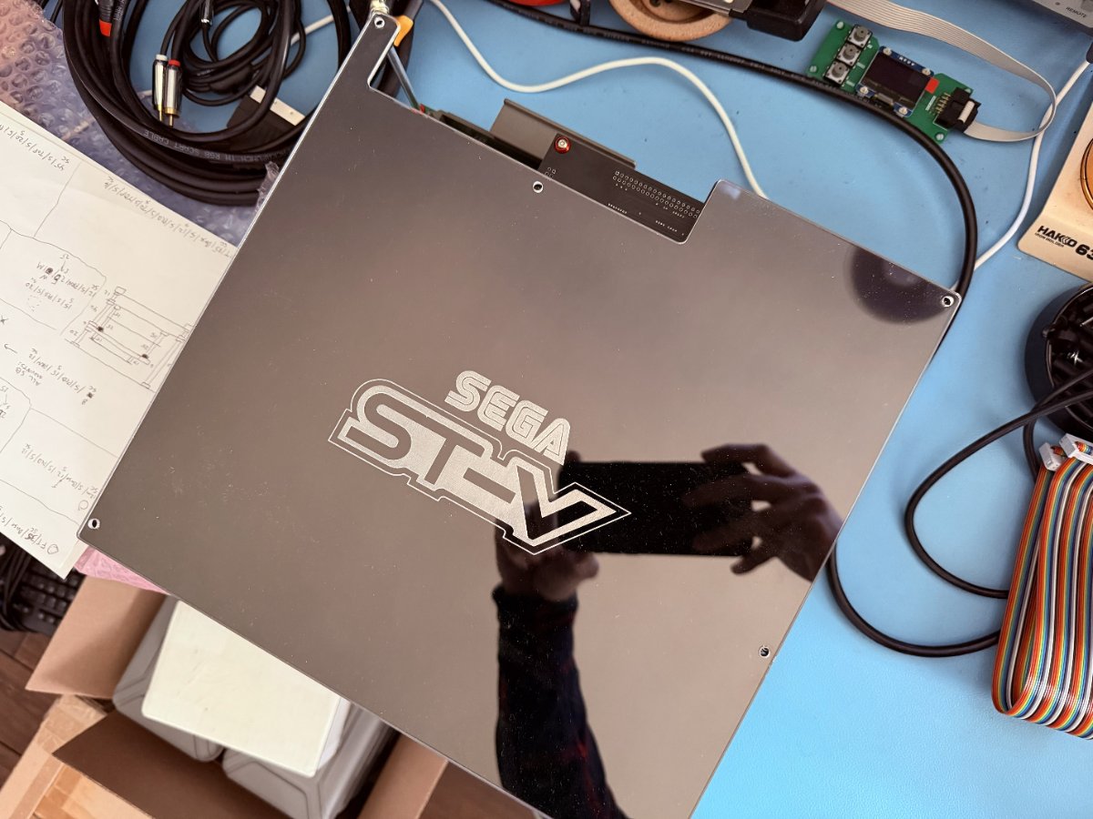

Yes, they are sold out. Hopefully he will restock. I suppose you could use these SVG files in the link below. You’ll just need to make make a few modifications for the LCD and use the top plate as a template for the bottom plate. Shouldn’t be too difficult and I’m sure there’s someone on here that could easily modify and repost the files. Then find a laser cutting service. There’s plenty online.
https://www.thingiverse.com/thing:4658017

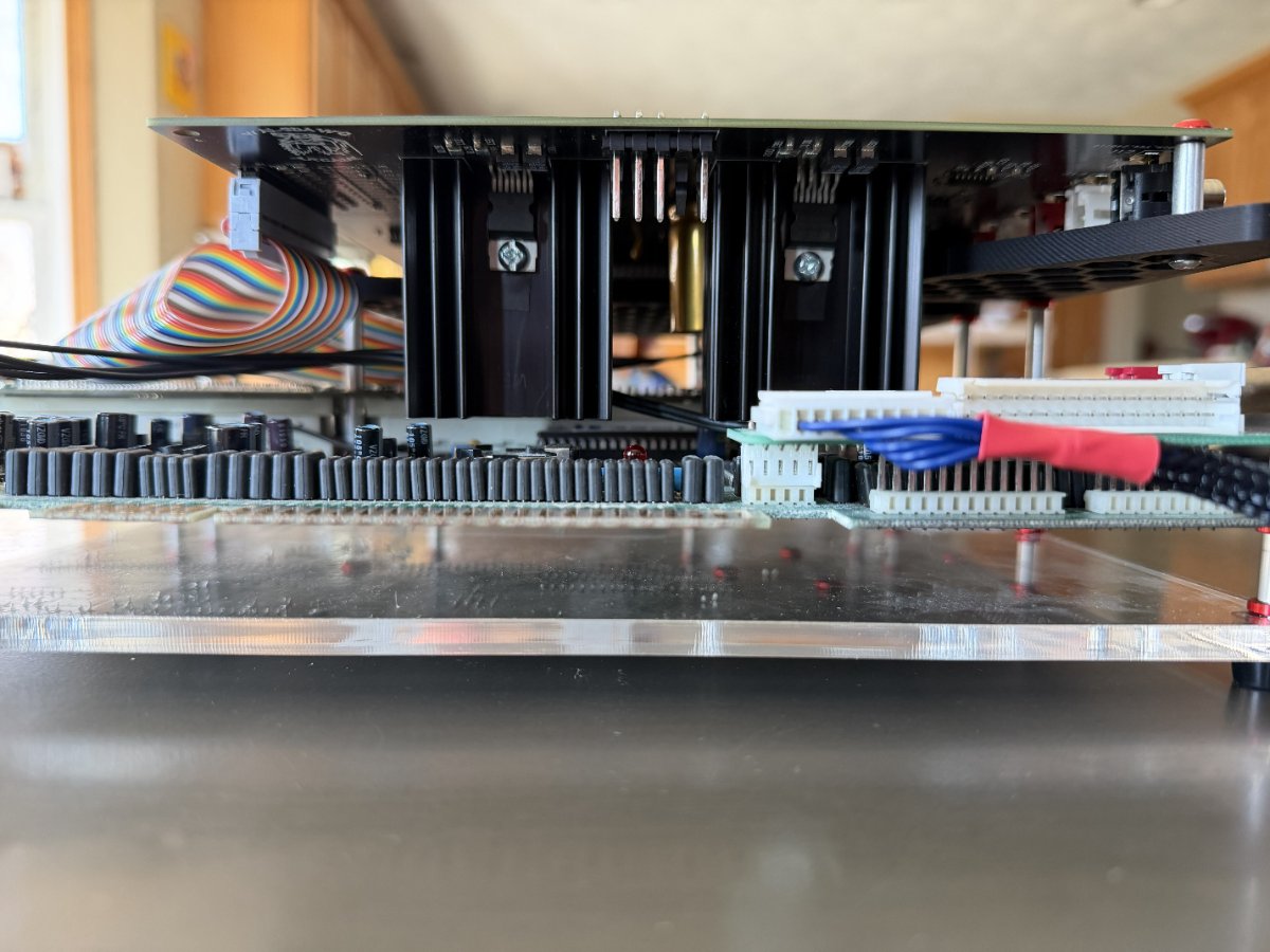

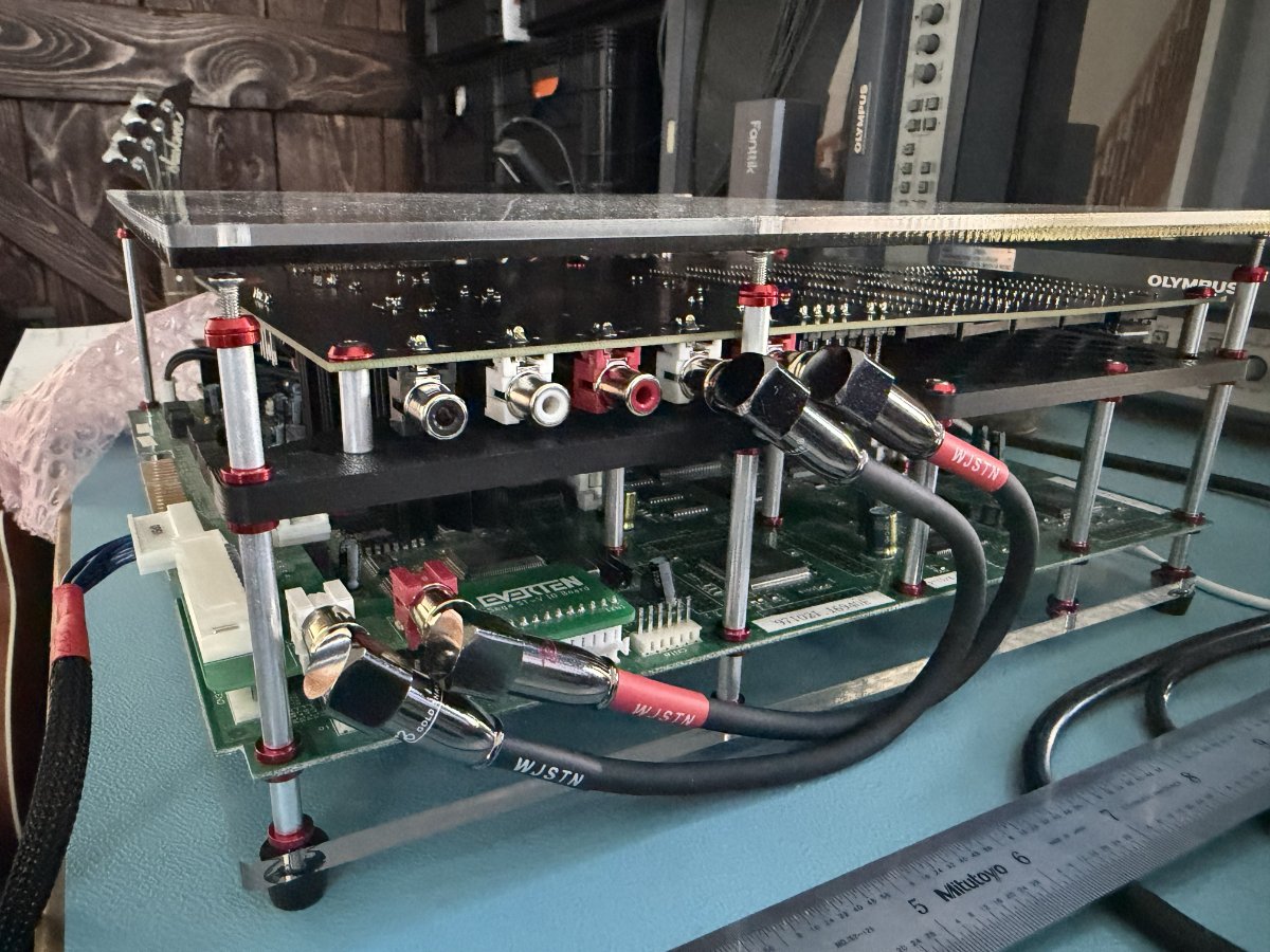

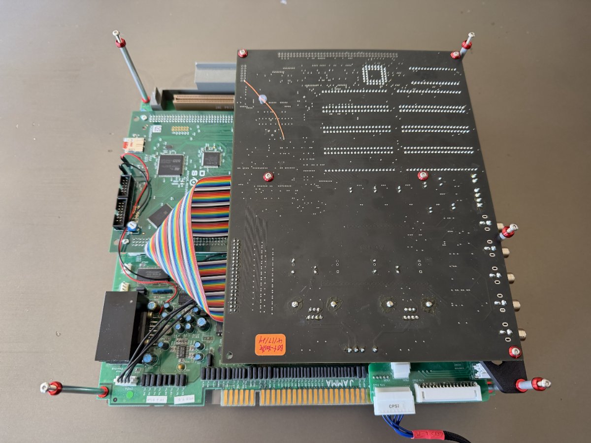

Here's a a preview of what I'll be releasing before long. Right now I'm working on an insert for the cartridge cutout on the Lions3 top cover to mount the OLED selector. I figure this setup will help at least a handful of people that bought this case long ago and later switched to the dark knight multi and picked up the sound board. Really looking forward to that jamma adapter @mathewbeall!

mounting it upside down eh? You could use one of the 12v headers to run a fan through that so that heat doesn't built up there. Of course, I have no idea how hot those heatsinks actually get.

Would be a fan of a fan...could power it off the @mathewbeall board? Fan header?
Optionally if they're actively cooled in home use, you could pry cut the heatsinks in half...or use a different heatsink.
Wouldn't do it if using it as a cabinet amp though or arcade use.
my guess is that these are this big because they are designed to be passively cooled in a hot environment (mostly enclosed arcade cabinet). Probably way over engineered and don't TECHNICALLY need a fan, but hey - keeping things cooler never hurt them.
I bet there's an alternative much smaller heatsink out there with the same footprint a fan would screw onto.
Other options are mounting it nearby.
2 fans on those would be plenty.
Yeah I had to go upside down to fit it in the case, those heatsinks are huge. I’ve been eyeing those 12v fan headers for exactly that. I haven’t figured out where I might mount them though, but there should be some room in the front to run a pair of fans back across the huge heatsinks.
