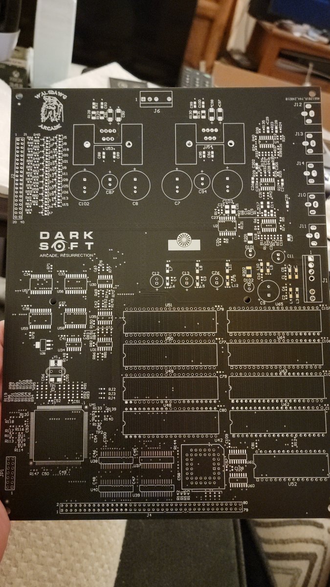

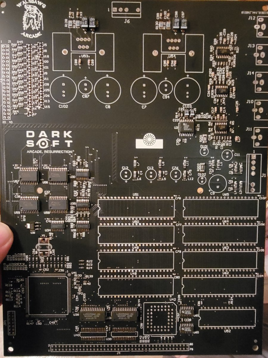

MITSU Wait List: Batman Forever sound pcb repro
I'm not an audio engineer so I'm not quite sure yet the best way to adapt the sound to jamma.

Is anyone working on a solution to power the repro pcb? Probably best to power from the cab psu.
Is it too late to preorder?
And any idea if this + dark knight multi will fit in the lions3D case?
Not a chance the way I see it, unless you extend those standoffs like crazy high and/or make cutouts for the heatsinks, etc...
