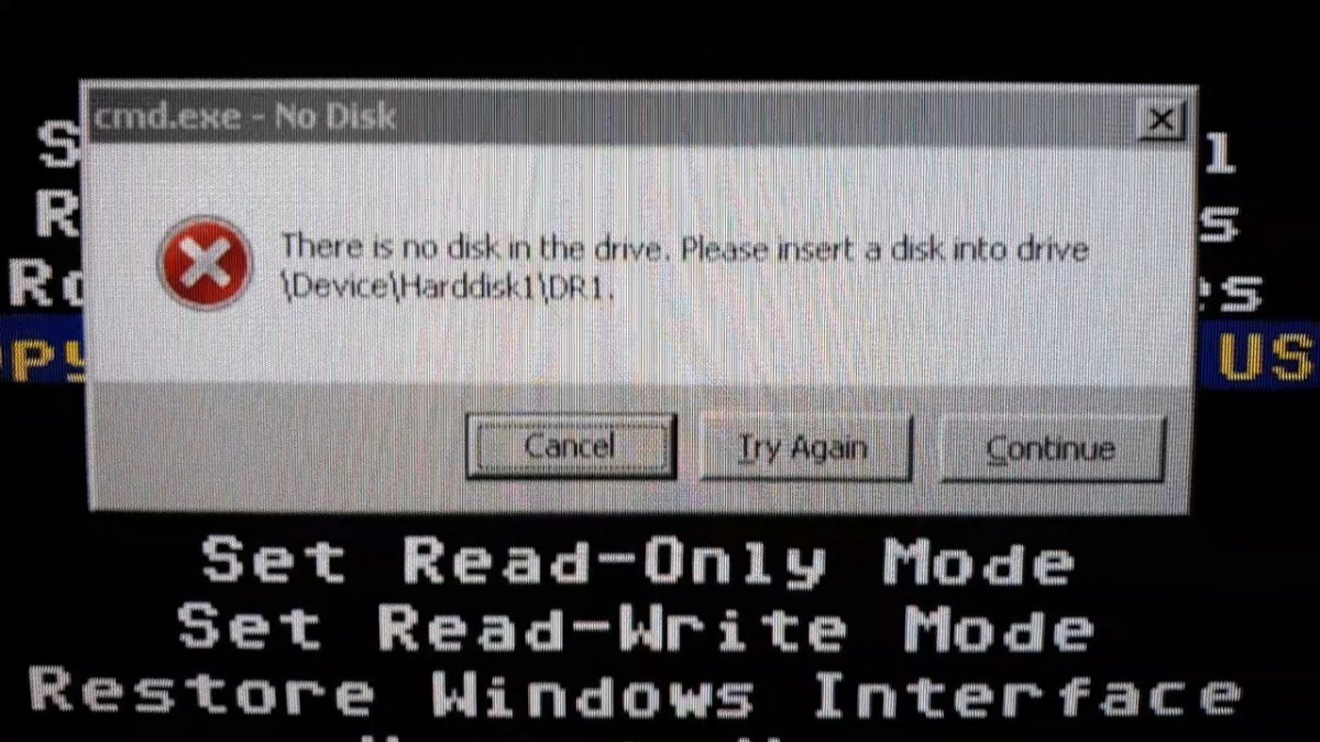

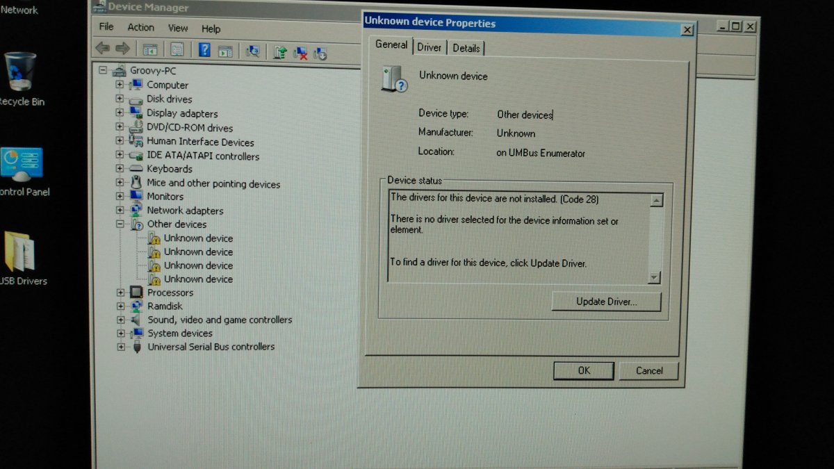

Hello I am having trouble with GroovyTime. My problem is I can't transfer MAME Roms or a updated version of the Mame.exe from my ScanDisk USB 2.0 or 3.0 flash drives when I choose update MAME in the list. When I select update MAME an error comes up saying: "There is no disk in the drive. Please insert a disk into drive \Device\Harddisk1\DR1." I also have four unknown devices in my Device Manager under the "on UMBus Enumerator". My Keyboard is working connected to the computer's USB 2.0 and 3.0 ports. If I reboot back to main Windows 7 my USB flash drives work like they should with no errors. I would appreciate any help anyone can give me.

Go to the control panel and remove the Intel USB 3.0 package, reboot and install the chipset drivers for your specific PC motherboard. That Intel package has caused me a problem with keyboards too
Hi @@chunksin Thanks for responding to my question. I remove the Intel USB 3.0 package and installed the Dell manufacturer supplied Intel USB eXtensible Host Controller drivers for Windows 7. This did not fix my problem. I don't have a problem with my USB keyboard and mouse. I am having issues accessing my USB Flash drive when in the AttractMode Utility Menu. USB flash drive works fine when in Windows 7. Can I update MAME manually by deleting the older MAME folder and replacing it with the newer downloaded MAME version folder and add my zipped game roms to it's MAME folder ? When I say Manually I mean restore Windows 7 interface and going into the GroovyTime D:/ Drive and delete the original MAME folder there and replacing it with the new MAME version.
You can do whatever you want.
I put my ROMs in mame/ROMs.
You can replace the installed mame.
Just make sure the configuration in attract mode is still valid after you make your changes.

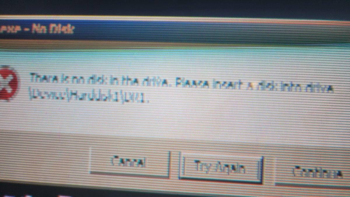

Thanks for the info. Reverting back to windows, I checked the display resolution and it was 640x320 (I might be wrong on the exact number) but the point is it was not 240p. I changed it to 240 and the windows became huge and unusable, but the shakiness stopped. I haven't been able to see if this shakiness is in game because I haven't been able to load a game yet....
I'm having problems with the roms. When trying to load from a USB drive I get a "there is no disk on the drive" error. ( see attached)
I moved a handful of roms over and was able to get a few to show up on the menu, but when loading the game it stays blank and gives an error. Also attached.
Appreciate the help and the hand holding!
