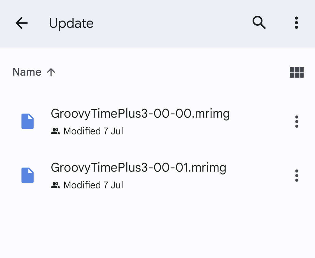

Both halves are in the Google drive folder I linked to, you need both files in that folder as per the previous version.
Yup. grabbed both and swapped out the Plus2 files before install. When I boot up into the Macrium restore area, I can find the 00 image just fine and it lets me know that 00 is only part of the image. When I search for 01, I can click on it but it tells me "unable to locate image." I don't actually get the option to restore anything because the 01 portion of that image will not be read.
