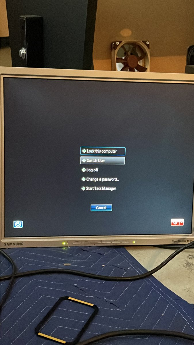

And disaster struck , the system then booted to a different attract this time, that was unpopulated with any settings, and the “u” key did nothing.
At this point I was locked in there exactly like the problem @Paul and @PASTBLASTER experienced.
U menu doesn’t function, ctrl alt delete takes me to the black bare task manager etc, where before reading a few posts above about a solution to that I got stuck!
To the point I had to pull the graphics card, and reconnect to the LCD via onboard graphics, plug in original win10 ssd, boot back in uefi and wipe everything and start again. I’m back now at the point of everything working as per the first picture, but I haven’t shelled attract.exe as I get stuck in the bare attract frontend again.
So I suppose my question here is,
-what have I done wrong here, where shelling attract.exe causes this?
-And what is the reason why , if I don’t shell attract.exe at all. I seem to get a working setup here.

Incidentally I did resolve the Attract mode/ black screen by loading into explorer and then shutting down which just re-boots back into attract.
