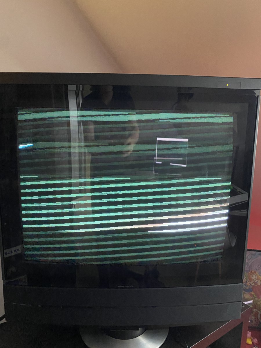

Hi Chuncksin, first off thanks for making this image, i have an issue however. I am using a HD7750 card which is already ATOM 15 flashed so i could do all the steps nicely on my 15khz screen up until where i install the driver with option 3 for GCN card, it installs the driver successfully but upon reboot i get a scrambled image. i am using the arcadeforge umsa vga to scart , on the HD7750 i an connected to the DVI via a standard DVI to VGA adapter which then goes to the arcadeforge converter. It looks like the image does not sync . I can hear the windows chime sound so i believe the desktop is there but the TV stopped syncing after the emudriver install and reboot.
PS: i use the version 2.7 of groovytime, but i also had to download your version 3 files GroovyTimePlus3-00-00.mrimg as i had no usb response from keybaord and mouse with the 2.7 image mrimg files.
Try plugging it back into an LCD at that point, you might find you have a high resolution desktop until you apply the EDID emulation after setting modelines in vmmaker
