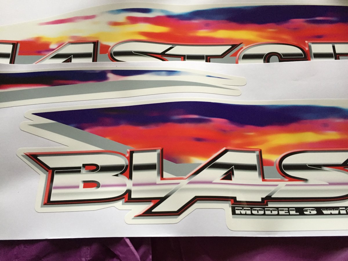

Arcade Art Shop. And I requested some changes to the colors. Out of the 5 people I'm aware of who sell these stickers, alberto1225's look the most accurate. I think he's too busy these days to print them, however. Arcade Art Shop has some other items I want so that's why I ordered from there. I could have attempted to revise the files from arcade otaku wiki and try getting them printed somewhere locally but it's much easier to order from someone. Also, eventually my Blast will be sitting between my other two cabinets and depending on how much space I have, the stickers might not be visible. So I shouldn't be too picky about the colors. I definitely don't want to keep the originals on there. Those look really bad.
New stickers (decals?) arrived and are on the cabinet. No more looking at these scratched, yellow things.
Peeling off the old ones was easy with a little heat applied, but not too much heat because the adhesive separates from the vinyl and leaves a mess on the cabinet.
As I wrote previously, the stickers were ordered from Arcade Art Shop and I requested a few changes to the colors. Most importantly, a change to the blue areas to be more purple. The changes were implemented and the new sticker design is now fairly close to the originals. The only part left that I would change is the grey shadows; I would make them lighter with a blue tint. There are other differences in the colors and shape but those are also in the Arcade Otaku wiki file (which I assume is the source) and these differences aren't too critical in my opinion. Overall I think the stickers look good. The vinyl and print quality are both excellent.

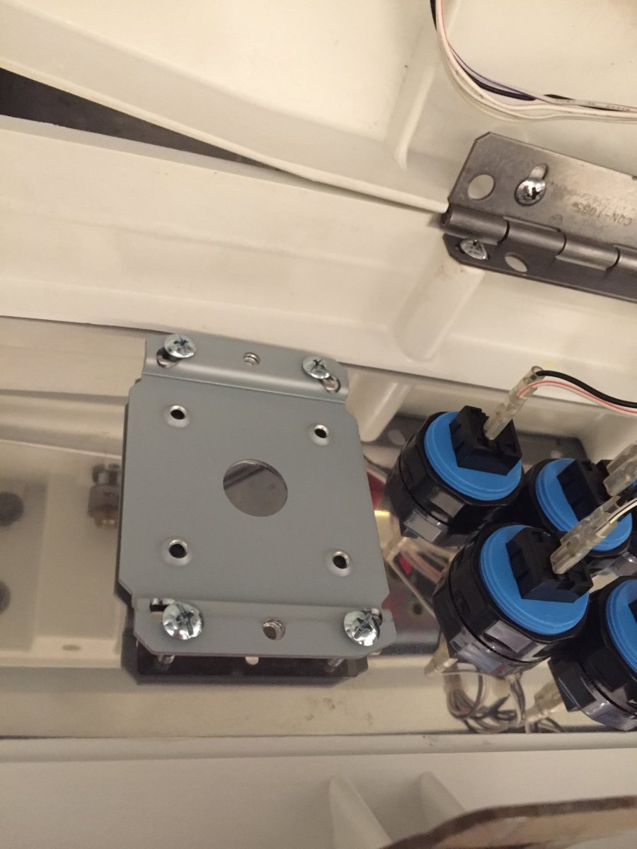

Here's some more information on mounting plates that everyone except for me probably knows already:
In an earlier post I wrote about needing a Kowal plate converter to mount a Seimitsu LS-56 to an alberto1225 panel. This isn't correct. Seimitsu makes other plates and the plate I needed was the SS P-40. This plate costs only a few dollars whereas the Kowal costs $11 and isn't as widely available. However, the SS P-40 isn't flat and places the lever 5mm higher above the control panel, which may or may not be desirable.
For now I will keep using the Kowal plate because that's what I am used to. The 5mm difference with the SS P-40 is noticeable. It places the ball top higher in my hand. I may switch back to it later and use it for a few weeks to see if I like it better.

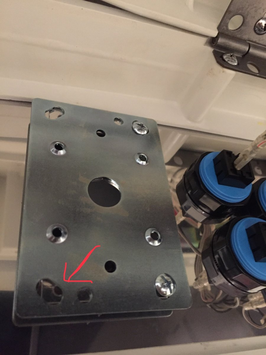

There is also the Seimitsu SE P-40 which is also compatible with the LS-56. It is a flat plate and, based on the dimensions, looks like it might fit an alberto1225 panel but it doesn't. I suppose I could use a file to enlarge the holes if I really wanted to use this plate. If I didn't already have the Kowal plate I probably would.
The SS P-40 and SE P-40 also fit the LS-55 lever. The plate that seems to be the standard plate sold with both the LS-55 and LS-56 is the MS P-40 and this plate does not fit alberto1225 panels.
