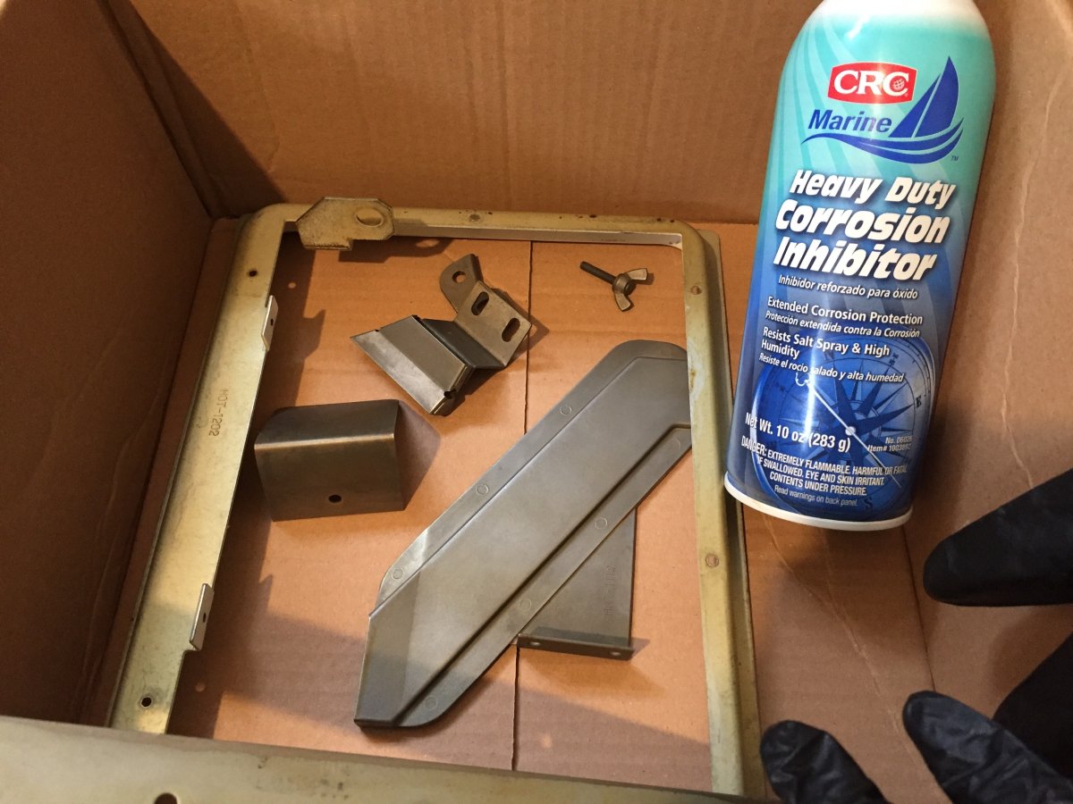

For the rust, and there was a lot, I soaked the metal pieces in vinegar for a few days:
I've learned that soaking in vinegar and then rinsing isn't enough. To prevent "flash rust", something I'd never heard of until recently, I should have rinsed the parts in baking soda to neutralize the vinegar, then rinsed in hot water, then dried immediately. I didn't do this step but I did do the next step below which is much more important.
After removing the rust I sprayed everything with either CRC Heavy Duty Corrosion Inhibitor or CRC 3-36:
The Heavy Duty Inhibitor has a strong smell that lingers for weeks and it stays a little bit tacky. It also gives the metal an amber color. Other than that I think it will work well. The 3-36 I'm not too sure about. I saw a video where someone tested it outside and the results were good so I guess I don't need to worry.
